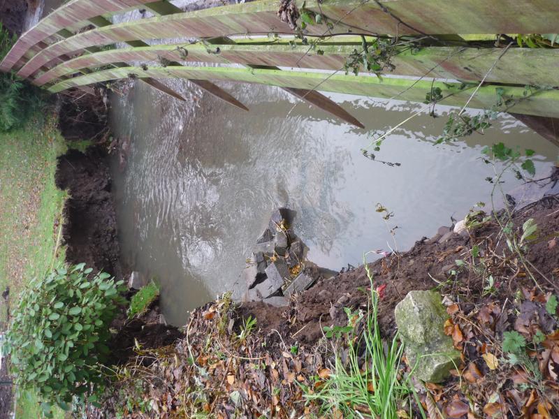

Thanks for all your thoughts gentlemen,didn't realise I'd stir up some disagreements, but everyone has the right to an opinion. Not sure now about whether I've picked the right man but he can start in two days and with ever more rain on the horizon my garden is disppearing before my eyes! I would add a picture if I knew how!

Hope you will keep us posted with some more pics as work progresses.

hes going to struggle getting that done in the ground conditions at present, even when the water has subsided, how the hell is he going to do the foundations with the water table so high?
another option would be to use oak sleepers piled into the ground, may well work out cheaper in both materials and labour, and they will cope better with that sort of river level over a longer period.
you are definetly going to need a proper land drainage system behind the wall.
That's easy. :wink:
But I can't wait to see how her builder goes about it. :D
As above i`d personally go with the railway sleepers rather than the wall. Its going to be difficult to construct in brick/block at present, without tempoary diversion of the stream around the works and if you are doing that you might as well go with the railway sleepers.
Norcon, i`d guess you'd set your front face of formwork to keep the water at bay and dry out whats behind. Either way i`d rather watch than do any of that.
If i was doing this cast in situ i`d want drain holes with granular materiual to stop water pressure building up (or a perforated pipe installed, discharged outside of the wall section), i`d also want it L shaped.
For 6.5k i`d not want to be doing it again. But if it were me i'd be driving some steel deep into the stream bed on your boundary line, and setting sleepers behind it.
