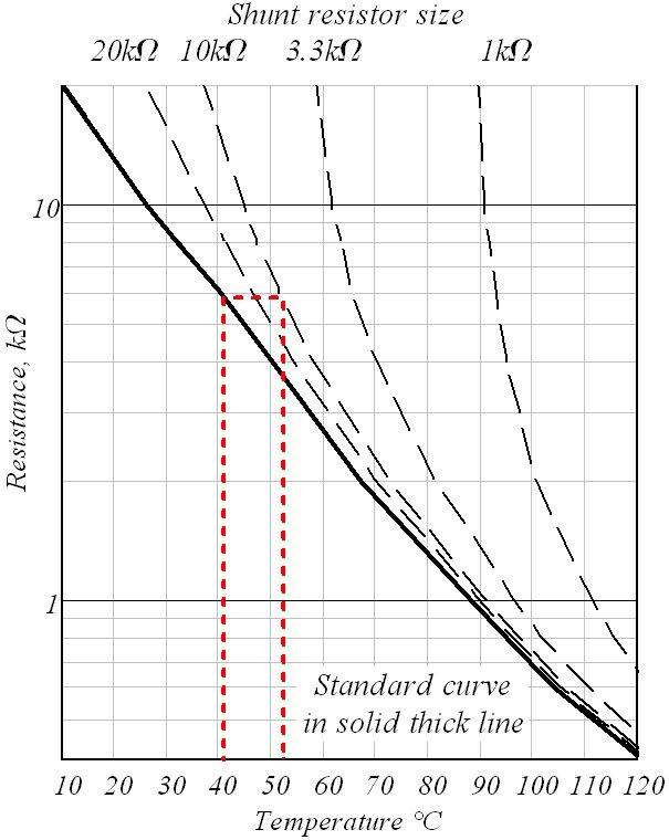

Well, I dared - and the results look fine. I put a 10kΩ shunt across the return temperature sensor. This raises the apparent temperature (seen by the boiler) and allows it to continue burning from the start rather than cycling. My calculations showed that the boiler would think the return was 52C when it was actually 41C. I predicted that the return would reach 72C before the boiler levels off. My measurements have verified this. The boiler was reaching about 60C after nearly 2 hours and staying there. Now it reaches 72C after about 28 minutes and stays there. Here are the results for CH and room stat in the hallway at max:
Turning the room stat to a sensible value of about 17C, the boiler levels off at around 62C.
I was originally just going to try a resistor in place of the sensor as a diagnostic, but I realised one could be selected to work in conjunction with the sensor as an eventual solution. The sensor's characteristics from the manual together with the modified curves are here:
To get the temperature the boiler sees from the actual temperature, say 41C, read up to the solid curve, move across to the resistor curve (10kΩ) and read down to 52C. This is quite a difference at low temperatures, but do the same at 70C and the actual is 75C.
My boiler is getting serviced tomorrow, so I will run this by him. I will also contact Viessmann support again to see what comment they have. I am of the opinion that a low return temperature shortly after startup could be due to a restriction or due to long pipework (or a combination) - and the boiler cannot distinguish the two. It only knows temperatures - not flow rates. What I have done only tackles long pipework.

Basically, I follow this link. I use an old laser thermometer that I bought for reflowing solder on circuit boards. It is not suitable for pipework so I cannot measure flow and return temperatures at the boiler. A new one is on order for that. Because my system has long pipework, the lockshields need to be set anywhere between 3/4 turn and 4 turns (i.e. fully) open. That probably indicates quite a lopsided system. What do you think from your experience? Incidentally, have you often encountered domestic systems with the furthest rad 18m from the boiler?

Of course! I have multimeters, but resistance measurements mean little unless related to a temperature that can be compared with the sensors quoted characteristics.

Practically, RGIs measure sensors at room temperature because that what the appliance is usually at if not been working for a while.
So that's at 20 C at which a nominal 10k thermistor is about 13k.
There are only two common faults, O/C and becoming O/C when it gets hot.
They virtually never don't follow their resistance curve.
