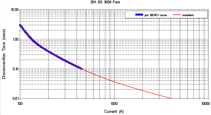

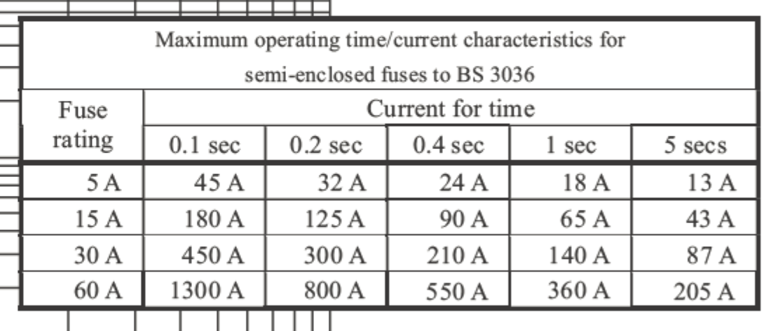

As I said last night, the problem I had was in trying to ascertain the appropriate value of I²t for a 30A BS3036 fuse to use for an adiabatic calculation. The best I can currently do is to look at the 'bottom end' of the characteristic curve for a 30A BS3036 in the Appendix of BS7671. That indicates a disconnection time of 0.1 sec at a current of about 430A.
That equates to an I²t of 18,490 A²sec.

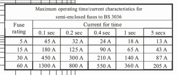

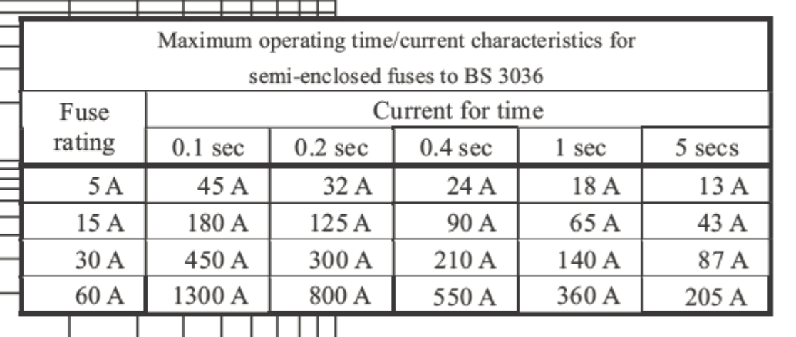

<paste from Fig 3A2(a) of BS7671>
Yes, I saw that table which suggested 450A for 0.1sec disconnection time with a 30A BS 3036, but I decided to go with the graph instead - not easy with the log scale, but clearly a bit lower than 450A, which is why I estimated ~430A.
So, you can pay your money and take your choice. My 430A gives an I²t of 18,490 A².sec, which leads to a minimum CPC CSA of ~1.18 mm², whereas your (the table's) 450A equates to an I²t of 20,250 A².sec, hence a minimum CPC CSA of about 1.237 mm - still obviously well over 1.0 mm², (and, for what it's worth, close to my suggested 'obvious' figure of 1.25 mm² :) ).

That's why, as I said, one needs to know the I²t at the actual PFC of the circuit - and neither the graphs nor the table in BS7671 go below 0.1 sec (hence above a PFC of 430/450 A, as above). If, as you have postulated, disconnection time remains as 0.1 sec when PFC rises above 430A (or 450A!), there's not actually any need to consider the actual value of I²t in the way you have done, since the calculation then simply reduces to:
minimum CSA = ( PFC x √0.1 ) / 115 = PFC / 364 (roughly!)
... hence, if PFC were above 546A and disconnection time was still only 0.1 sec (per your example), even a 1.5 mm² CPC would be inadequate! However, unlike the situation with an MCB, with a fuse I imagine that the disconnection time continues reducing for a fair bit beyond/below the bottom of the displayed curve (0.1 sec).
However, as I said, to actually get a proper answer, one needs to know the actual I²t at the PFC concerned.
Kind Regards, John
One can apply the Mk.1 eyeball curve extrapolator.
Might work better on a piece of paper without the fuse rating legend, but on a screen one can get some kind of idea.
One can apply the Mk.1 eyeball curve extrapolator. Might work better on a piece of paper without the fuse rating legend, but on a screen one can get some kind of idea.
Sure, but one doesn't have to rely on eyeballs to do the extrapolation - once one has managed to read a few points reasonably accurately off the curve, it can easily be mathematically modelled (in fact, the log-log curve is almost straight from about 150A onwards). However, what we obviously don't know whether the actual behaviour of the fuse beyond what is shown on the curve (i.e. above about 450A) is anything like what we would expect by extrapolation (whether 'by eyeball' or by mathematically modelling) ...
Kind Regards, John

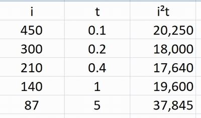

What if a 3036 never gets any faster as the current increases?
Unless you are assuming an arc which fails to clear (which 3ka could result in... IIRC the breaking capacity of most 3036 is 2kA, it can be 1, 2, 4 but I'm breatty sure type s4a is only appicable for ratings over 60A anyway)
then its not generally possible as I²t is related to the let through energy, and to the energy to vapourise a fuse element will be more or less a cosnstant. So i'd expect it gets closer and closer to a specific value of I²t the faster it happens, and infact for BS88 fuses at least, you can look up the manufacturers total I²t when you are looking at clearance times faster than 0.1sec. There is also a pre-arcing I²t if you need to ensure discrimination. (The total I²t of the smaller fuse must be below the pre-arcing I²t of the bigger one)
Its breakers that can exhibit the 'can't go any faster' problem, no quite so much of a problem for modern types of energy limiting class three, but you'll still get a chart from the manufacturer showing a different I²t value depending on fault level (or use the generic ones from BSEN 60898), but early ones did indeed have I²t increasing with the sqaure of the fault level. The 2.5mm/1mm can still be a problem on C curve breakers, especially if teh PEFC is high
