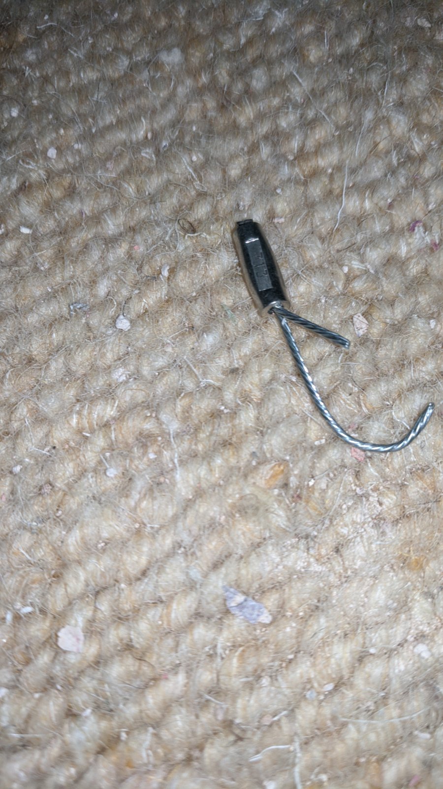

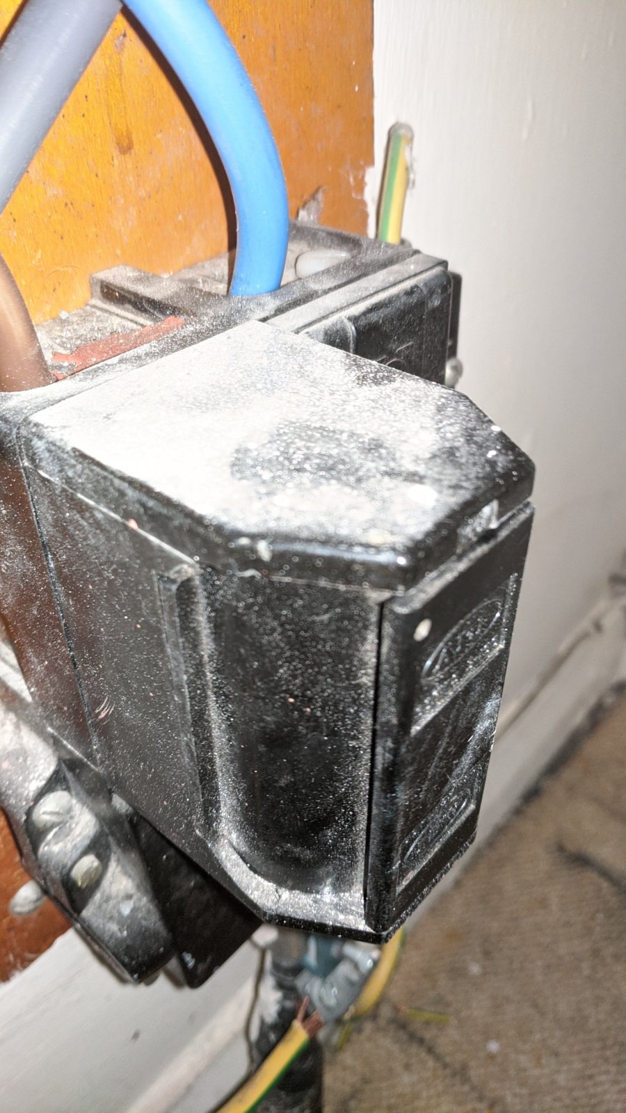

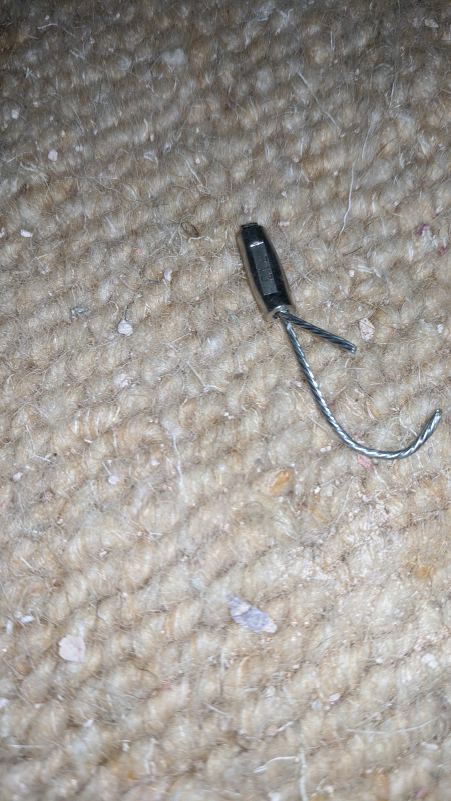

I've just noticed the fuse seal on the floor with the crimp number that matches the ones on the meter. We had the previous owners prepayment meter taken out and a credit meter putting in last Tuesday.
Shouldn't the electrician be replacing that seal on the fuse?

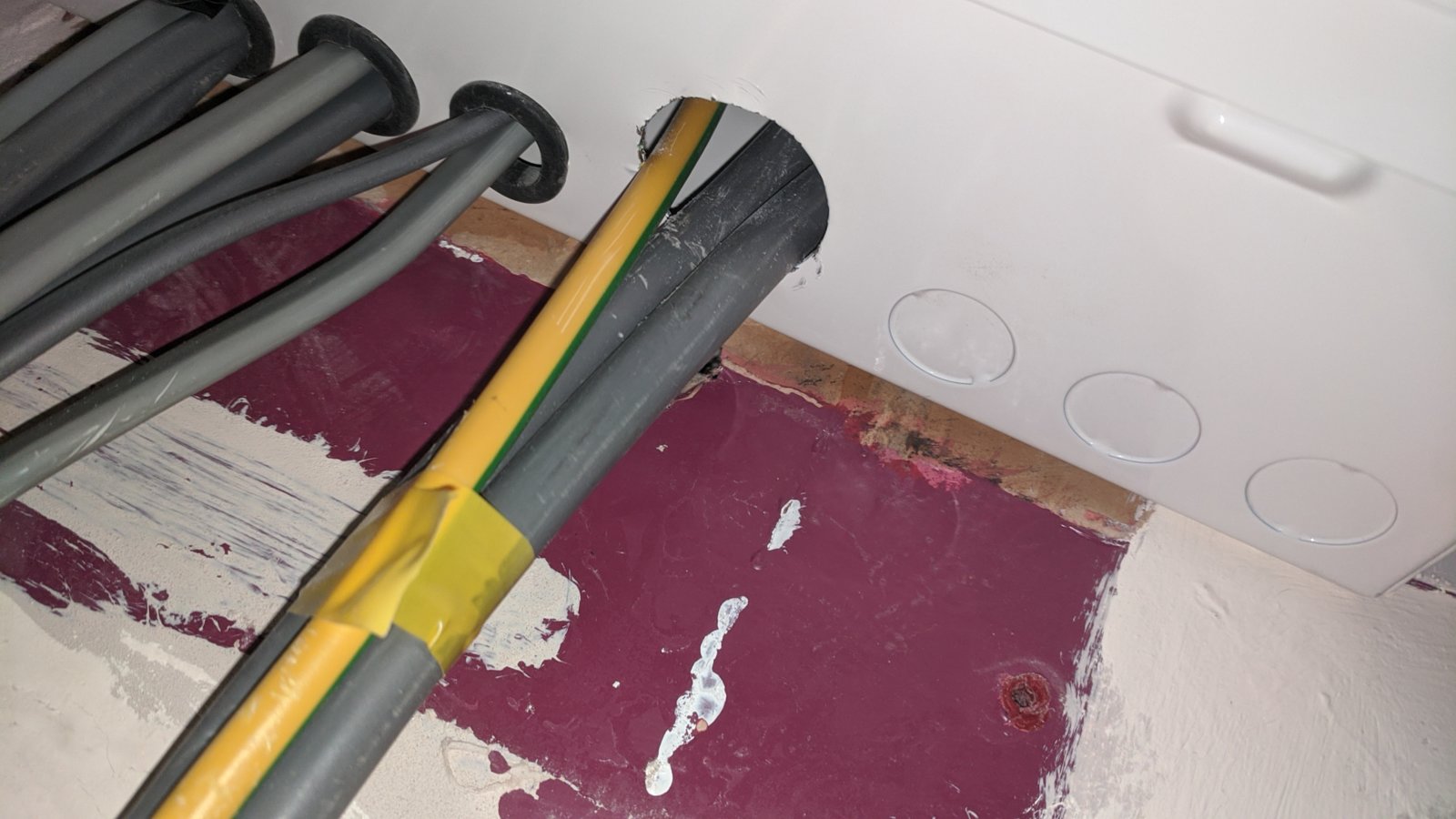

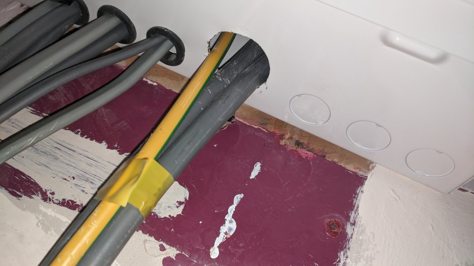

Here's a closer image of the tails going into the fuse box (it's just bare metal without a grommet), along with images of the fuse and the seal.

Another electrician has picked up a potential safety issue with the CU which is the tails from the meter going into the CU through a hole in the metal that is rough and doesn't have a grommet so in time, it could saw through the cable. There's also concern that the weight of the cables going into the CU could be pulling them down and out of it as there's nothing supporting them."

Even if that is true (and it may well not to be), that doesn't sound like any sort of acceptable 'supervising' - and if the 'supervisor' was happy with the work that had been done, I seriously doubt that he should be a "QS" in the first place!
