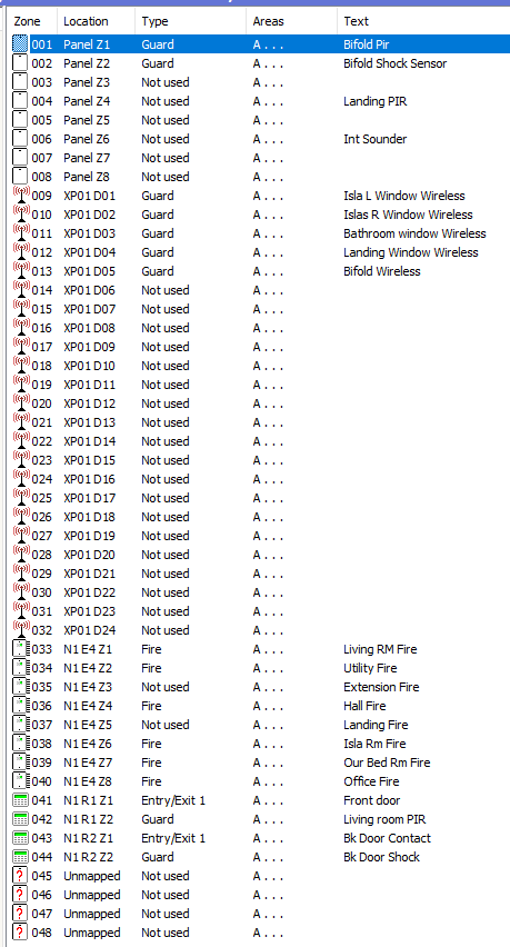

Have a premiere elite 48, firmware is latest , i have a wireless Expander (W 32) , and a wired expander ,
all has been working as required, i am now however struggling to add a 5th Wireless device.. when i go to the Ricochet learn. it says all devices learned..
and my wintex screen only shows 4 richochet devices for that expander,,

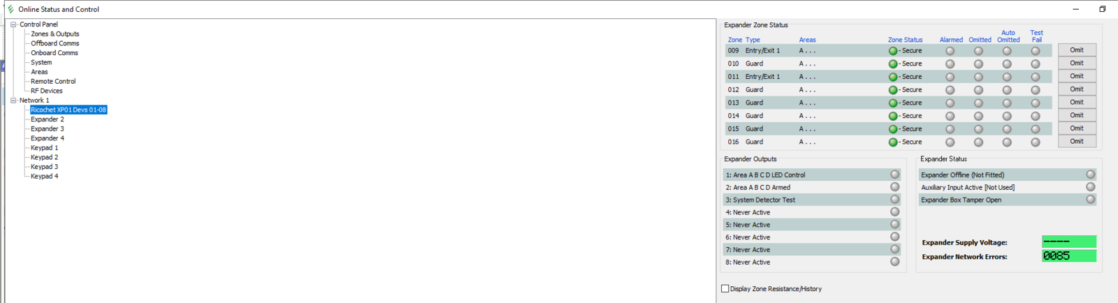

i have looked in Diagnostics and found that my 4 zones from 2 Keypads are shown under the 32 w zones 9, 10,11 and 12
all labeled devices are used , some i have taken off line as im renovating the landing at present,

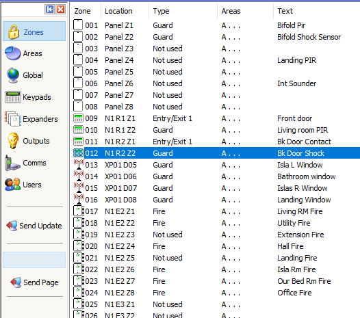

Cheers Sparky, worked a treat, given me 8 zones now,, but why is there only 8 may i ask.. i assumed there would be more than 8
because your hard wired expander is address 2.
there is a conflict, just like the mapped keypad zones.
On a 48 map keypad zones to 41 to 48 (as these are not used by the expanders).
Address hard wired expander to address 4
This should give you 24 wireless zones
it does mean some moving around of things but shouldn't be too hard.
Thanks, done as above, looking much better, currently commissioning..
