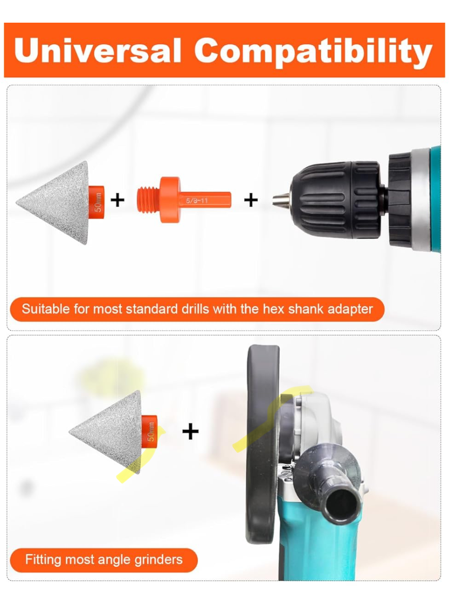

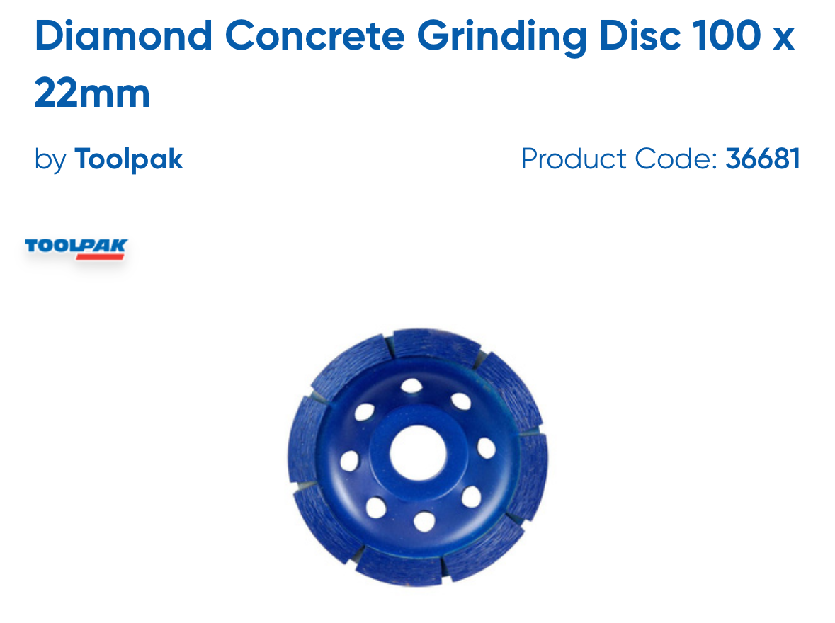

Genuinely, a grinder with one of these fitted:
will make mincemeat of stuck on mortar lumps in seconds. Also a diamond cutting wheel will quickly clean up the ridge tile without risking breaking it. Dont use a hammer for any of this cleanup
On the grinder note, buy a battery one; all round better than a 240v one for most jobs (less aggressive), and will possibly end up being one of your most useful purchases. If you already have a cordless drill (if not why not) buying a body from the same brand so you can use your existing battery is usually incredibly cheap.
If you have a cordless drill and don't wish to lay out on a grinder, for this task you could consider an adapter boss that will allow you fit a grinding wheel to the drill(like eBay item number 317562734958) but take care to use a low speed, both hands and only grind such that it's trying to pull away from you if it suddenly grabs and jumps.
Specialist drill bits also exist, such as:
But for the cost of them you can nearly buy an angle grinder body, and I personally feel that for this job a grinder would be safest all round
