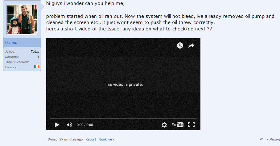

hi guys i wonder can you help me,
problem started when oil ran out. Now the system will not bleed, ive already removed oil pump and cleaned the screen etc , it just wont seem to push the oil threw correctly.
heres a short video of the Issue. any ideas on what to check/do next ??

fixed video guys tank is above burner is located outdoors ground level in a small brick housing with felt roof.
also can make another video if directed,

Just managed to see the video......
Got to be right there, Terry - doesn't sound like anything is spinning at all. Fuel dripping too? :eek:
