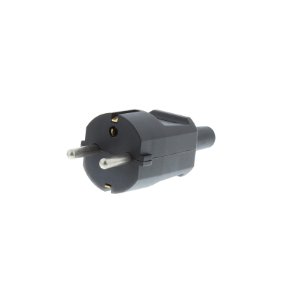

will be cheaper (assuming the current sky box takes this) https://cpc.farnell.com/pro-elec/pe...PING&s_kwcid=AL!5616!3!224648252532!!!network}!426919221793!&gclid=CjwKCAiAvOeQBhBkEiwAxutUVJNOAJcdVBD9RDnz1uq4m9KrPXtpS5-TmYP9X0H1K_lBYgVgtrxBZxoCmi8QAvD_BwE
Ebay may be cheaper.

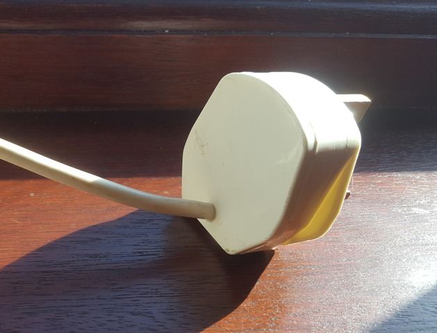

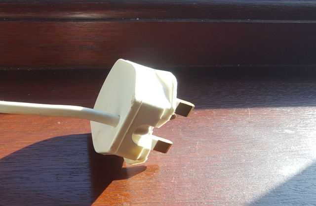

If it was me i would do this if I COULDNT resite or replace the socket
View attachment 262377 View attachment 262378
OK maybe not 100% legal I have control of its use and am aware to not pull on the cable to remove the plug
So, you have "amended" a Plug conforming to BS1363 to have a "rear entry" position for the "cord" - something available for the "standard" plug in most other countries but not (so far) provided by manufactures in the UK!
There does appear to be a (small) opening for such a product - with an appropriate "strain relief" included.
A cable tie behind it (if it fits) would suffice.
