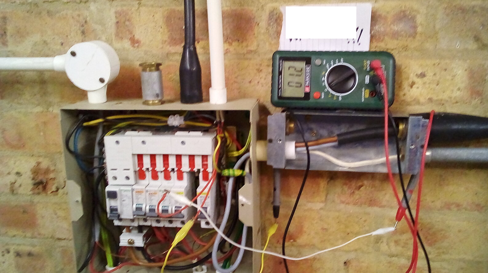

I've come across a number of lighting rings, especially commercial and I've installed 4mm² 16A rings in a tunnel purely to get Zs down. it was a right royal PITA getting 2 4mm² into the Fluo fittings as we had to fit an extra 30A choc bloc and a smaller link to the original connectors. We wanted to replace the original but the quality controller wouldn't accept modified fittings.
The last domestic lighting ring circuit I found was this one:
In this thread: https://www.diynot.com/diy/threads/a-real-moan-tonight.552183/
