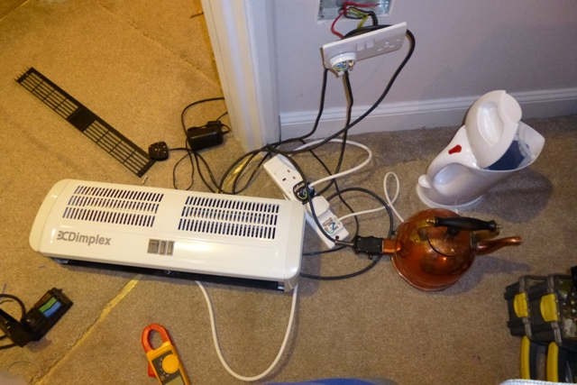

thanks for the experiment fred.
Some photo's of the setup would have been nice to fully understand what is getting hot
I will take some photos. My real name is Matt btw! I don't know why I used freddo when I signed up here all those years ago. I'm also known as Echo who is that fluffy dude in my avi.
OK here are some photos I tried to match them to the thermal pics.
The loads.

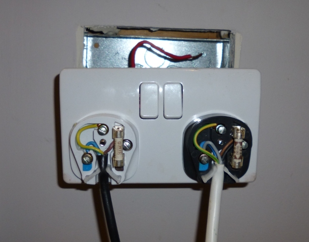

The 2 Plugs at the end of the test, shown with their lids removed.

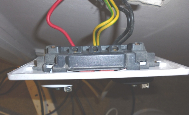

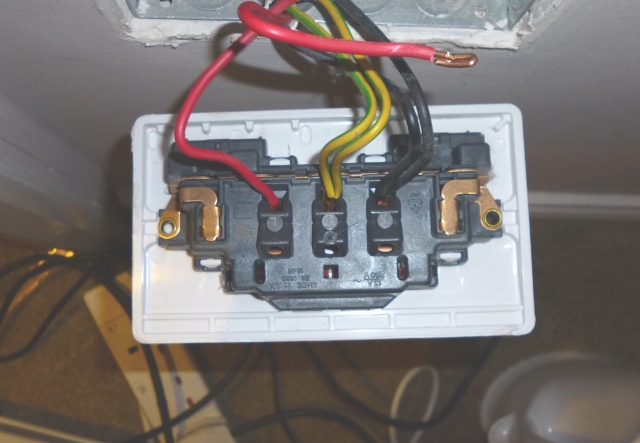

Rear of socket.
Top rear of socket.

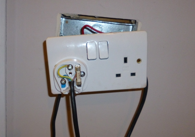

20A through 13A fuse. The flex was draped around the socket to keep it from melting the carpet!
