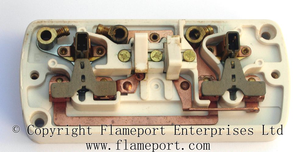

Ah. You can see on this old socket that the current path does not, as I would have though, split and go to each socket but one part (L and N) would indeed carry the 26A.

Those bits of copper appear chunkier than the copper and brass parts of the MK Logic Plus socket I've just dismantled.
