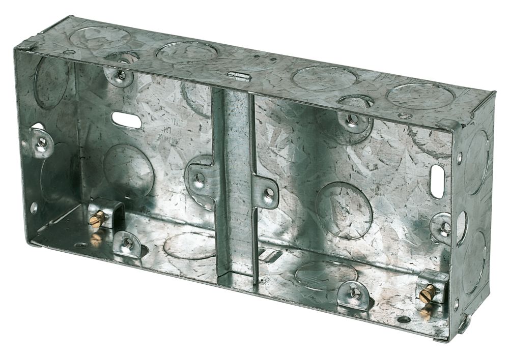

As it's just a stud wall, perhaps you could replace the cable with 4mm² cable and fit two single sockets.
This would involve fitting a larger back box - a dual , though.
ae235
Yeah, I thought about that. It would break the ring final rules though (two sockets). (May be the best of a bad job though). To do it within the rules you would need to pull two 2.5mm cable through. And it sounds like the cable passes through two studs so unless the holes are known to be big...

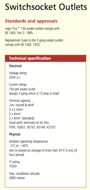

A BS 1363 double socket outlet is rated for 20A. This is verified by testing one side with a slight overload (14A) and the other with 6A for perhaps an hour.
No BS 1363 double socket is rated above 20A - the Standard requires 20A rating and they must not be used to supply more than this.
You might wanna have a word with MK technical then

While it's true that once you have a double 13A socket in place there's nothing to stop anyone from plugging two 3kW loads into it, in most locations that's unlikely to happen. To install one with the intent of using it for two such loads is, in my opinion, poor practice given the manufacturers' ratings (and possibly the spur cable rating, depending upon installation method), especially given the duration of the loads. A dryer could well be running for an hour and half or more (even 3 hours or more with little break if somebody is doing a couple of large loads), and while the washer uses that power only during the heating cycle, it's not unusual to find a washer plumbed for cold fill only, for which on some settings (near boiling, higher water level) the heating element could be running for half to three-quarters of an hour.

As to 13A double sockets I have seen where they are rated 13A each and also 13A for the pair the latter normally where the socket has filters or built in RCD. Point is there is no one ratting fits all.

So what do you say about the fact that some sockets are made to cope with >20A?
What do you say about the fact that BS 1363 does not mandate a maximum current carrying ability?
What do you say about the fact that you seem unable to understand the idea that when a standard says "the {whatever} must be able to cope with a {whichever} of a {howmuch} magnitude" that that does not mean that the {whatever} must not be made able to cope with more?
Please show us where the standard says that.
Or fail to do so and accept that you are wrong.
