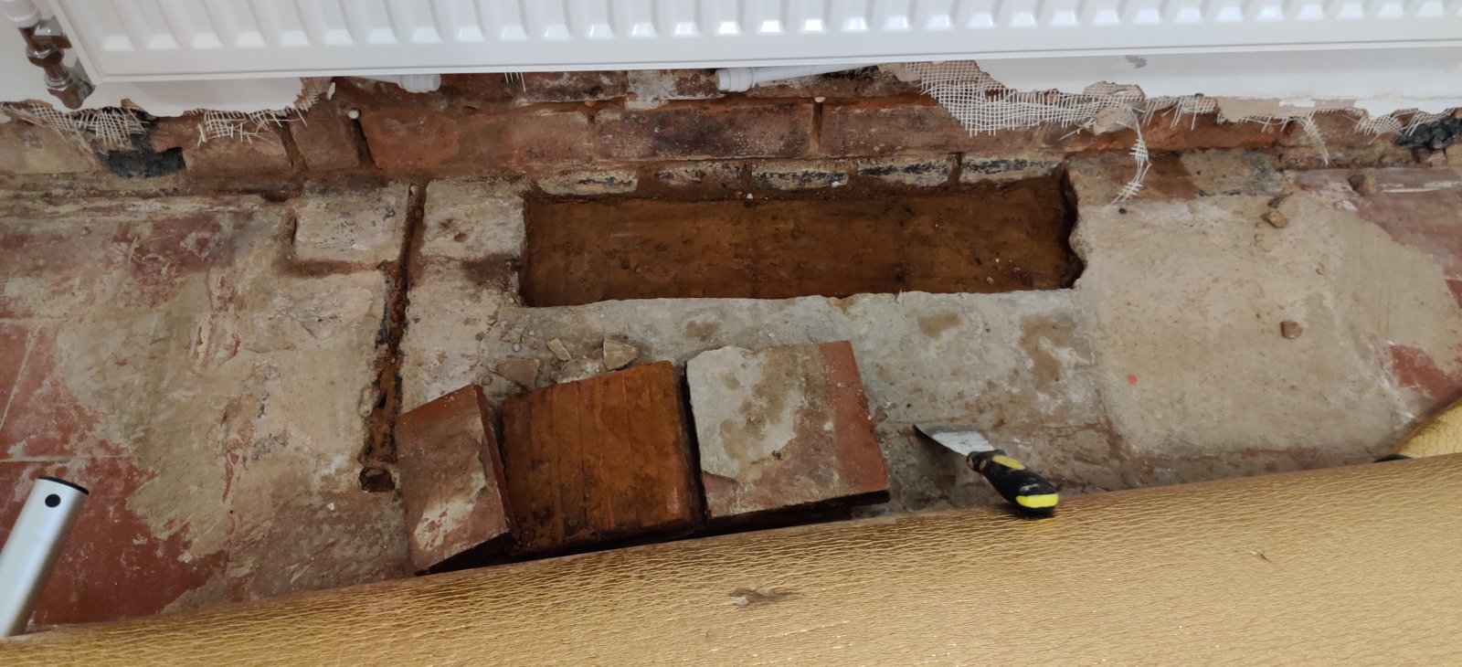

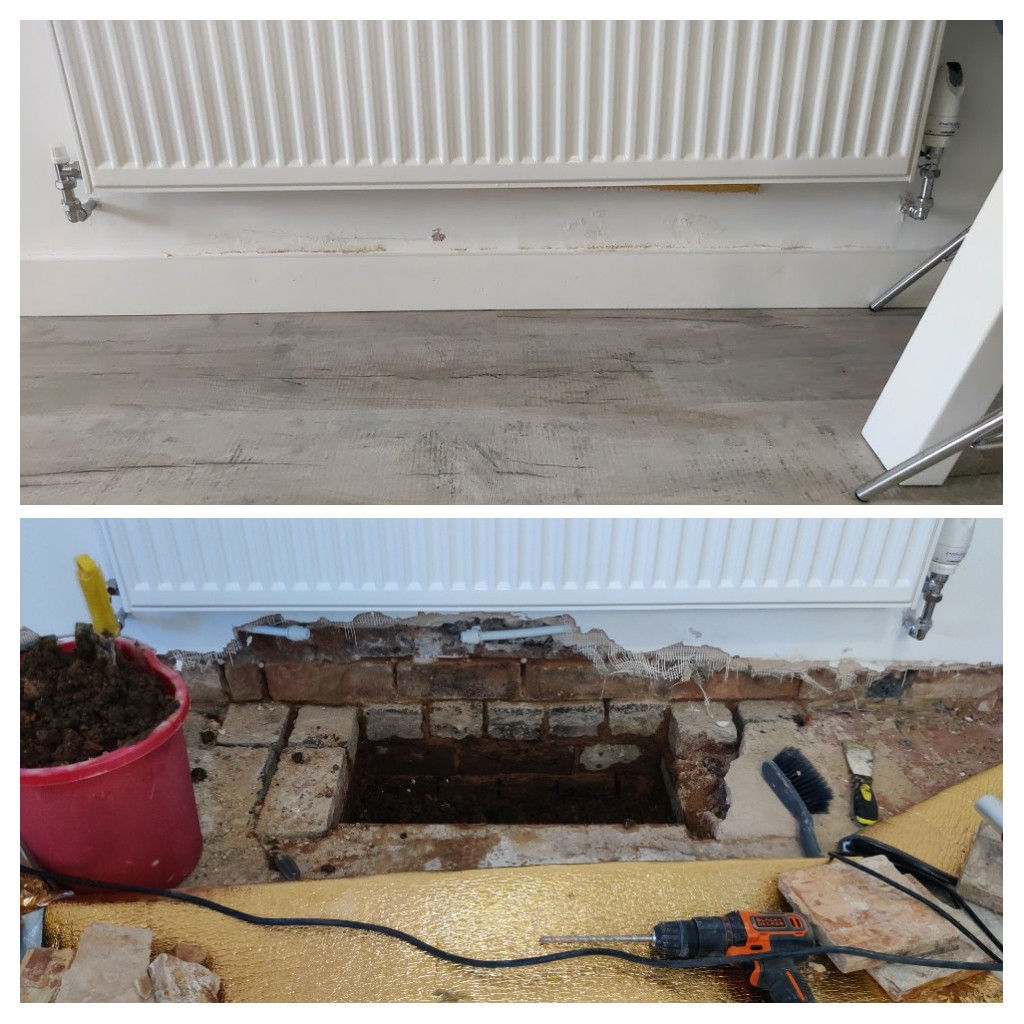

Did you resolve the problem? I'm facing a similar one, though the fireplace is removed, damp started raising.

NeoL,
you are not "facing a similar one" - far from it.
do you expect to get better advice from a "dead" four year old thread rather than one from 60 mins ago?
fwiw: the above thread does not come to a resolution, and it contains inaccurate advice.
I was wondering how it ended up. Reading various old ones, would be good if after so many years the issue is resolved and what solved it.
