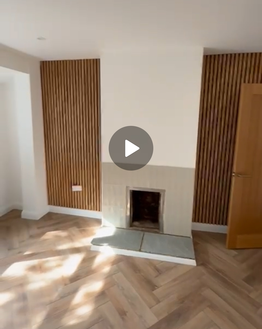

Bought a bungalow and had a builder redo the lounge with panels and noticed rising damp on the right side of the chimney breast also damaging the bottom of the wall panels on the right side of chimney breast.
Any ideas what might be causing it ? or know anyone near Eastbourne with good knowledge ?
Thanks in Advance

Not rising but falling damp, down the chimney , check roof for ingress . Has chimney pot been capped?
Thanks fox I asked the builder and the below was his response
"Chimney looks all good, could always re point it if you like but would need a scaffold for that, I reckon it’s rising damp as it’s spreading towards the door... I’ll take the skirting off tomorrow and see if I can see anything "
Thoughts or tips of what to check?
As above, has the chimney pot been capped?
You could hire a thermal imaging camera and point it at the wall. Cold spots will show where the damp is, and that might give you a clue as to where it's coming from.

Has chimney been capped?
No it hasn't, you think that will fix it?
Empty property with open chimney ?, rain is going to soak down to ground level , no fires to dry it out , if chimney is not in use in needs capping and venting. Any damp with dry out eventually.

It is a case of sensible investigation. Don't sack your builder yet because many would have just said "chimney, guv I'll repoint it"
Thanks I've asked the builder to cap it

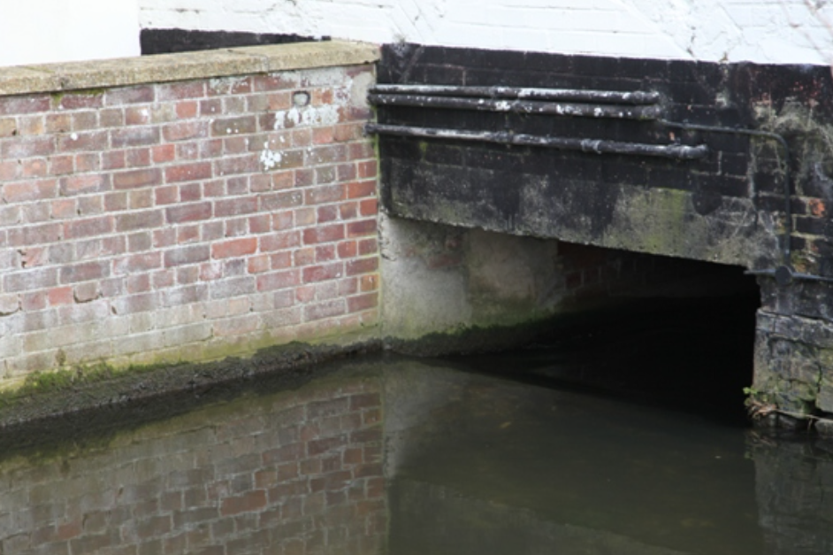

This is a photo from heritage house, which I know is somewhat controversial and I certainly don't agree with everything on there, BUT, if rising damp does exist as capillary action, why is there no sign of a "tide line" in a brick wall standing in water? I have my own opinions on this "1m up the wall" phenomenon - but for sure, not everyone agrees....

Look up surface tension
And capillary action.
Frankly, I am shocked to see people denying that rising damp exists. I wonder if those people also insist that the earth is flat.

Your pic doesn't show any signs of damp? Why not take closer more clear pics esp where you have now removed the skirting?
Whoever goes on the roof should take pics of the stack flashing & the top flaunching of the stack?
Inserting a ventilating cowl in the redundant flue chimney pot will help vent the redundant flue.
