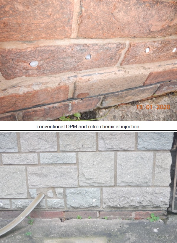

Other pictures show external ground level too high relative to the existing DPC. Also check whether water falling onto the exterior ground/paving/whatever actually drains away from the building and not towards it. Gutters/downpipes must also be checked, including where they drain to.

show where the outside ground level is higher than the interior FFL - or too high for DPC protection.
in pic 1.
the "Faux Stonework" on the wall is well known for allowing penetrating damp & bridging DPC's.
for what they are worth, the line of DPC injection holes/plugs is useless - too high.
the mechanical DPC can be seen 150mm above ground level. one course below the DPC there is a thin black cable showing in the bed - what is it?

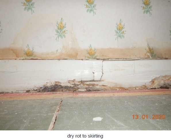

the skirting appeared to show signs of true Dry Rot - so did the plaster above & behind it.
the damp line above the skirting shows a true rising damp salt line.
its possible that no membrane (DPM) exists under the concrete floor - remove some plaster from behind the rotted skirting to find out.

Since the wall you show has both a slate DPC and a (useless) chemical injection, you can reasonably deduce that additional chemical injections will be equally useless. You can be certain that a chemical injection will not cure a leak or a building defect.
