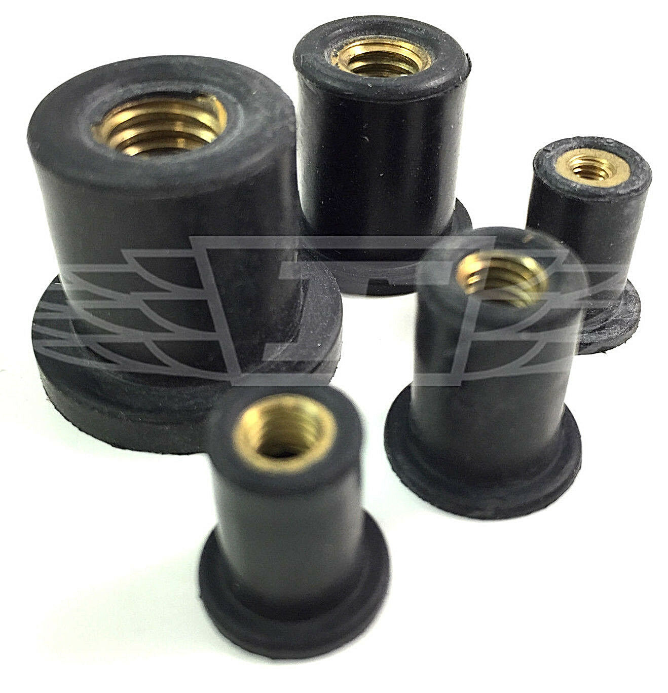

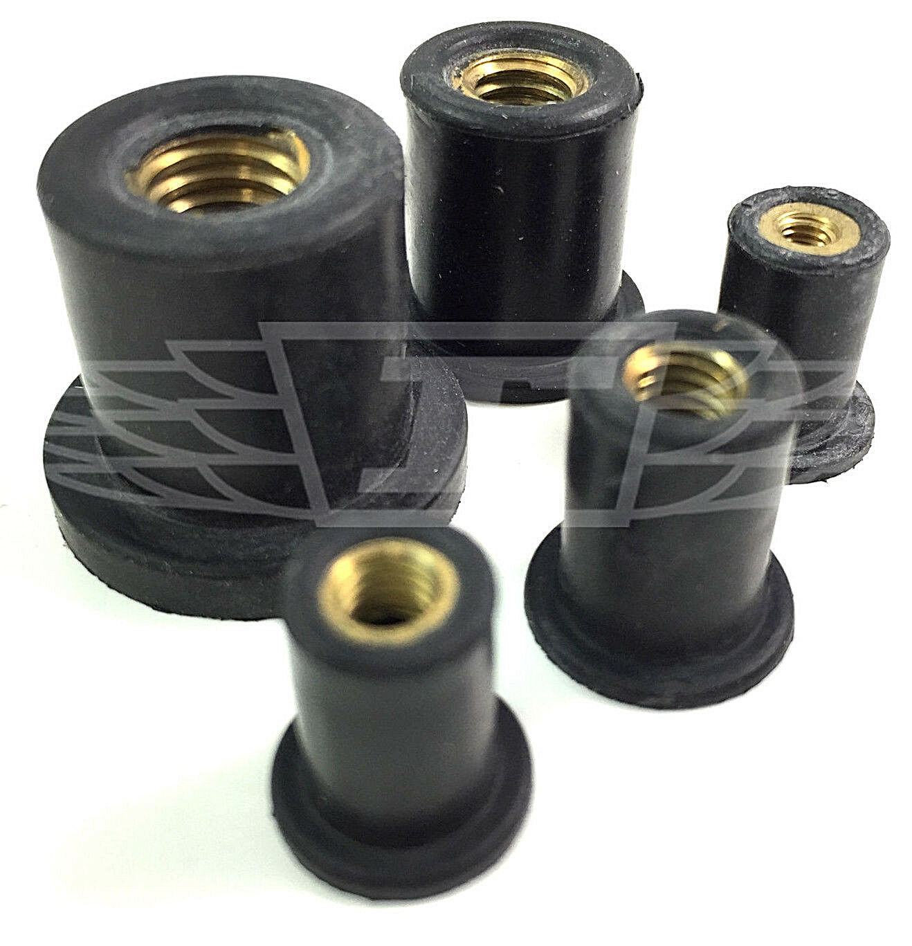

these rubber things are also described as Rivnuts or rubnuts. Used in hollow aluminium sections exposed to wet, dirt and salt. Might be intended to avoid the galvanic corrosion when steel and aluminium meet.
I have considered using them in a garden wall to hold a gate bar, with the idea that the rubber will absorb vibration.
If those are what I think they are, they perform like a toggle fitting. You drill a hole to suit the smaller diameter of the 'nut' to make friction fit, push them in as far as the rubber shoulder, then tighten. The brass insert, as the bolt is tightened, causes the rubber the bulge out behind the panel, preventing the nut being pulled out. They only really work where the panel is an hollow one, with space at the back. The work much less well in a blind hole and the brass insert can sometimes become detached from the rubber.
possibly, but I've never needed to. The rubber should stop them falling out under their own weight. I had a couple missing which I will guess means they vibrated free when no screw in them. If they were under load it should make the rubber bulge and wedge into place.
They were to hold a long engine/gearbox undershield, and undone at every service/oilchange.
