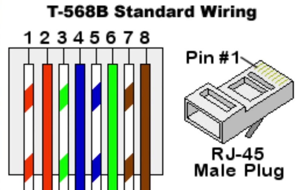

Hi all,
Hoping for a little bit help.
I am installing a wired home network in my house and I have used some cat5e and some cat6 cable I got for free.
Some of it is shielded and some not purely because that it was I had.
I am a the point where I am about to start fitting the RJ45 connectors and need some advice.
As the system is a mismash of shielded and unshielded can I just use unshielded connectors?
Are all connectors compatible with both cat5E and cat6 and any other cat?
Are pass through connectors easier to fit than standard and any reasons not to use them?
Should I be using strain relief boots or are they a waste of money?
Any help much appreciated.

you can use normal connectors just can’t benefit from the screen cable.
relief boots I would use, not expensive by any means, also can be used to I’d cables if using different coloured ones for each cable.
pass through connectors do make it easier to wire the plugs as it is easy to confirm that the cables are in the right sequence and the normal connectors can be a right pita to get the conductors in correctly
cable intended for fixed installations tends to not have plugs fitted as it usually gets terminated to a patch panel or the back of a wall socket, then a patch cable from socket to computer/tv/x box etc. and at the panel end patch cables from a router or network switch

You're unlikely to see any issues with mains interference even with unshielded, individually shielded and cat6 in general is more of a faff to terminate so you're starting on hard a little bit.
Are these easier to use than the ones that have a part that you put the cables into first then insert that part into the plug?
Also some of my cable is sold core whist some is multicore?
And are all brands of plugs pretty much equal? For example I can get 100 off ebay for around £10.00 or should I go for more expensive ones?
RJ45 plugs are slightly different for multicore/solidcore cable. Solid core would normally be terminated into a panel or socket module and multicore is for patchleads.
Not sure what you mean by part that you put the cables into first, are you talking about socket modules rather than rj45 plugs? The multi part one can be a real faff and our installer doesn't like 'em. Passthrough rj45 plugs are quite new fangled but it's very easy to have a conductor not pushed all the way home on "normal" plugs if you're not used to doing it.

The nicer ones tend to have a ratchet so you can get a decent squeeze on the plug, the cheap ones sometimes rely on brute force. Make sure the contacts look like they've been pressed all the way down and test it.
was also going to buy a good (CPC £23.11) rather than cheap crimper (ebay £12).
If doing one or two go cheap. Does not matter as much if you have to re-do them or close it in a slightly hard way.
But as you have lots, get the better one. It will reduce the frustration and the number of badly terminated ones that you have to find later.
