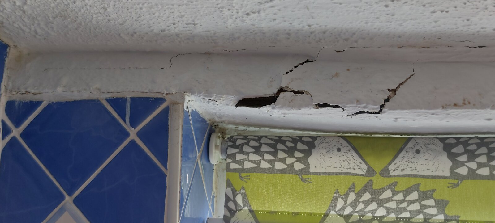

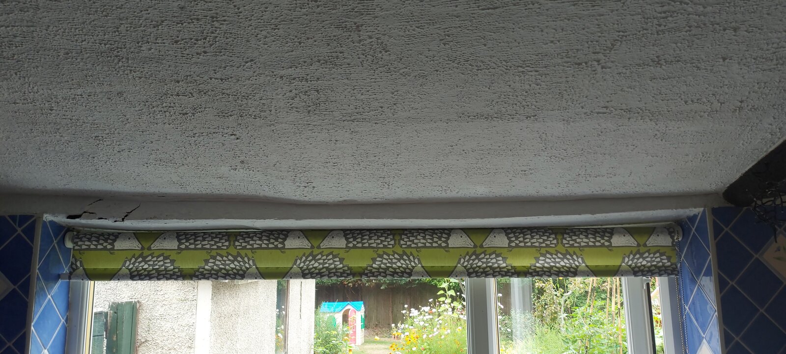

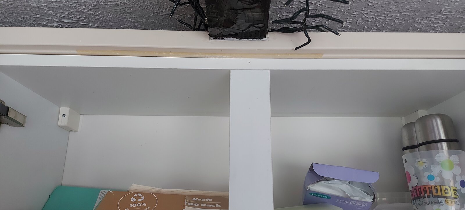

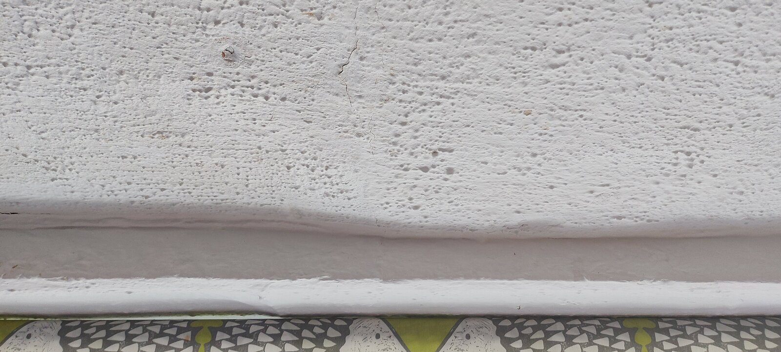

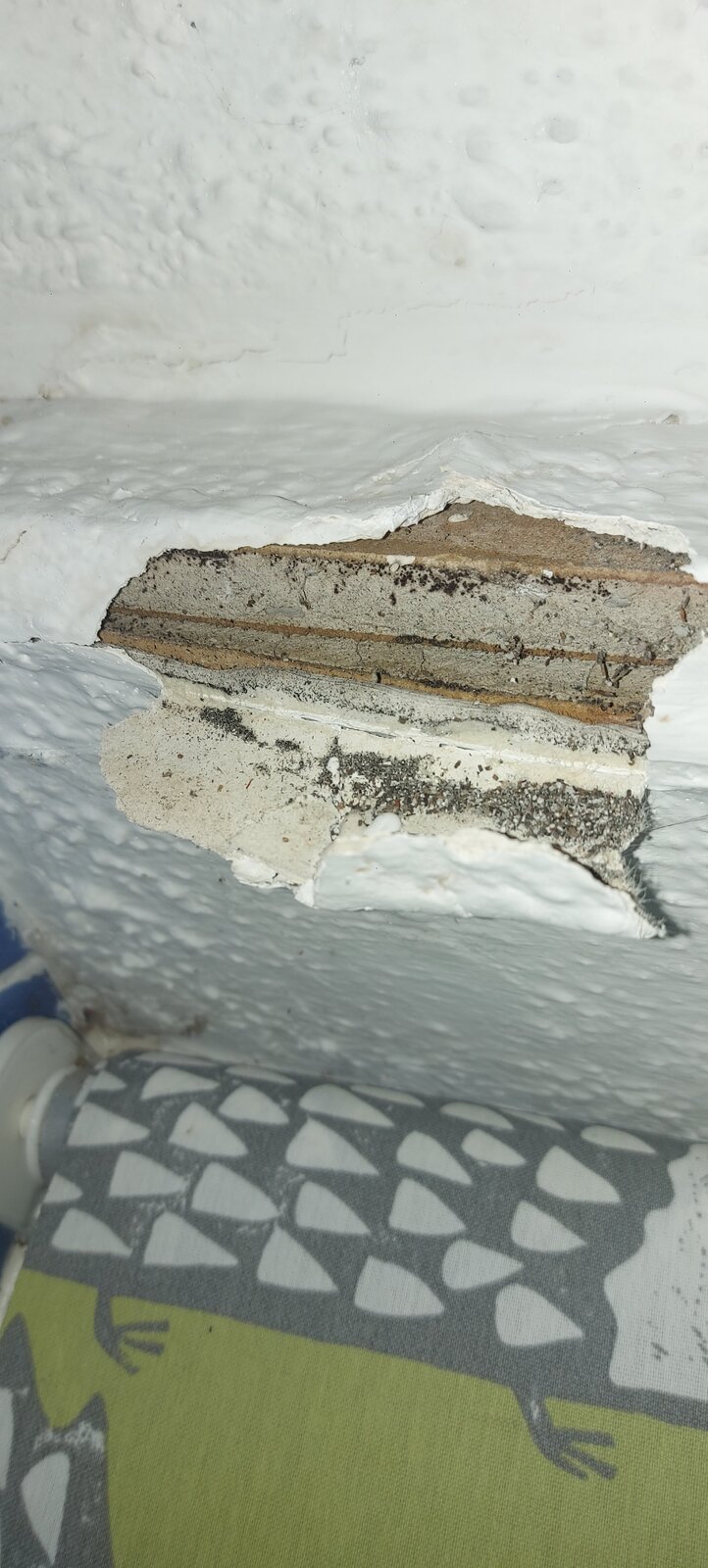

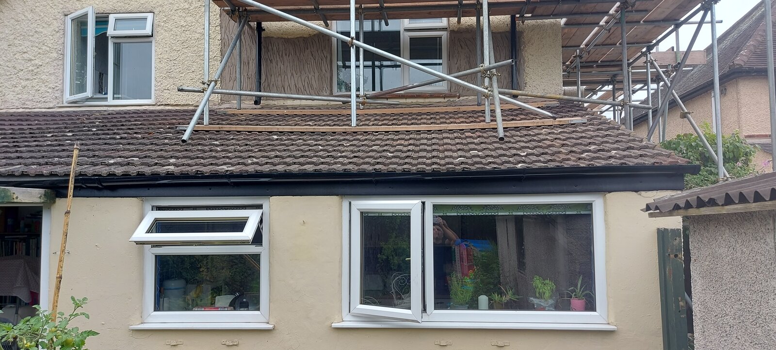

I am very worried right now, we have had our top roof done and scaffolding was used to help the roofers. The scaffolding was put up on the front porch, down the side and on the single storey kitchen roof. The problem is the kitchen roof!
The scaffolders were big and heavy footed working on a Sunday, we heard a lot of banging and noises that worried us. The scaffolding has been up for around 2 weeks now and these are my concerns: the kitchen cupboard directly under a beam gets jammed for the first time, you can see the wood of the cupboard bowing, cracks in the dated artexed ceiling appearing, the blind over the main window rubbing against the plasterboard above, the beam has come away in places...... From the outside you can see the roof dipping in the middle.
Has the lintel snapped? What do we do?
Thank you so much in advanced for your responses, we have small children that are fed in the kitchen and are worried about all of our safety.

Yeah it appears they've damaged the lower roof. Did they stack tiles on the upper scaffold platform?
Take loads of pictures and talk to the company doing the work. I would not let the kids continue to use the room until the roof and ceiling has been checked. Even a lump of plaster coming down will be a serious enough injury to a small child.
If they aren't immediately apologetic and promise to get it checked and fixed then I'd get onto your house insurance company.

I’m trying to work out what’s actually happened/moved looking at that pic. Can you post a pic of the issues inside?

Scaffold should be designed and not just thrown up.
TG20:21 is the standard, and requires that roof to be properly assessed and calculated to take the scaffold. There should be a plan and design documents, and a handover sheet passed to the builders from the scaffolders. Following handover the builder should be inspection the scaffold (and the roof) at least weekly.
You, as the client can ask for the documentation to prove that the scaffold has been properly designed, and regularly inspected.
I doubt there will be any.
