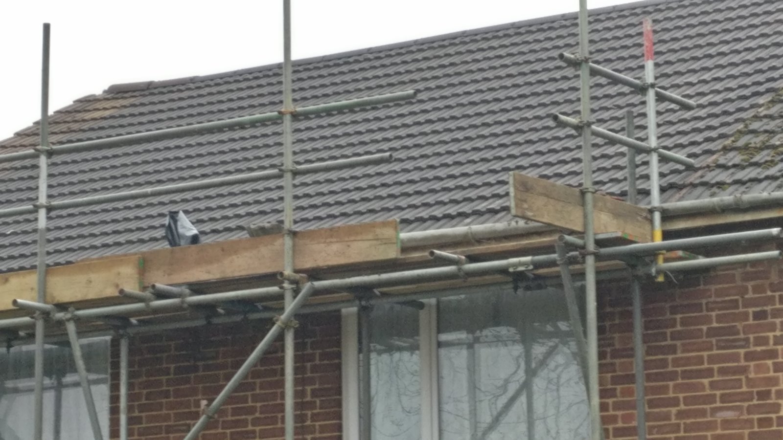

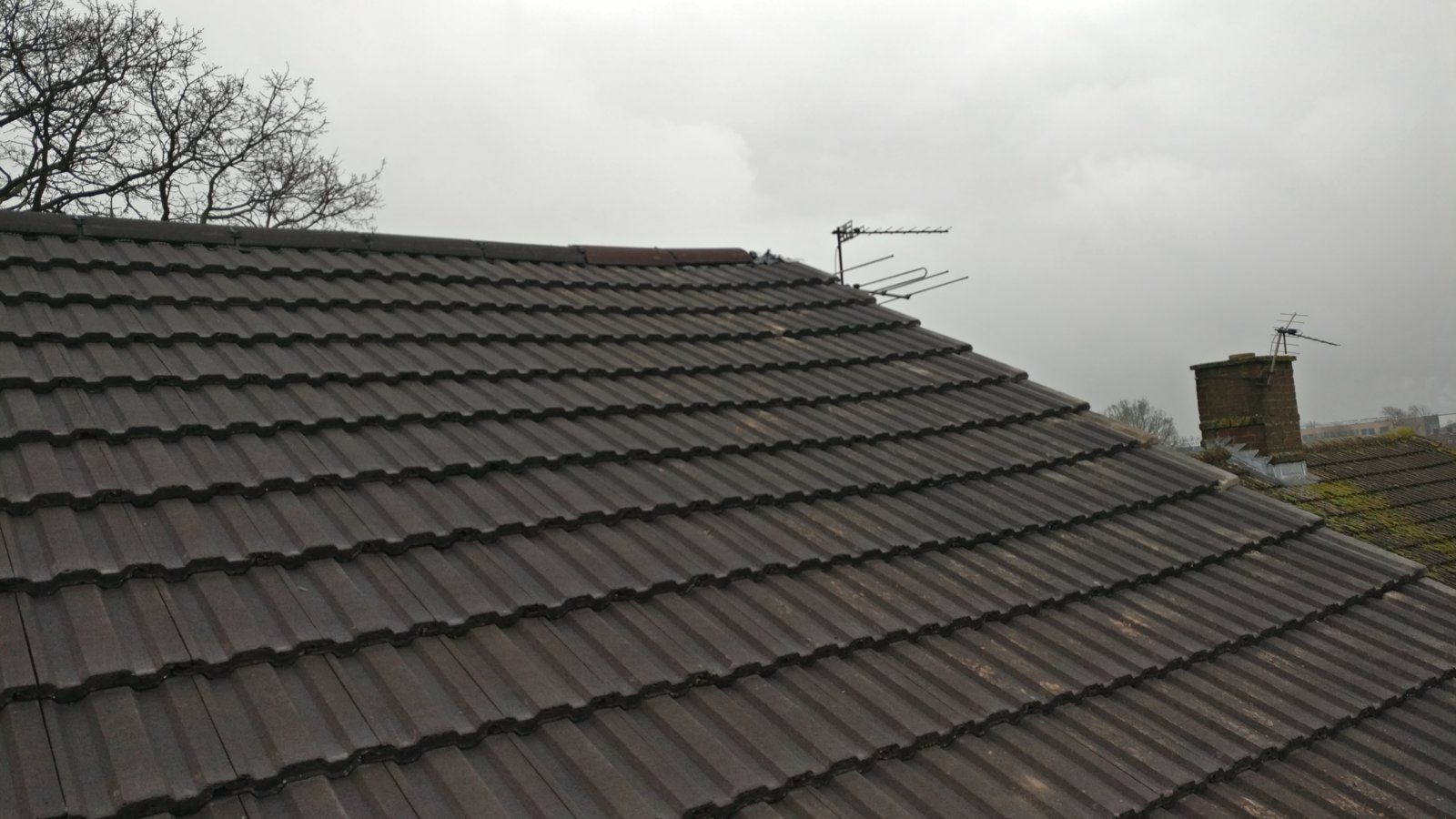

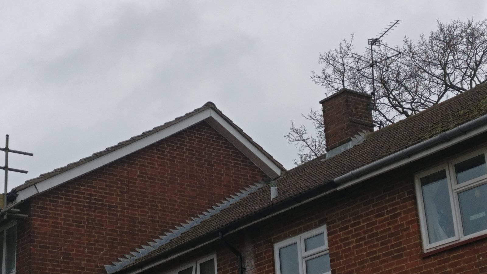

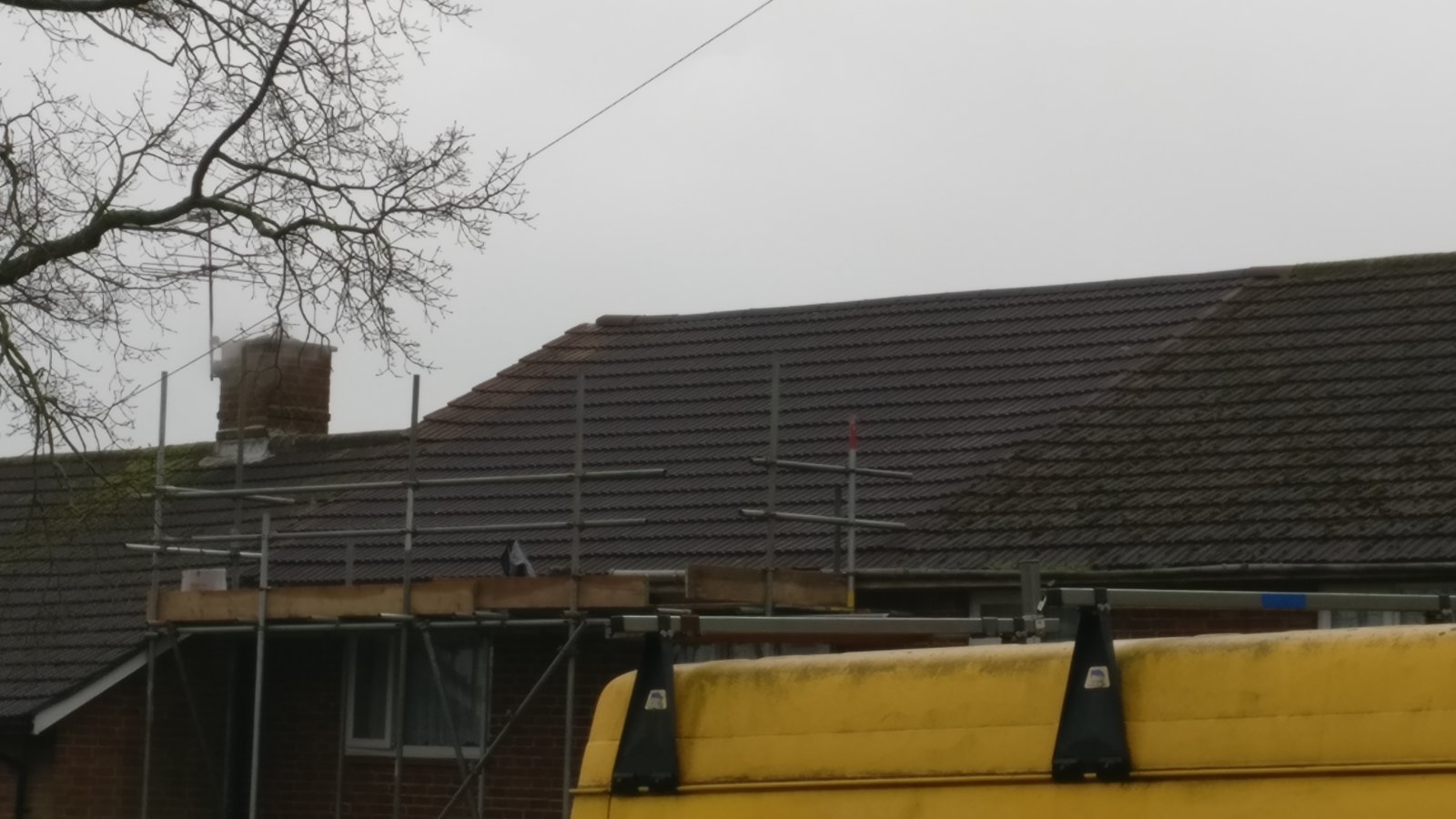

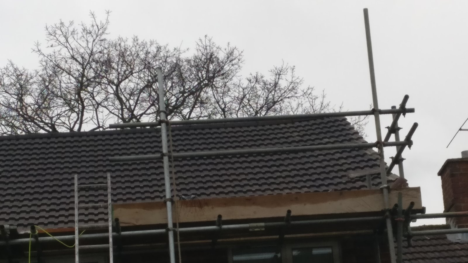

Anyone know what's causing the pitch change of the eaves row. Seem to be different from the rest of the roof and yet the neighbours seems fine. Is it smaller battens on the neighbors. Or a batten underneath kicking the neighbours bottom row up that he's. needing on his roof. Maybe a smaller batten. Maybe only one of thems been counter battened.
You guys thinking hes not ran out his top and bottom course...not done his perps started tiling so far along from the left...got to the end and hit problem?.

It's a amateurish mistake. As the front of one tile rests on the back of another, the first row of tiles has nothing to rest on so it will dip. To avoid this, there needs to be additional batterns or a battern on edge, or over fascia vents to lift the front edge of the first tile up.
The neighbour's does appear to be similar, and as the tiles are bonded, this may be a bit awkward but could be blended in.
There is an argument that its better to have the tiles match on the two properties, and avoid an uneven line of tiles and different distances between the tiles and gutter etc. But it's not right and if it can be altered, and would not look out of place if done so, it should be.

Is he still turning up for work everyday atm...starting to appear that he,s avoiding finishing the ends, eaves etc for some reason. Probably because I m not sure he,s ran his first and last course out to see where it ends and put his perp lines on to begin with. Its now become a harder job to finish. He would have probably been better using a GRP valley to separate one of the neighbors roofs. To make life easier for himself.
I think maybe he can't get the tiles to close at one side now. Someone said their might be a gap between the neighbors. I think you need to get up there with him...let the guy explain to you any queries you,ve got.

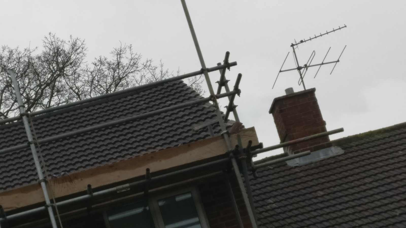

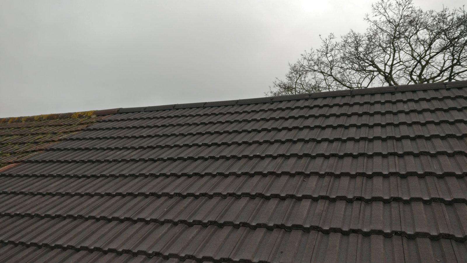

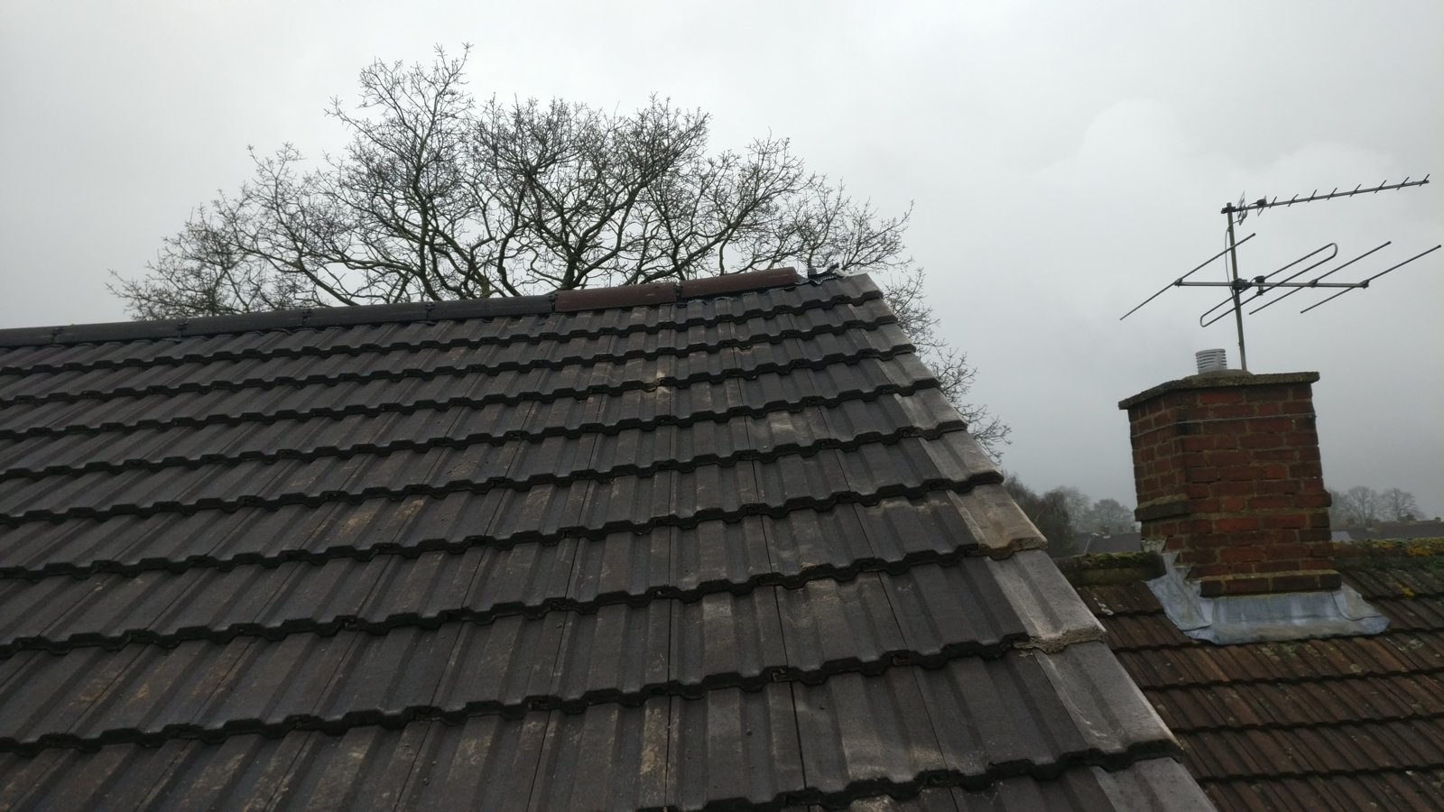

The right hand side end cut tiles seem to be a different color. A few of the ridges that are loose are a different color as well.
Did he run out of tiles/ridges?
I think he,s still to finish it tho. They could well just be temporary.

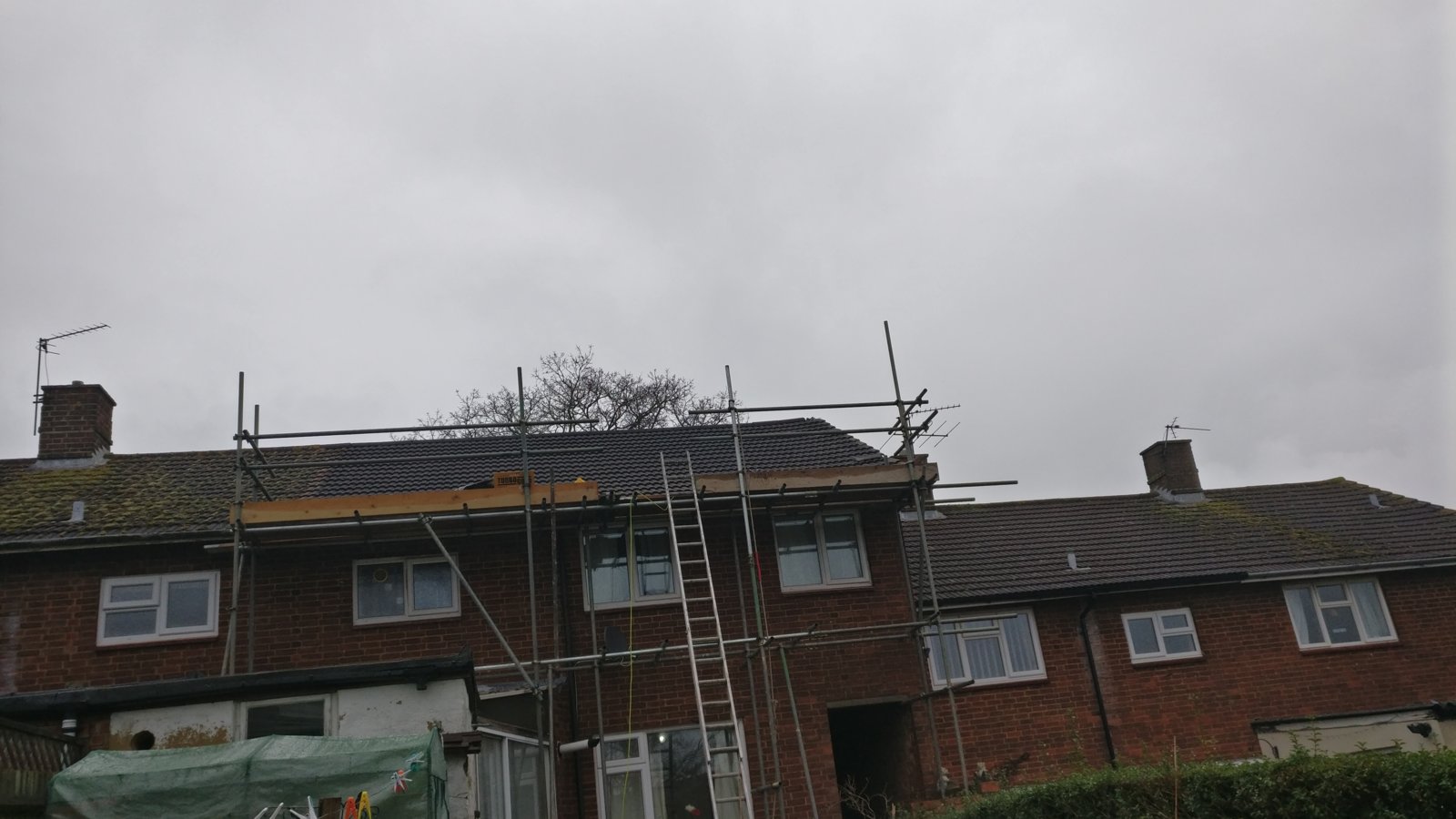

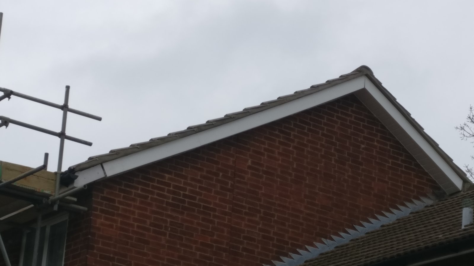

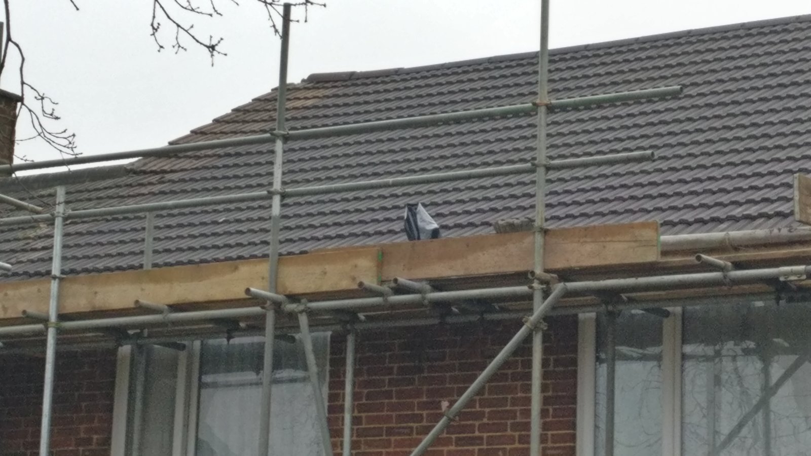

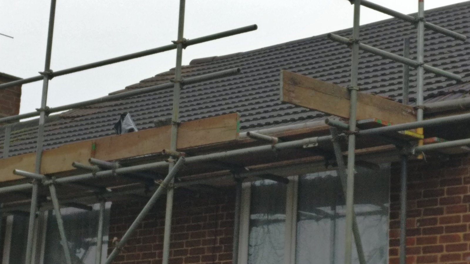

He did turn up today but only for few moments. Explained to him that those ridge tiles are of different sizes and shapes than the rest and front row of tiles got a dip on them. Here's what he said....
1.I am aware of that and ordered some new ones it will be here between 4/5days.
2.scaffolds coming off on this Monday
3.eaves tray will be installed in front with gutterings and fascias that will push the front into place.
4.there will be also a vent tiles to get some air movement going in the loft.
But looking at these pictures I don't quite understand how is he going to put new ridge tiles in there when it's been mortered already and without any scaffolds??

He seems to have covered the queries. But it's odd why he would drop the scaffold only to do the fascia work (and ridge) off ladders. Yes the platform is a bit high, and it's up to him, but when jobs are difficult or awkward, the risk of quality issues occuring is greater.
Overall though, it's not that bad all things considered.
As you said, Overall things are looking to be OK. He can't do the fascias and gutters because the scaffolds are very much too close to the gutters so there isn't enough room to move things around.
The way he told/explained everything to me today if only he did that from beginning we probably wouldn't have had any issues whatsoever.

Yes having the platform in the correct place to deal with all the work comes from experience.
