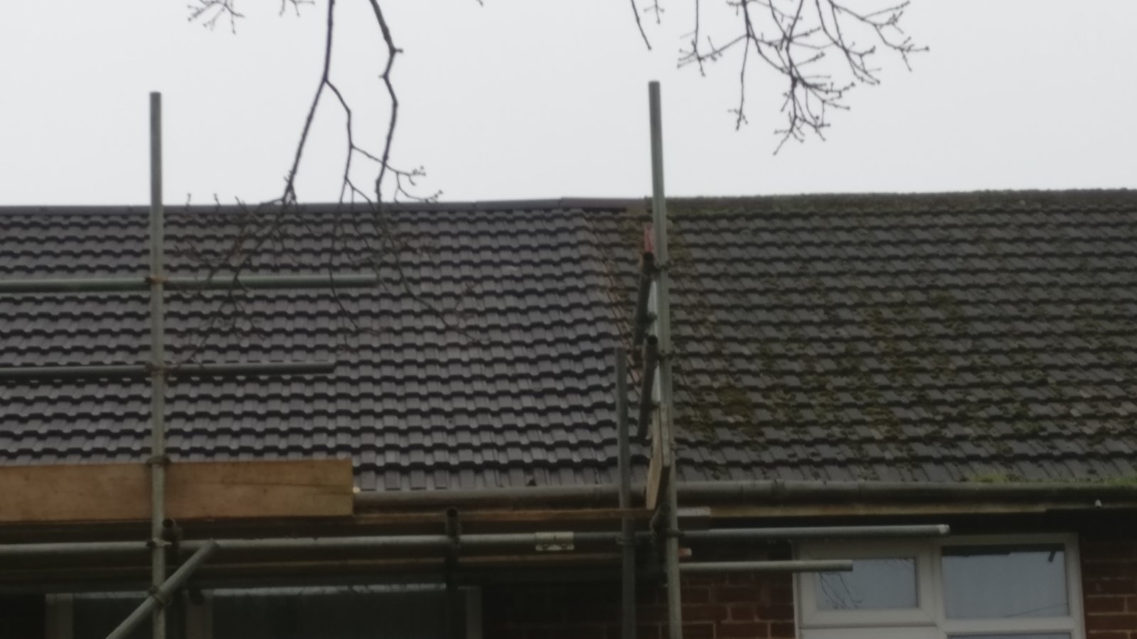

Roof done right or wrong??

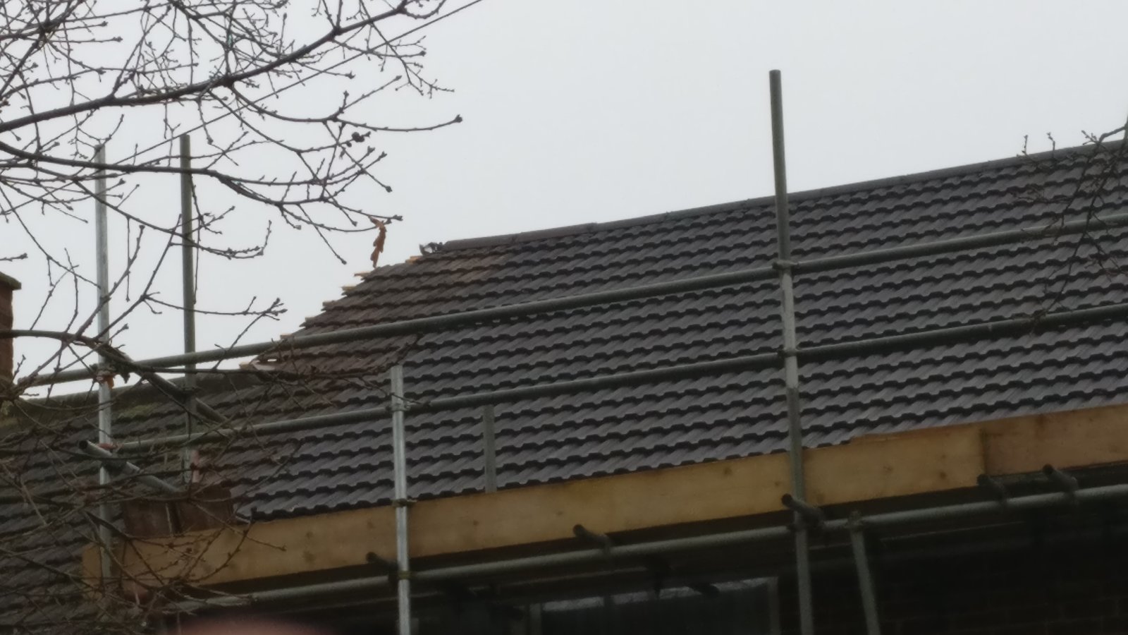

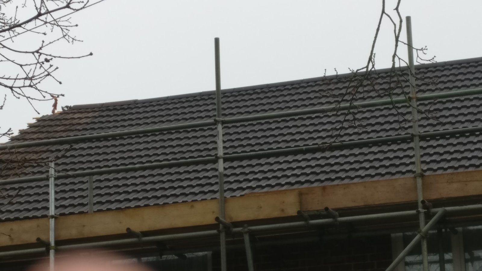

Looks like the eaves tiles need picking up - they are at a different angle. Also check that a plastic eaves tray has been used.
And based on this being a new roof covering, I wonder why eaves ventilation had not been fitted as standard - is there existing soffit ventilation instead?
But either way, and more significant is that they should have fitted some corregated vent roll on the rafters to keep the insulation down off the membrane in the loft and allow air up from the eaves.
I don't know how they can self certify or the council inspector can pass this without it.
Your condensation problem, it should not be anywhere near that bad regardless of ventilation up there as the membrane should release any small amount, you need to stop any steamy air getting through into the loft. Check the ceiling especially in the bathroom and airing cupboard and around the loft hatch for any pipe and cable holes. Even astound the bathroom fan grille. Is the duct for the bathroom fan venting into the loft at all?

Soffit has no ventilation on them whatsoever, there was a plastic tray used under the ridge kit so I don't know if thats what you are referring to.
Roofer did say he is going to provide a certificate after all the work is done. So I am very more looking forward to that.

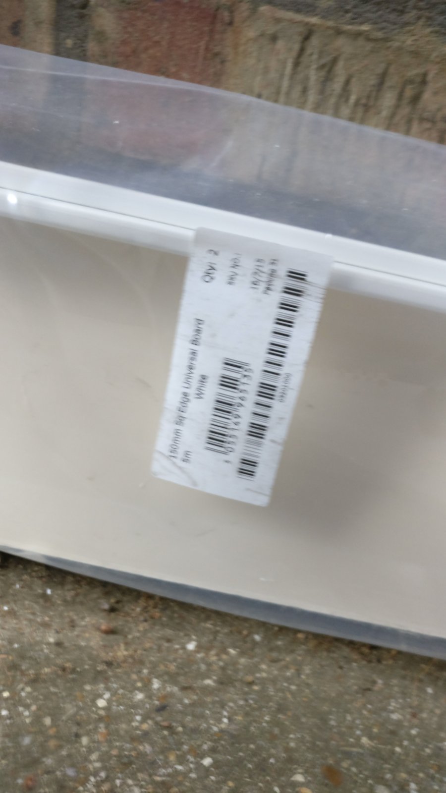

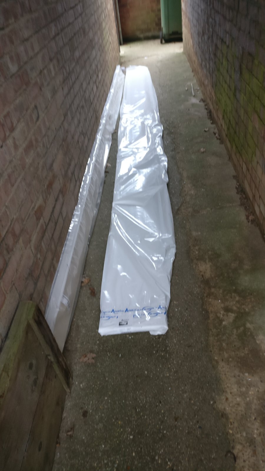

One of these
Or some or all of these
I didn't see anything like this being put on when he was doing the felt. New Soffits and gutterings are not yet installed so I will see what he does.
Thanks for those pictures "Woody" it explains a lot(y)

I,d get him to fit the eaves trays but not everyone fits them here in Scotland. The 50mm of felt at the bottom will degrade quicker without them. We fit the eaves trays...but if the tiles are slightly covering the felt...it shouldn't degrade quite so fast. Think a lots to do with it coming directly in contact with UV rays...the water from the guttering being full and the water that comes from the roof onto it causing the problems. If the tiles are slightly covering it at the bottom...say ten mm,s. The water from the roof should,t come in contact with it. And the UV rays won' really affect it either. Still get years out of it regardless just not as much as the eaves trays.

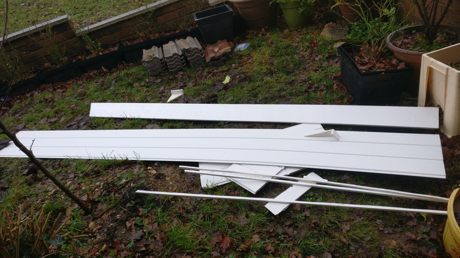

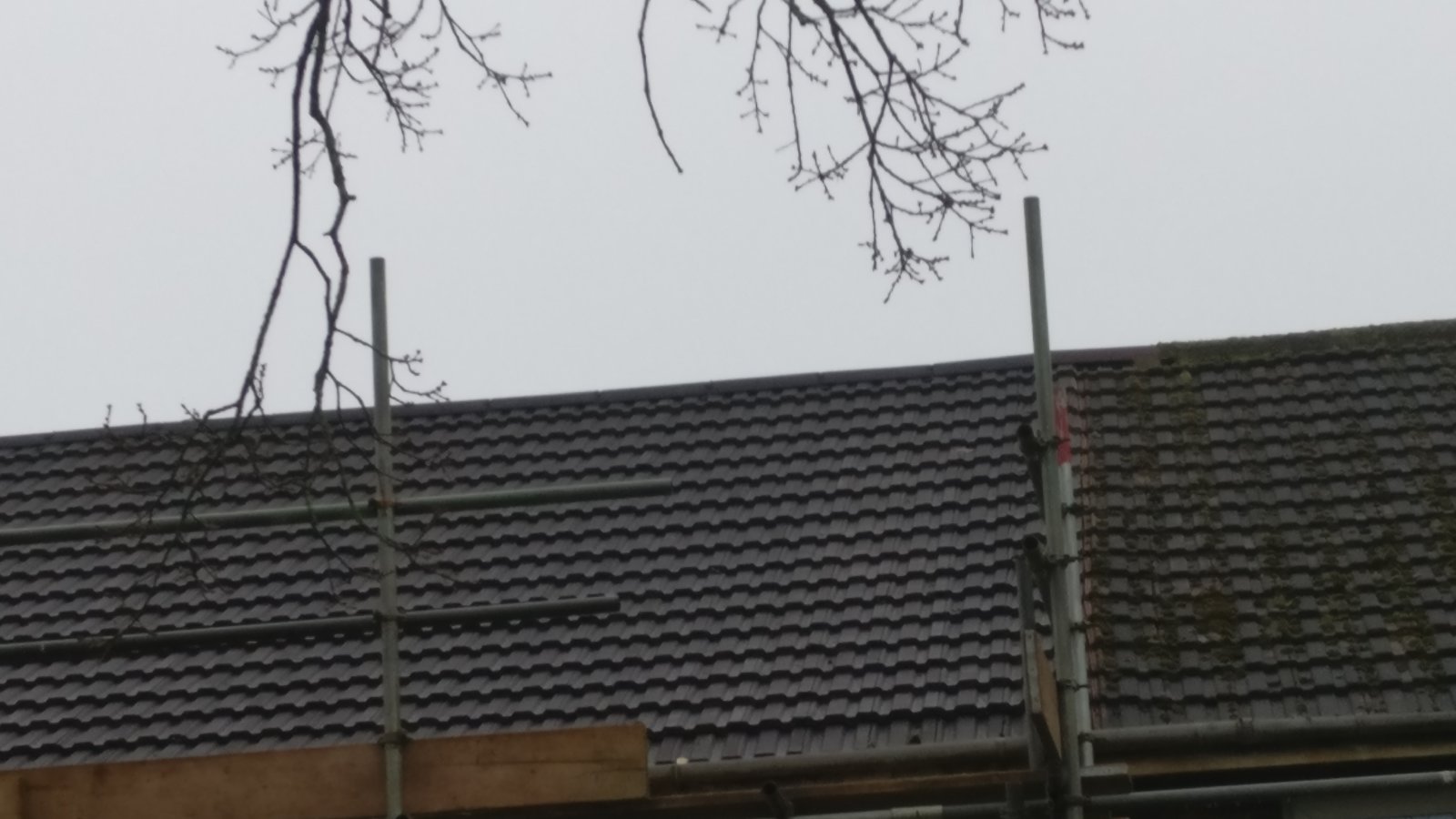

I hope that won't be the case. Here is some pictures of work progressed so far

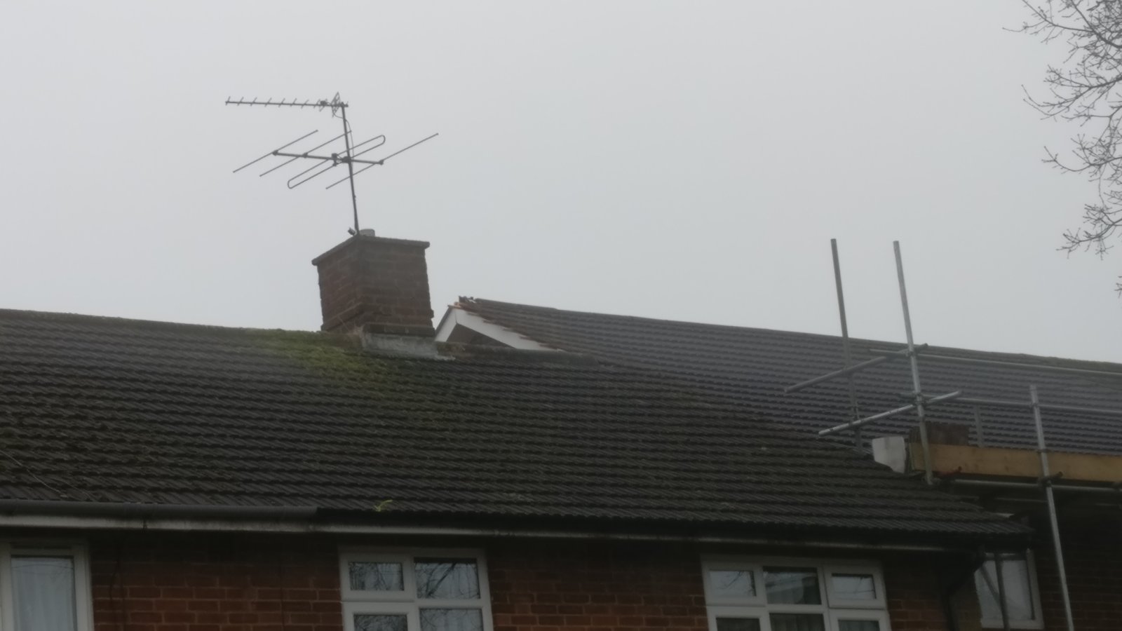

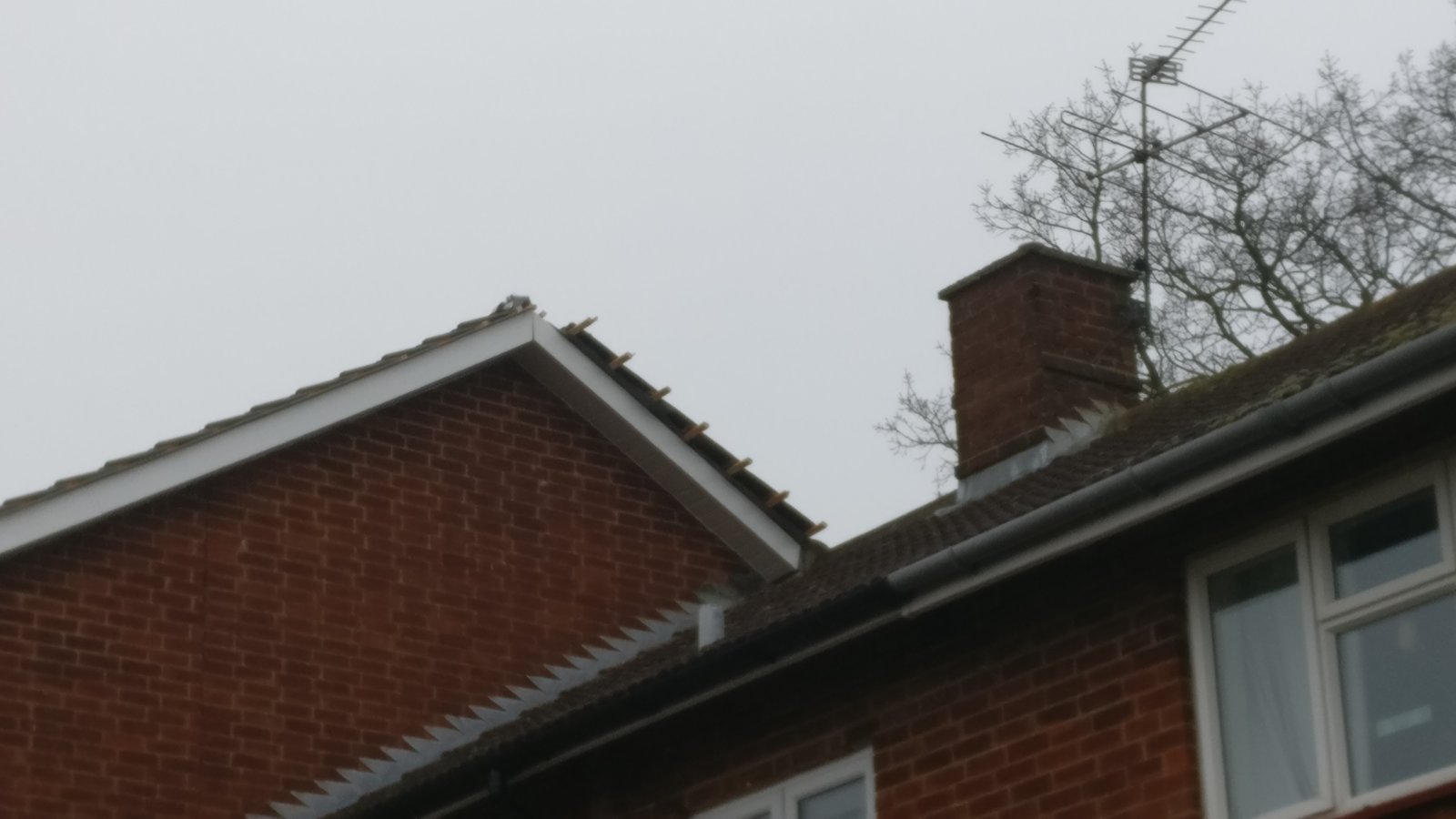

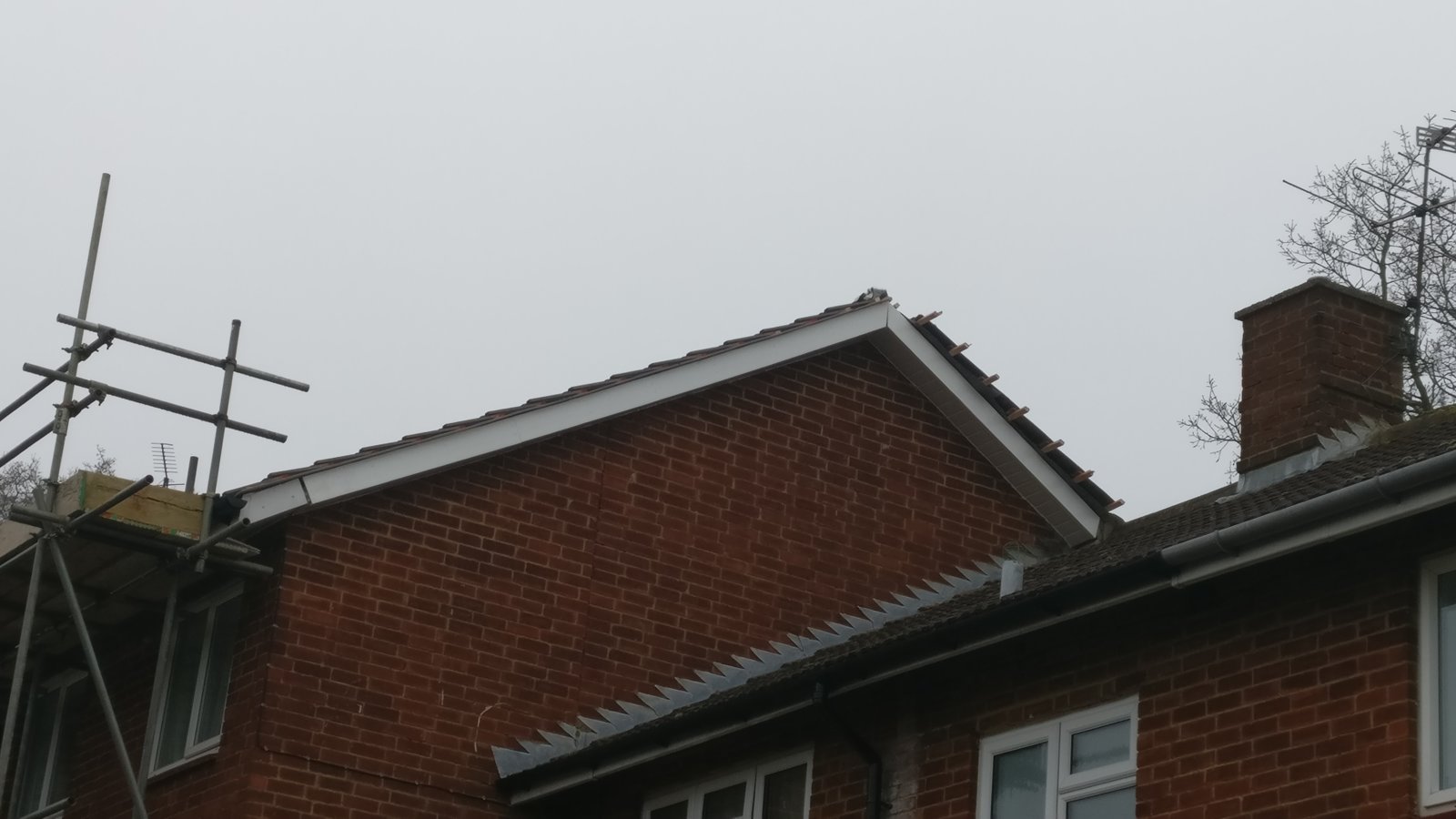

One of those pictures is very alarming to me!
Why is there a gap between yours and the
neighbours house approx 2-3"
Yes that's the one! I'm guessing he hasn't done his perp
lines and he started at the other end, and he is now
doing this(n)
