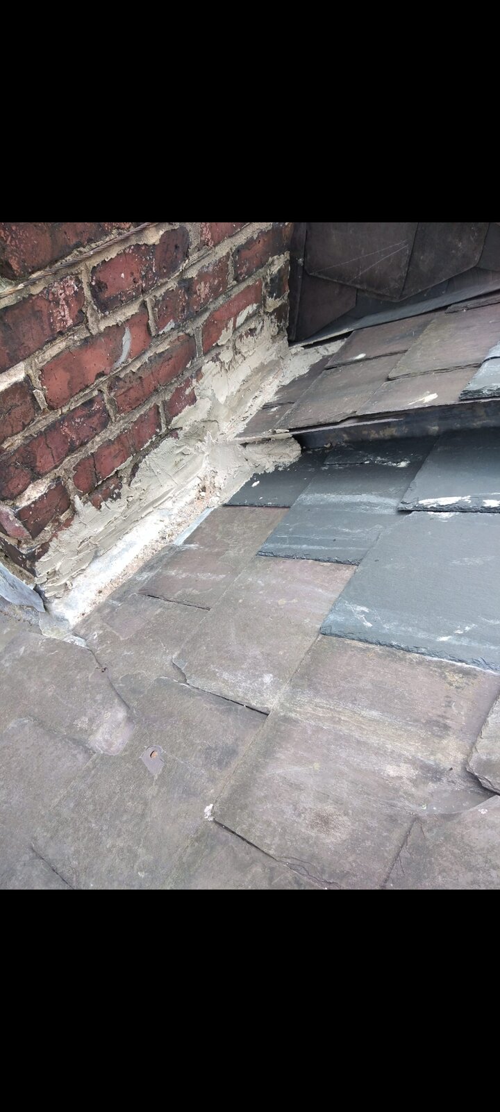

Hi I hope someone could help and give a little advice on this matter.
Our neighbours was having a loft conversion and they somehow managed to miss calculate things or were trying to get extra head hight who knows, but they ended up raising their roof on their semi-detached house by several inches.
Because damage was caused to our roof and the people next door weren't bothered we contacted the council to tell them about the ridge now being higher than ours. After over 4 weeks the man from the local authority came and this is what his reply was.
"As the work is being overseen by an Approved Building Inspector, the Council have no authority to inspect the work for compliance with the Building Regulations.
In its capacity as Local Planning Authority, the Council cannot take issue with the standard of workmanship. The slight increase in ridge height does amount to a technical breach of planning control, but this breach causes no material harm to the street scene or wider area and it would not be expedient for the Council to take planning enforcement action in this case."
He said it was a civil mater and to take it to court.
Is this kind of response common practise for all the council's?

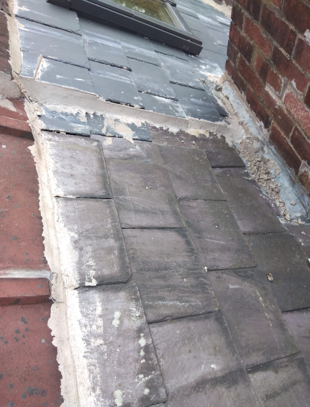

The the gap between the 2 roofs has just been filled with cement and is peeing in on our side.

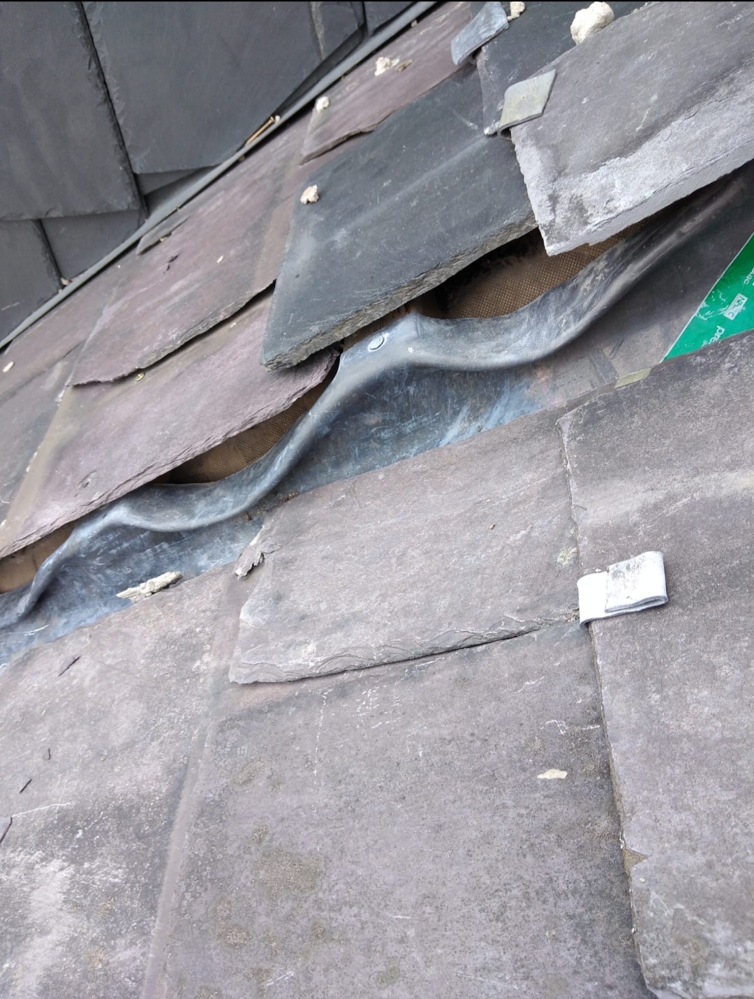

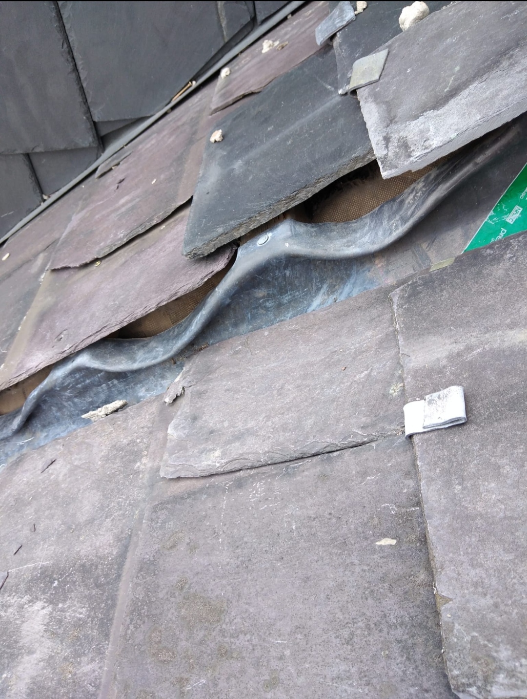

A brick has feel out in our the loft on the party wall and we can see their new timber. The roof has no bonding gutter they raised the roof by a good few inches so water is pouring in when its rains.
The builders couldn't access part of the roof via their side so accessing the roof on our side and the slates have disloged on both roofs and some have fallen off into our garden. And we have 2 holes in our roof and damaged the flashing. There is more but thats the bones of it.

You can't injunct on PW issues for work that is completed. Also, if you could claim on PW issues you are limited to the specific PW works, not any old building works that you want to chance.
If a claim does head to court, you should have a single joint expert report agreed by both parties. Or if you are going to rely on your own surveyor, ensure he is actually an expert and can comment (via experience and qualification) on the things he is commenting on. If the othert side has a better single expert, you are at a big disadvantage
It looks to me that this is a normal property damage claim under negligence, not a PW matter. Your legal advisor will advise on choosing the appropriate route to prevent any claim being struck out, but you may also want to include the builders and designer(s) as joint defendants.
