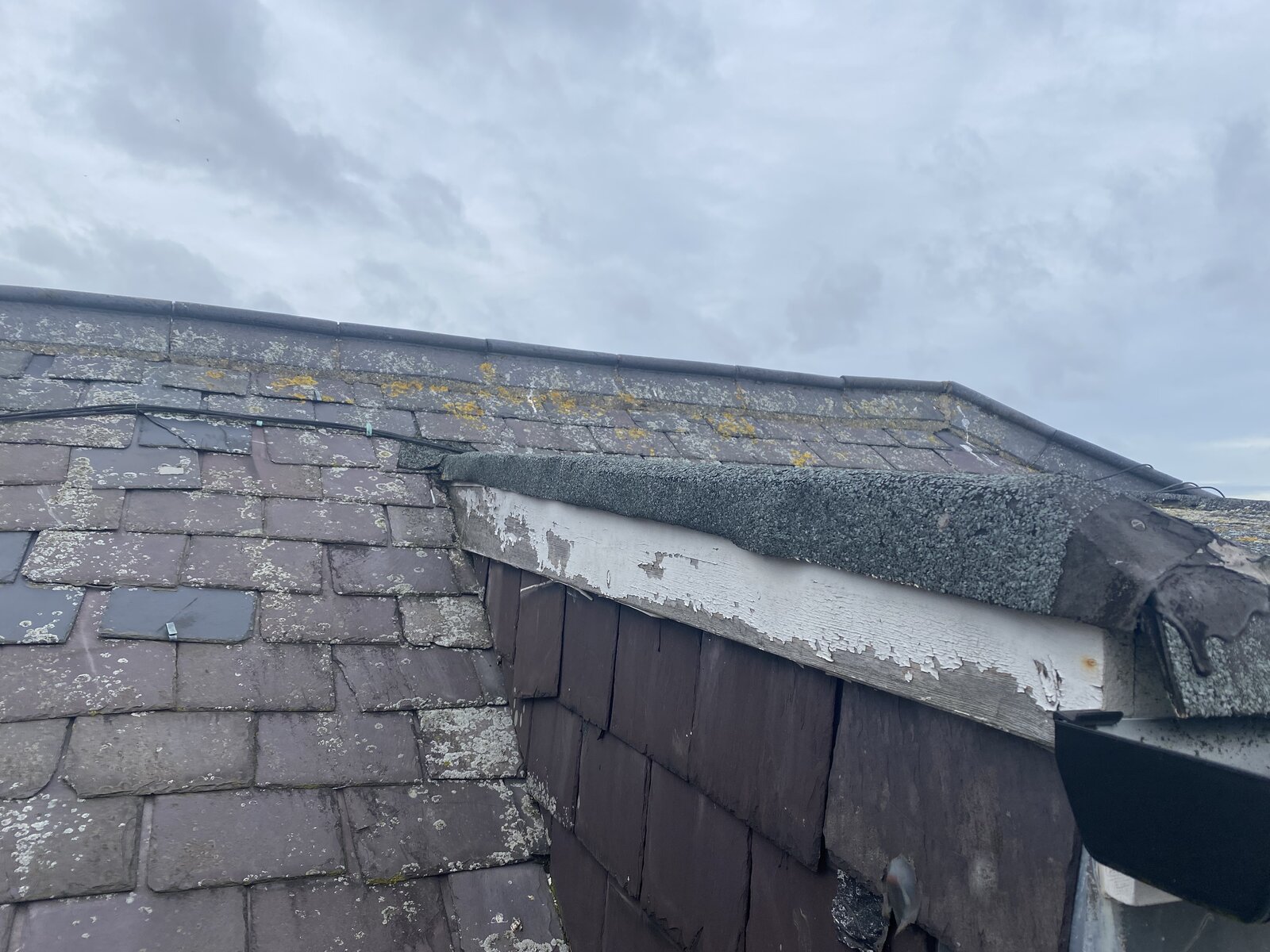

This is the only photo I have and the issue is at the bottom of the valley as you look down onto the dorma roof. It runs into a big flat valley and the leak comes in on the left side of the big valley where my gun is. You can see my lead patch, and this is tucked under the rubber valley coming down.

Mmm. With the age of those slates I'm surprised there isn't lead up there
Ripping and tingling that lot to effect a full repair wouldn't be fun, probably lose a load from breakages. Unless you were 'lucky' and find they used cut nails and they've rusted out....
With your next patch you might want to try getting under the narrow valley felt/whatever but it's a high risk option (might make things worse if the felt goes under the slate verges on the valley)

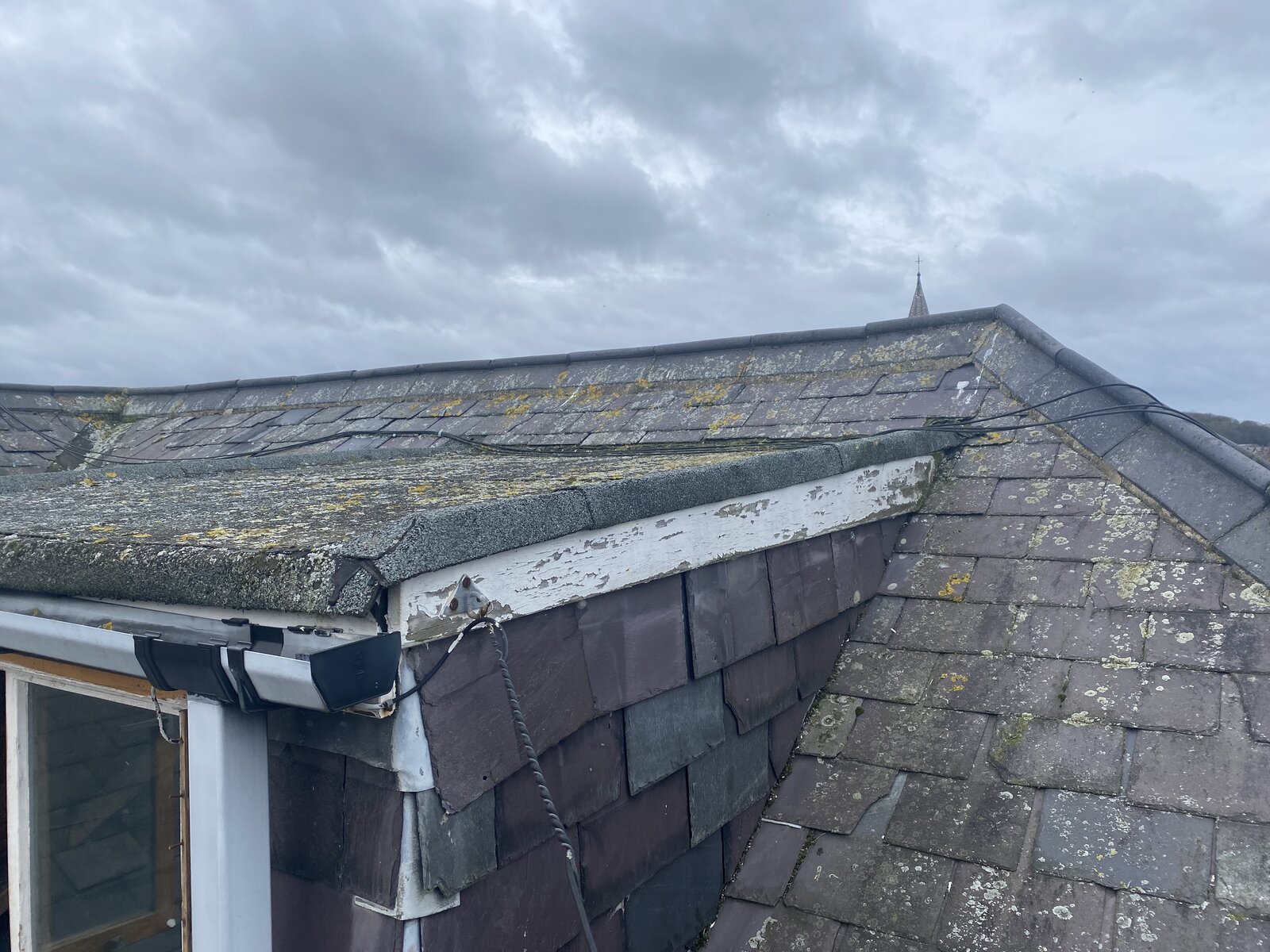

Presumably you live in the dormer flat - whats to stop you from stepping out and taking pics of all three valleys, and the front apron area of the dormer?
The valley in question has had a previous lead repair piece higher up and the other valley isn't shown.
The dormer apron upstand LH wraps around to the dormer cheek incorrectly.
The slates below the dormer apron LH side are a bit jumbled.
The valley in question has perished - its finished.
The box valley was wrongly constructed in the first place.
The junction of all three valleys was also badly constructed.
Roof leaks can occur anywhere & present somewhere else.
Sooner maybe than later, you will have to get a roofer up there for a pro opinion - once a roof starts to go then its one thing after another.

Can you see the patch ? I managed to lift the rubber narrow valley at the joint and push the lead about 10mm upwards to give it a little lap.
I didnt want to go higher in case i created more problems. I use a sealant on this join as well.

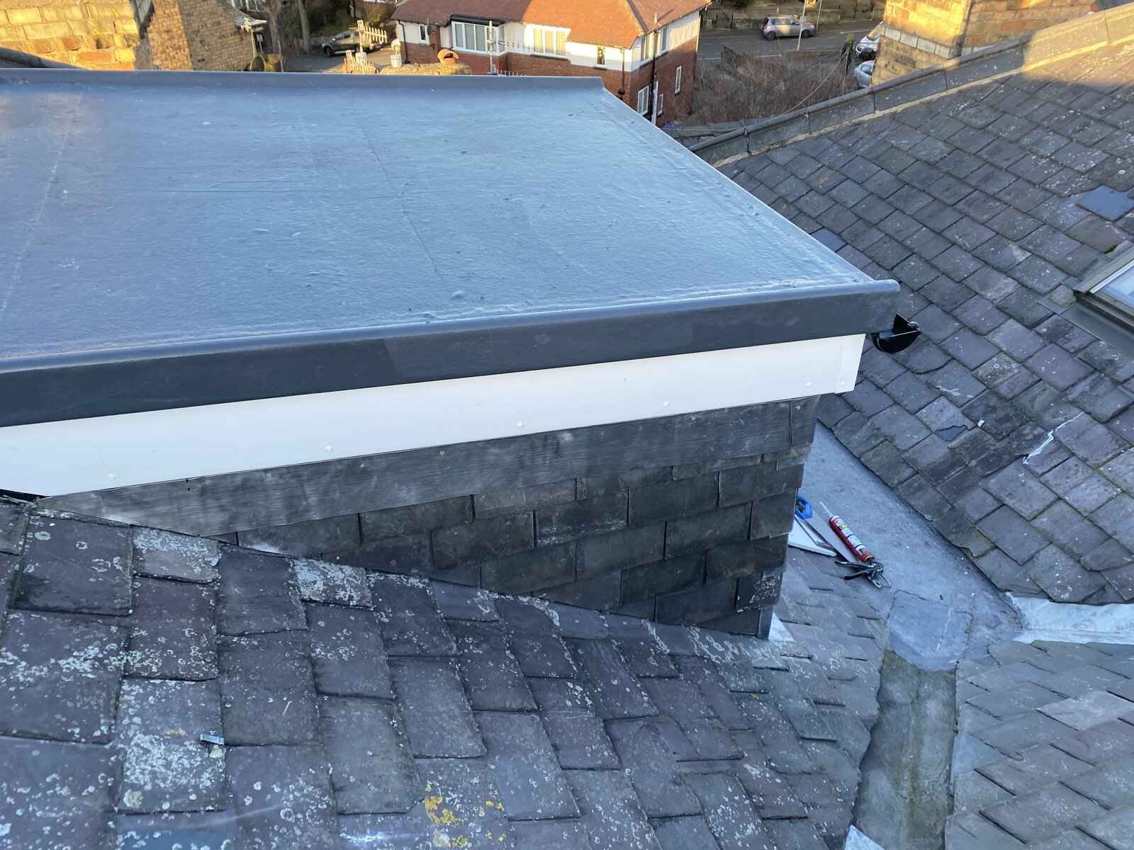

Its a 1890 aged building converted into flats in 1985. So i think any roof work might have been done around the time of conversion. The dorma was done then as well and this is what it looked like the other week.
I’ve repaired a fair few slates this last week as well, but I just don’t want to have to tackle that valley. Lots of issues like you say. Plus would need the other block to chip in and pay. So a whole load of admin issues.

I'm not a roofer, but i ended up doing the dorma in fiberglass but the roof was done first and then it was decided to do the slates again. So yes ideally the lead apron would be under the facia, but I couldnt change it. The previous dorma was wrapped in bitumen type paper just nailed to the OSB cheeks, then slates hung off the OSB. Ive wrapped it in a membrane, battened it out and notched the battens. Then new slates have gone on.
It is pretty sound all round so no issues should be popping up.

You made quite a good job of renewing the dormer - well done.
However, I think you've got the location of the lead apron I mentioned wrong? The bottom of the outside corner where lead wraps around the corner is where i meant - moisture could be going behind it?

I think the flashing will be ok. That break is there for expansion. Some sealant behind it will work if it becomes an issue.

It may be nothing but looking at your photo of the dormer it looks like the lead below the white fascia has a gap to it on the left side and the fascia should ideally sit over the lead whereas it looks like it is butted up to it. Could this be the entry point over the roof edge and water is travelling down the inner timbers ?
p.s If you are nr Leeds I don't mind having a closer look for you. F.O.C
No the leak is damaged felt and is 2 yrs old. The dorma refit was nothing to do with it but yes the lead would be tucked under the facia but it was decided to do the sides after the roof went on.
So I have a small gap but have left it for now. A silicone bead will sort it out if an issue
