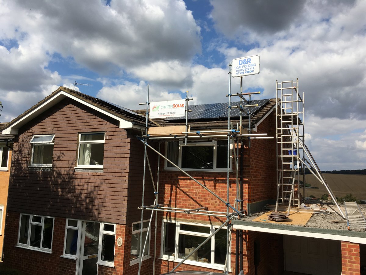

You haven't posted a photo that shows what type of scaffold will be needed. I suspect I could use one of my easi-dec systems to do that safely while complying with H&S.
From your photo it's looks likely that a couple of the panels will need to be removed. Will your roofer know how to do that? I wonder if it will affect your warranty on your pv system.

The photo is a little mis-leading on that front. I believe it'll be OK. Nobody has indicated they'd be a problem. But the fact they're there makes me want to ensure I get someone who will put the extra effort in to ensure they're working safely. I'm leaning towards the expensive person now. They're the only one who has truly made me feel confident they will do a good job. It's just a *lot* more. But I don't think out of the price range as far as people here are indicating.

Edit: we really need a photo that shows that elevation from ground up.

Attached a photo showing the scaffold the solar guys used. And on the right is a tower used to remove our chimney. Does that help? Thanks for the help!!

Scaffold on that in and around Cambridge £4-500. I have had scaffold erected as far down as St Albans for similar money. Your roof could be done quite safely with an easi-dec roofline system.

Thanks for the advice on the scaffold cost. Nobody has mentioned that other system you mention. It's either been "tower" or "I'll just nip up a ladder". Or the expensive guy who wants scaffolding.

The easi-dec is often referred to as a tower scaffold. The system is much more than that. A lot of roofers are now using them for repairs so their costs will be lower than someone that uses an independent scaffold.
