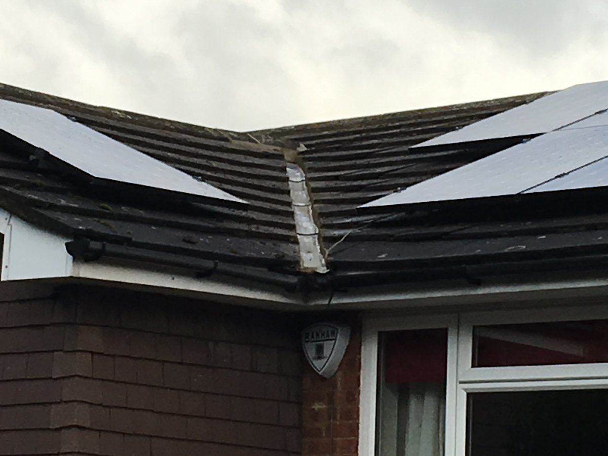

Job done. Went with the 490 guy. And I'm pleased. Gave me some advice about the ridge tiles too - don't need rebedding just yet but will in the next couple of years. And the other valley he took a look at and didn't suggest doing it just yet. It doesn't look too bad right now.
Photo attached of the final job.
(Please tell me it's a good job!)

Perhaps you would care to answer a few questions, other DIY'ers or house holders will be following this thread, and wondering just like me whats actually gone on?
What access was used?
What code lead?
Was the valley stripped to valley boards.
How was the felt replaced?
Were the tiles on either side lifted to allow the lead to be laid?
Was the valley freshly repointed?
How long did the job take?
Something in the last photo doesn't look quite right with the lead and the valley pointing - would it be possible for you to take a couple of more detailed (& clearly focused)snaps?
FWIW: the lower left tile is still cocked.
The gutter angle bracket has been forced down - it will pond & eventually leak.
Well, after being patiently given much advice the OP disappears, and doesn't answer a request for a few final questions - pretty much par for the course with so many original posters.
However, perhaps others will look at the final photo & see what looks suspiciously like the valley tiles were left in place, and so were the surrounding field tiles and valley pointing, and the lead has simply been laid over the valley tiles (on some kind of filler perhaps), and edge siliconed to the valley pointing.
My monitor is rubbish for detail but FWIW thats how it looks to me.
