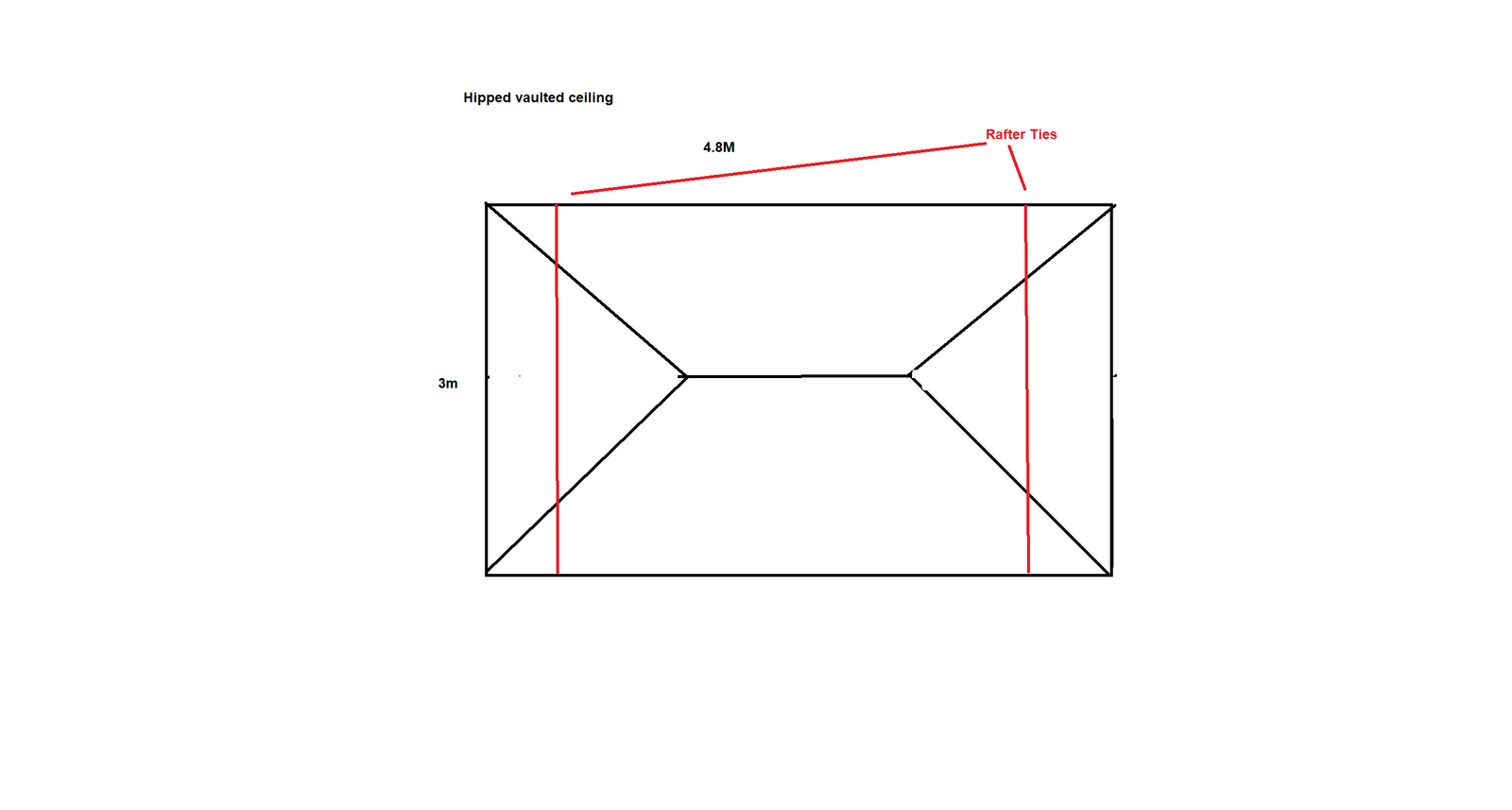

We are having a block built double skin garden room built. Its under 30sq meters so doesn't require building regs. Carpenters have said they can vault the ceiling no problem when building the roof structure, i would like this but am a bit worried about roof spread as the tiles are the heavy concrete ones.
Any idea if we could / should be adding rafter ties? I was thinking something like the below and leaving them exposed which would give us an area in the middle that's fully vaulted but would still tie the walls together? Or do we need them both ways? Any advice would be welcome! Thanks
Building is 4.8m x 3m.
Ask them how they will design it to resist the roof spreading.
It's probably possible over a 3m span, but your solution would see it spreading out in the middle.

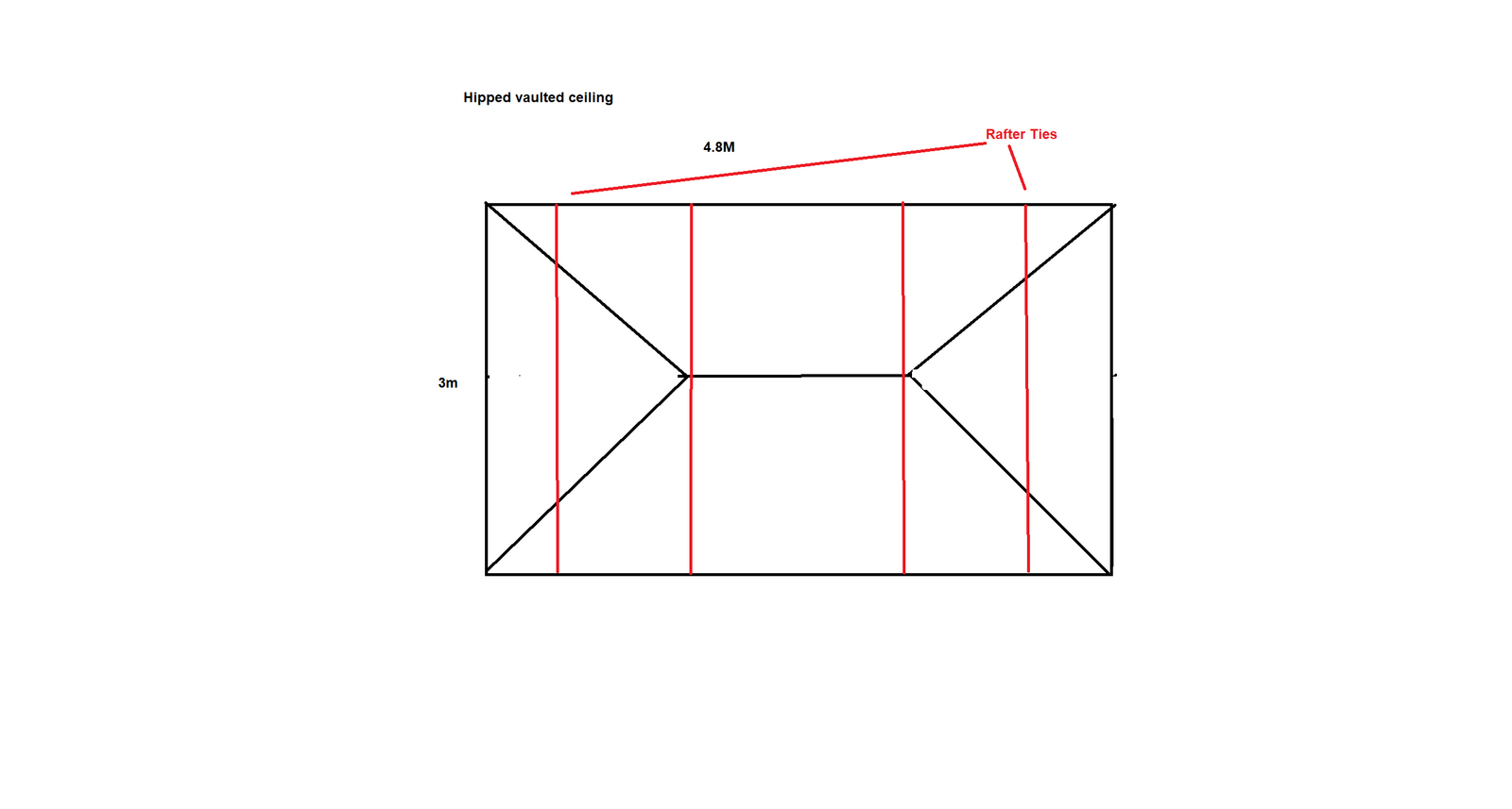

I wonder if we added more Rafter ties like the below and just left a slightly larger gap in the middle so we have some extra head height at that part (it's going to be a gym so wanted a bit of extra height in the middle)

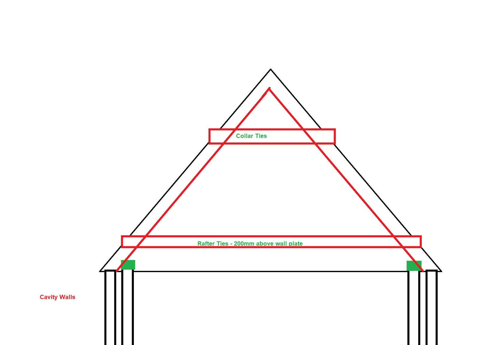

I have now spoken to the roof framer. He said the best bet to gain a small amount of extra headroom whilst keeping the structural integrity would be to have ceiling joists on every rafter as usual and collar ties but that he can lift the ceiling joists up 200mm above the wall plate giving us the additional head height we need. He is quite experienced and seems to think this would be more than sufficient to stop the walls spreading.
I hadn't really thought about what happens when you fully vault a roof and take away all the supports, but it makes a lot more sense now.
Excuse my very basic sketch.... Do you think this set up would work to stop any spread..... Rafters ties installed 200mm above the wall plate. Gives us a little extra headroom.
Overall height from wall plate to ridge is about 1.2M so this would be in the bottom 1/3 of the roof.
I was under the impression you could raise the ties up by a third without issue so I think you'll be fine with 200mm. You can get something called glide shoes which allow the rafters (or rather raised tie trusses) to move out a bit when loaded with roof, but won't be necessary.
Glide shoes won't work with birds-mouthed rafters, fixed to a WP.
