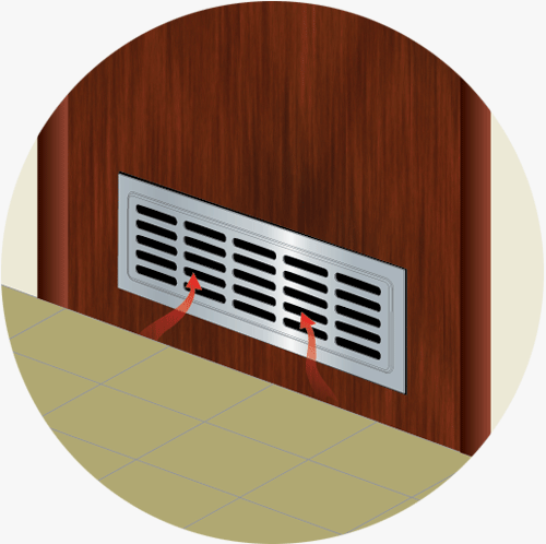

A fan can only work if there is a route for replacement air, and clearly you want dry air, so better if that air comes from outside, so best option is the heat recovery unit that way it does not cool the home as much and the replacement air is from outside where in the main it is cooler so the air is drier.
You can get vents to fit in the door 1684945171031.pngor of course make the door a bad fit, but some where air needs to come into the house to replace the air pumped outside with bathroom extractors, cooker hoods, and tumble dryers, and if you don't then it can draw in fumes from any open flue fire.
