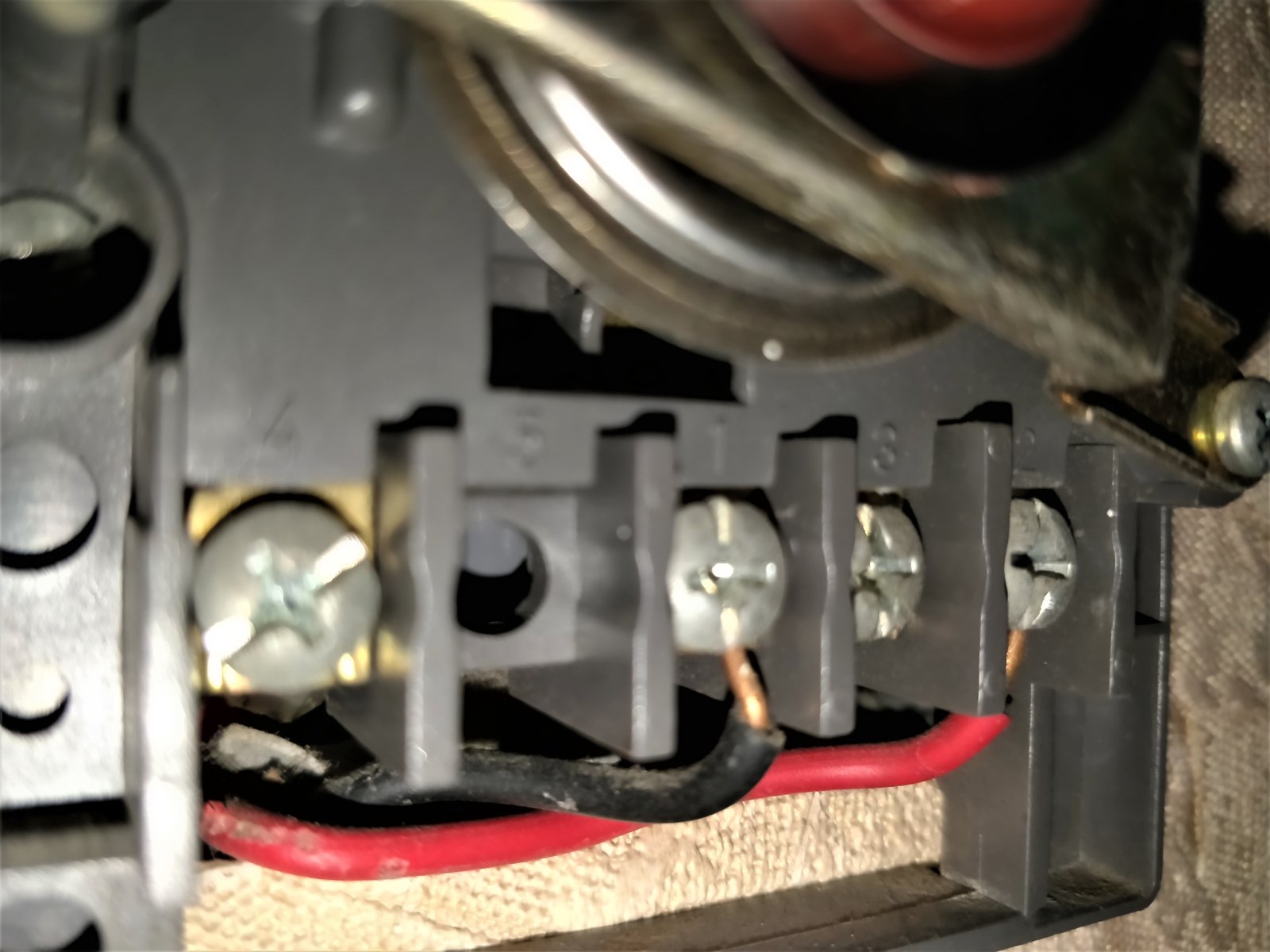

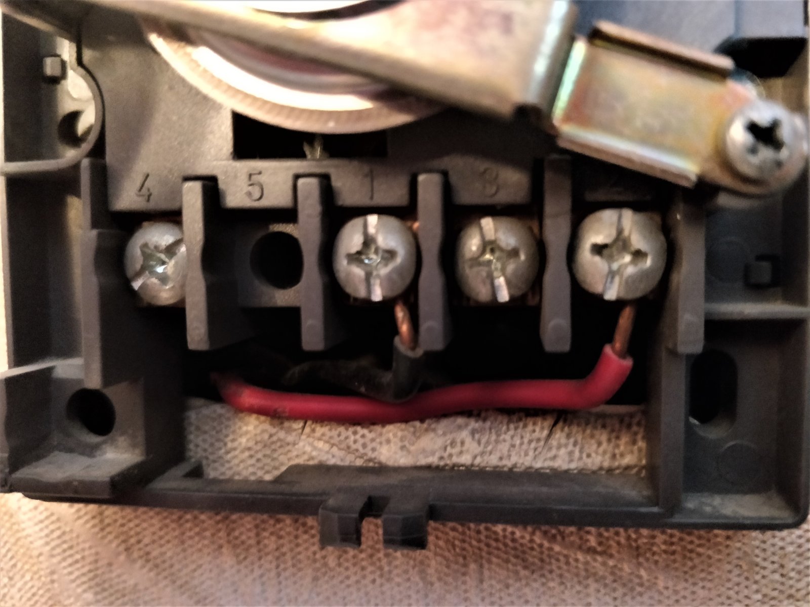

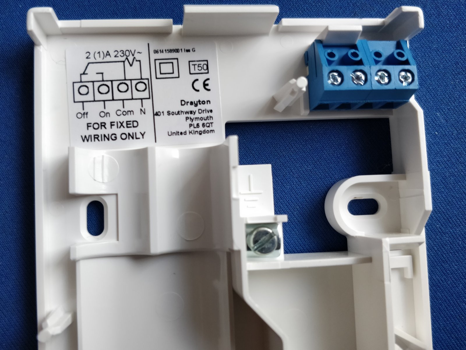

[/URL][/IMG] Guys can someone advise how i should rewire the new room thermostat please, the first two photos are the old thermostat. thanks in advance.
The stat you have bought needs one more wire than you have.
Try the Honeywell DT90 as Gordongas advised.
you can use the one you have, black and red from existing stat into com and on in new stat, a neutral is only needed for the energy saving models
