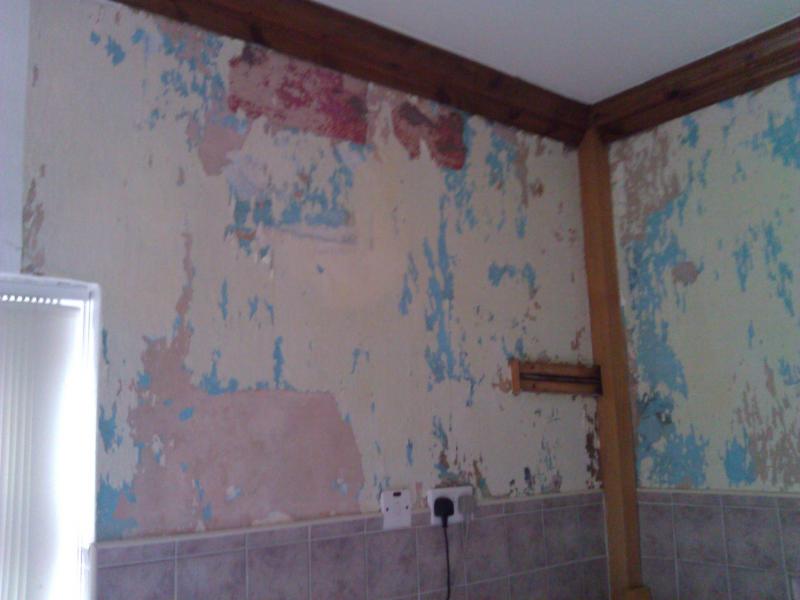

I have just stripped textured wallpaper from one wall of my kitchen. The resulting surface is awful - cant paint it, dont want to wallpaper it.
The wall I've exposed is all over the place. In one corner its an inch out at the top! Despite it being an outside wall and the outside is plumb! And its a solid 9 inch wall! So there must be an inch more plaster at the bottom of the wall.
Is there any alternative to skimming it that is quick and easy? How hard is skimming really? I just watched a couple of videos on youtube and it doesnt seem very hard. But I know there's a skill to it.
I also dont want to loose any space in the room. So extra layers of board etc are not an option, and I dont want to take it back to brick if I can avoid it - the plaster is stable. Any ideas?

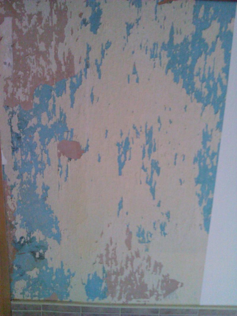

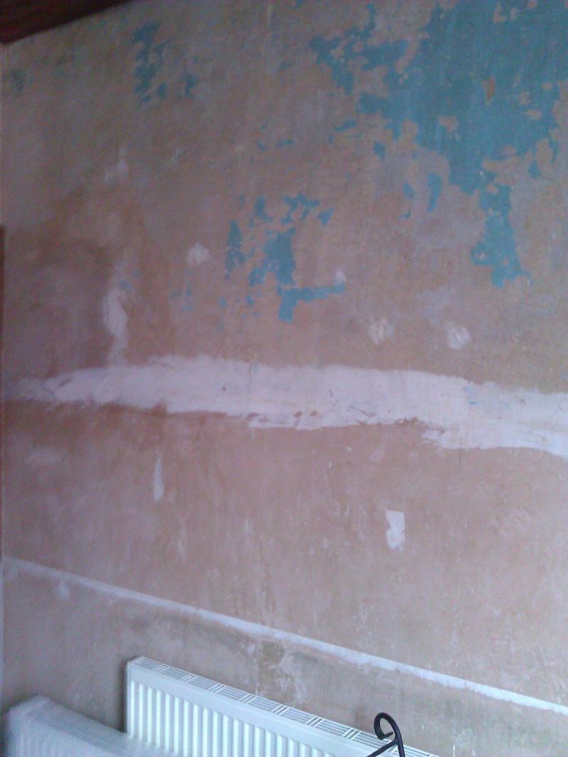

Given that RichardC, and the fact I've just stripped a load more wallpaper and found similar and worse plaster, im rethinking the situation (I tend to overthink). The plaster seems to have been layered on in this place. Some of the paper fetched off a top layer of plaster which revealed beautifully smooth plaster! But other areas are dead, with those awful colours on them you find in old houses, and others are just bare rough plaster.
IMO planning well is everything.

If all the plaster has to come off, I normally advocate a new float/set/skim as original; in an old house, it’s doing a proper job really. Given you may have reasons for dot & dab & time constraints, does all the original plaster need to come off? If it’s basically sound & well bonded then why not just overboard or at least those walls that will accept it. You can even pop some mechanical fixings through the boards (& the dabs) if the over skim has any local bonding issues.
