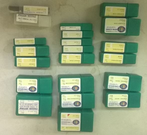

You could get some ideas here. Other firms do similar stuff. TBH A lot of my cutters (possibly 60 to 70%) are Wealdens and they always come in little individual green polythene boxed - so I stuff a bit of oiled cotton wool or rag in the bottom and leaave the cutters in in the boxes. It saves them from a lot of damage and re-oiling a couple of times a year with a few drops if 3-in-1 keeps them from going rusty, even in the van

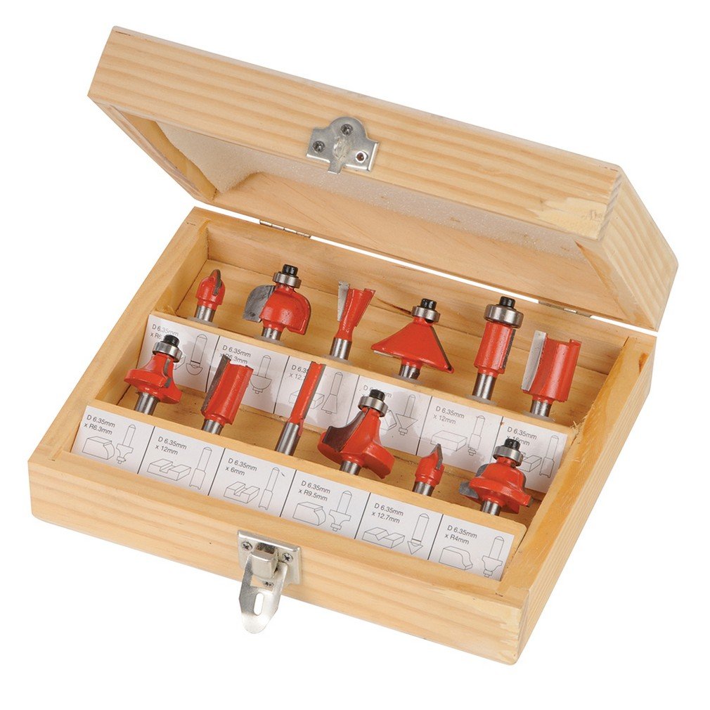

I would suggest you get a very cheap set of bits and use them to learn with. Once they're knackered you can throw them away or use them for rough work, by which point you will have figured out what expensive bits you actually need.
http://www.ebay.co.uk/itm/NEW-12PC-...hash=item51b7c1e336:m:mF7RH2AEedMSm8aLuONt5EA
(I have two sets of these, one that I use for rough, one that is newer that I use for cleaner cuts and harder wood. Once they start to dull I will buy yet another set, and so on. They're so cheap they're disposable.)

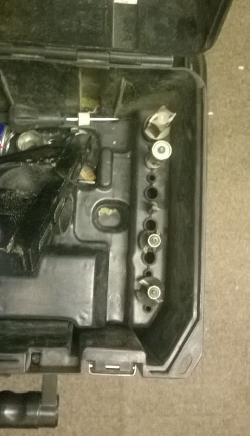

Just to further confuse you, here's a photo of the end of the deWalt DW622 tool box (supplied with the tool) showing the tool storage facility of the box (the DW625 doesn't have this AFAIK):
The box allows me to carry 6 each 1/2in shank, 8mm shank and 1/4in shank cutters with the router (plus the fence, rods, fine depth adjuster, two spare collets, 4 x guide bushes, one or two extra cutters in boxes, two wrenches and a screwdriver) - in theory - in reality it's nearer 6 to 8 cutters that can be accommodated without the carbide touching. And here below are a few of my Wealden cutters, almost all bought for specific tasks rather than for general use:
Those green poly boxes are actually quite durable and I'm happy with the level of protection they offer. Just as well considering the value of that lot
