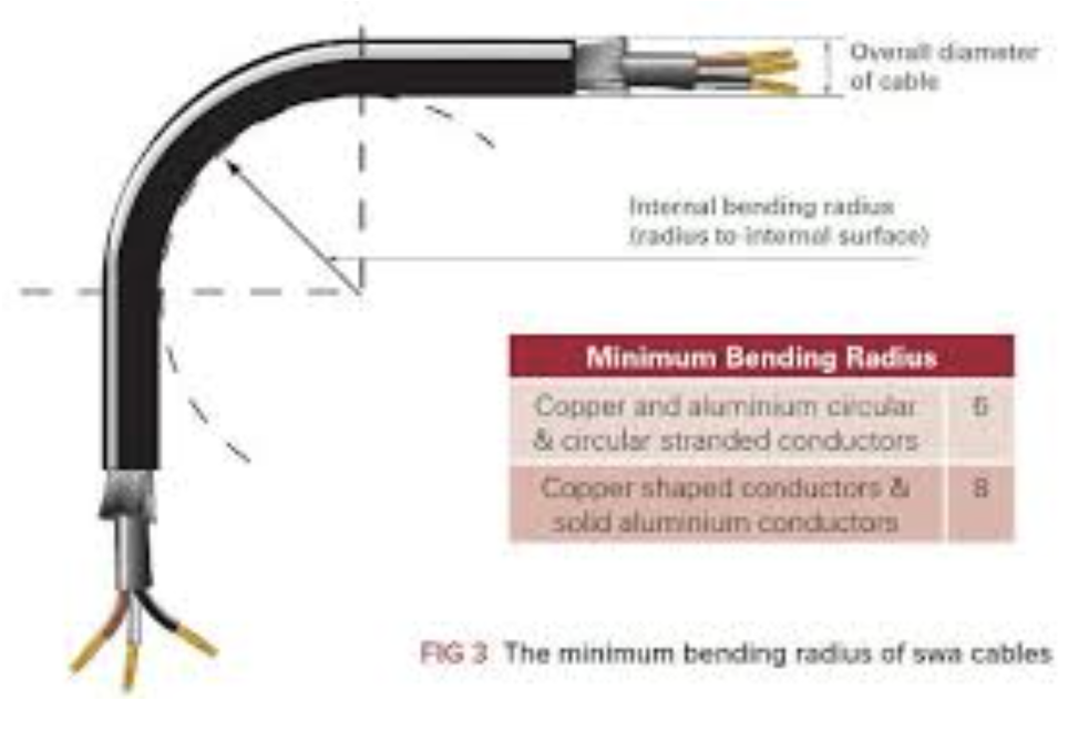

The issue with SWA is it isnt very bendy. Most SWA is underground, comes vertically up a wall and needs to turn 90° to go through the wall.
If you try and do it as a single run you'll always have a big loop sticking out from the wall.
Unfortunately, this situation makes an unbroken run a bit of an issue.

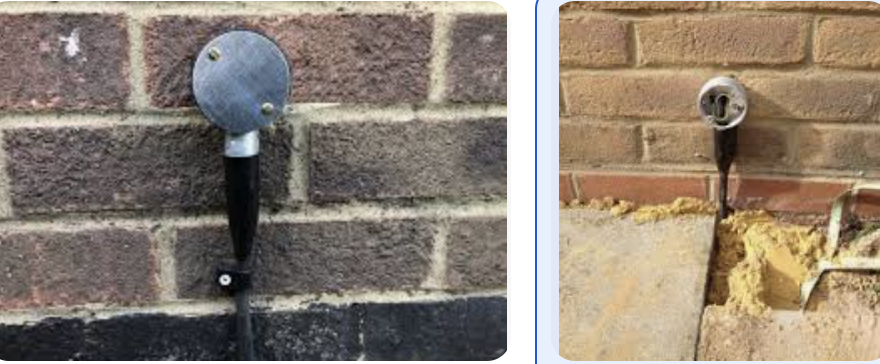

Here's the way I've done the throught the wall trick, but it often needs a junction - inside is best.
But, really, as above.
