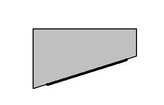

What I should have added above is that the opposite end of the panels will all have normal square edges. Hence I would cut the bevel on one end leaving plenty of green at the other. Once the bevel was cut I would then trim the other end with a normal straight cutter. This image shows the shape of the cabinet viewed from the top, the heavy line is where the doors are. [/img]
Thats a strange looking cabinet. Doors underneath?
No, its a view from above, a plan view. Sorry if it wasn't clear. Its basically just a simple cabinet but narrower at one end than the other. It is going to be made of pine.
Yes you could do it with a rail guide, infact thats probably the better method given that they are panels which would be hard to keep flat on the average router table.
