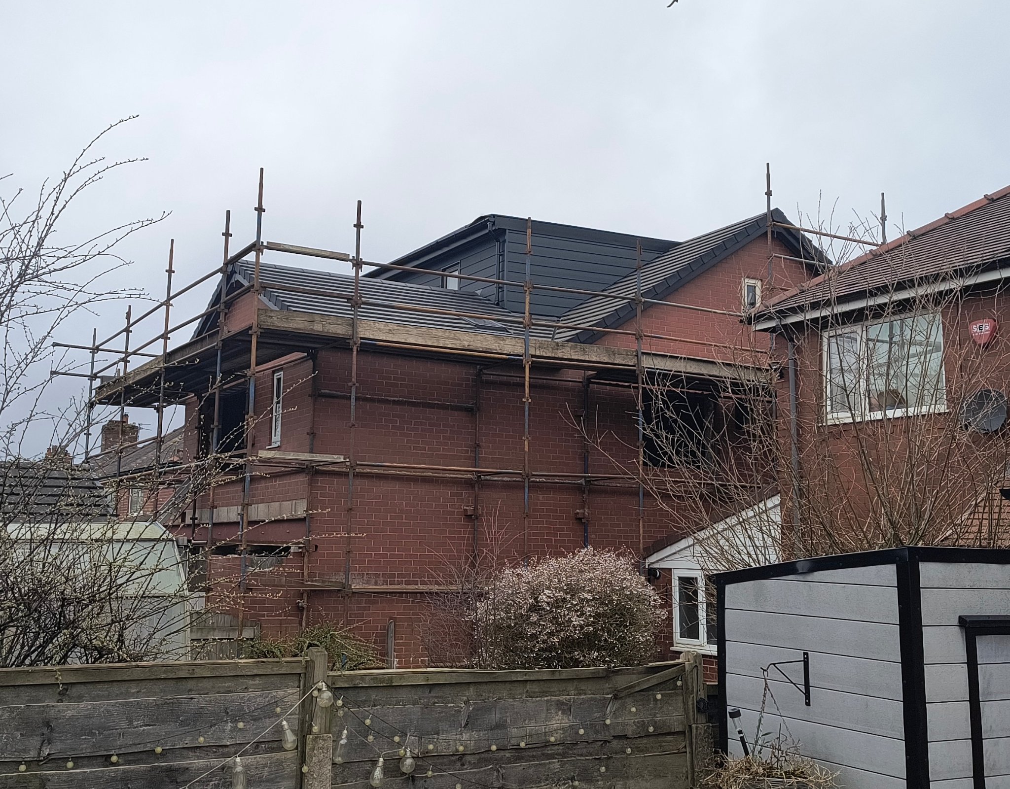

So I reckon I can get it around back after looking about rolling it on small poles.
Where i think its going to be a problem is getting it in place.
The single story extension still needs scaffold as my garden runs down so at the moment the floor level at the furthest point is like 1.2m high
So I am mot sure I can get those lifts genie close enough

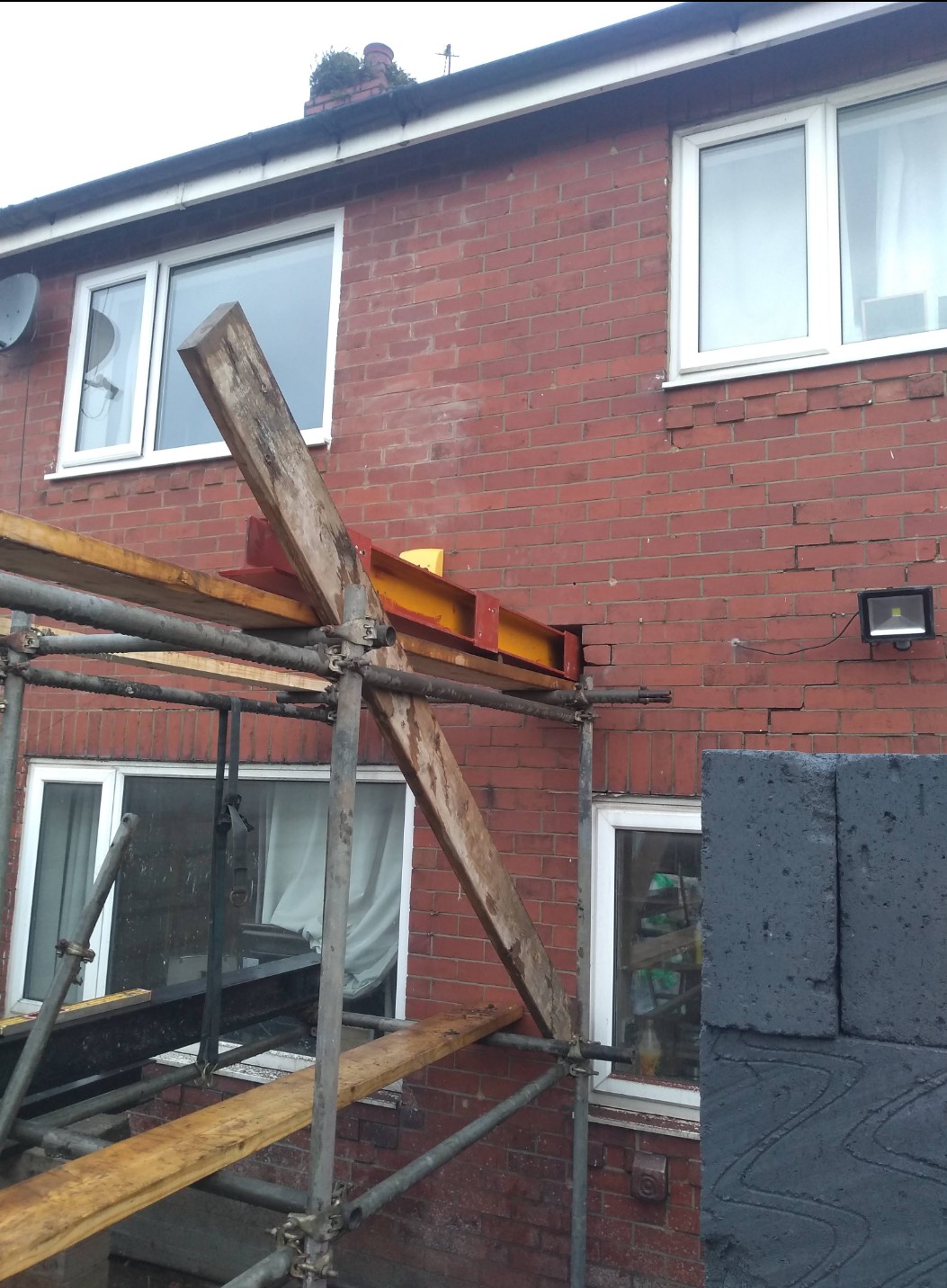

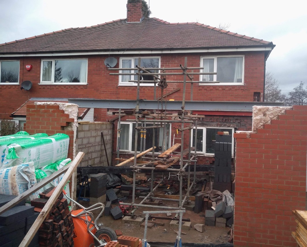

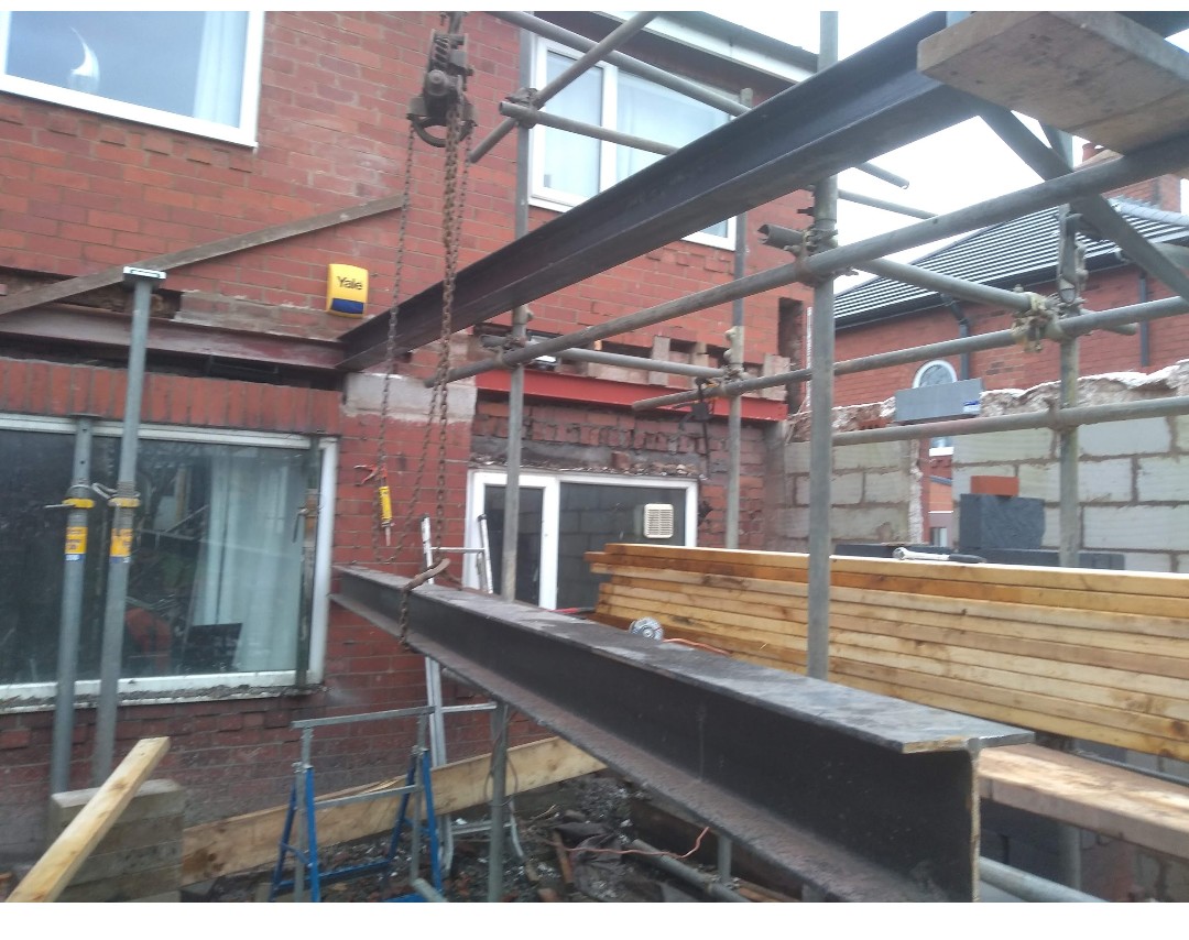

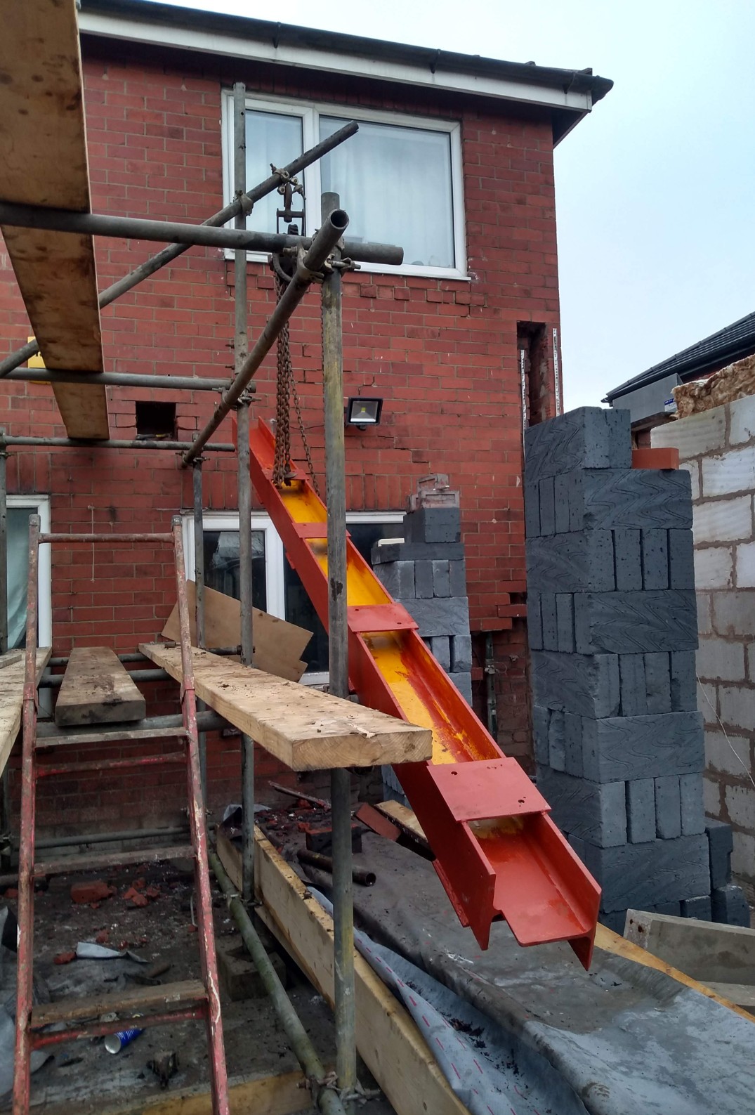

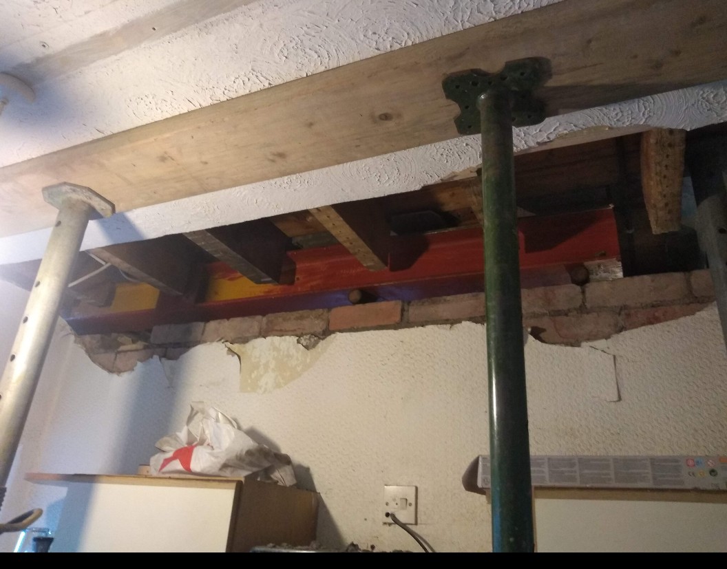

I put mine in by myself. The smallest ones just on the rungs of a ladder. The big ones I built a small tower of scaffold and hoisted them up with my block and tackle. The big grey one was over 300kg.
The hardest one was this one, I literally rolled it through that little hole in the wall and along the top of the internal wall.
Obviously they will maim you if they fall so great care is required.
