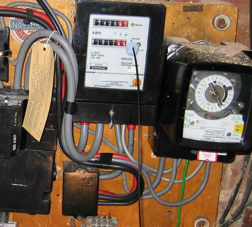

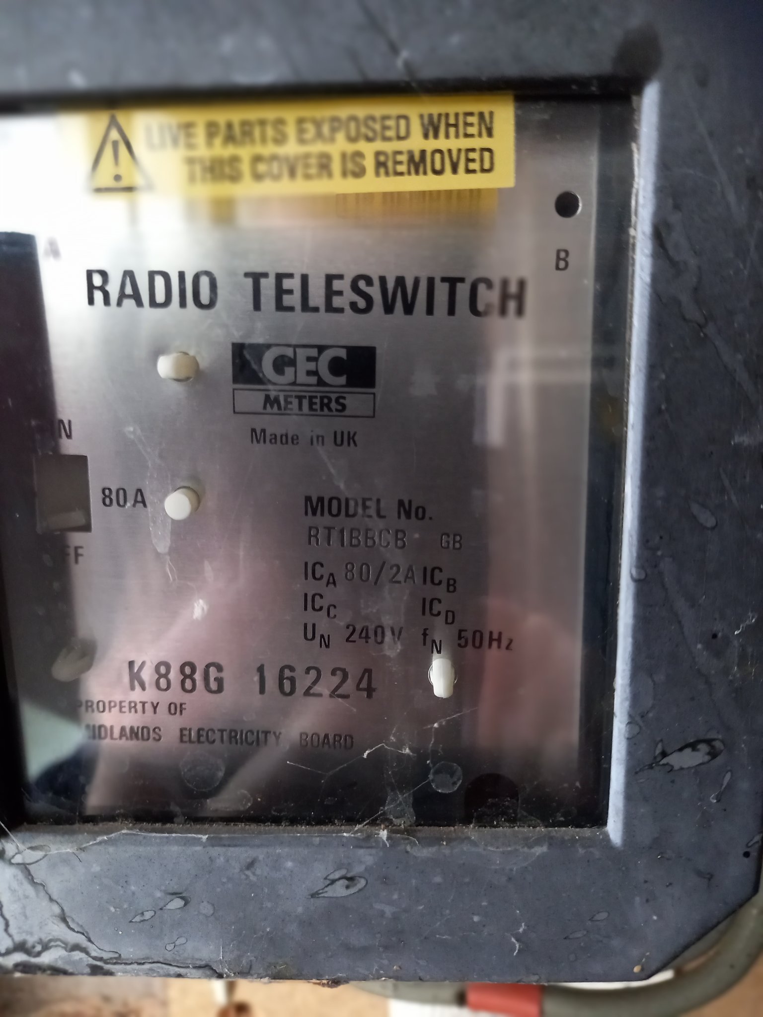

I read that, nothing personal in not replying before! I suppose that could be it but it seems unlikely. If it's a battery it must be a good one, even if the mains keeps it charged. The RTS has probably been there since the house was built in 1963, I've been here over 27 tears. A couple of pics of the RTS attached. Be interesting to hear what your mate has to say.

There are still loads of mechanical time switches still in service running off peak systems, as Andy says accounts won't know who should still have a working E7 plan
Not all E7 systems use RTS, some are purely controlled by a mechanical time switch, such as this one
