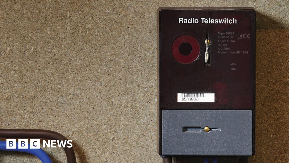

Well, we are after the switch off deadline, and my lights, fridge, and computer are still working. That will do me for now. I will get the meter changed in a couple of months when I am less entangled with things. I assume I am now on peak rate 24/7. Low rate should be handy since I have to keep the fan on all night to get some breeze.

It has already been said, the switch off has been canalled/delayed, we don't know now when it will happen, likely coldest day of the year, giving no time for anyone to do anything to avoid getting cold.
The problem is, there is no standard way for the teleswitch to work, with some it just changes the meter reading, with other it turns a supply on/off as well. Leaving the occupants with no heating, until some rewiring is done.
The old Wylex fuseboxes were only rated at 60 amp, which is enough for either general home use, or storage radiators, but to combine them both, could cause problems, and it is likely those with the old fuse boxes who are the most vulnerable, and also less likely to see TV adverts, or other information stuff, and will be left without heating.

Been extended, yet again, and will be a phased (controlled) switch off, anyway from now... watch that space...
https://www.ofgem.gov.uk/publications/radio-teleswitch-service-rts-shutdown-campaign-toolkit may be worth a read (I haven't, yet).
https://www.energy-uk.org.uk/custom...tch-service-switch-off-what-you-need-to-know/ as well.
