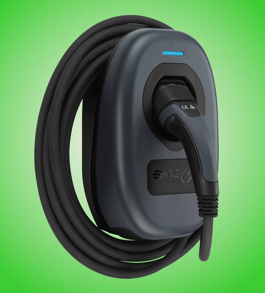

The more usual option there would be to attach it to the wall of the garage. Most have a 5m or more tethered flex attached, which will easily reach to either of the parking spaces for when charging is required.
I put the cable that goes between box and car through its own little tunnel under the walkway
No. The cable between the car and the EVSE is only there when the vehicle is plugged in. It's stored on the EVSE the rest of the time.
This is a typical example:
When charging is required you unwind as much cable as needed and plug into the car.
When the car is not there or does not need charging the cable is coiled away.

No, as it's not suitable for concealing underground.
I would need to detach the plug,
That won't be happening, as the wires are permanently crimped into the plug contacts.
