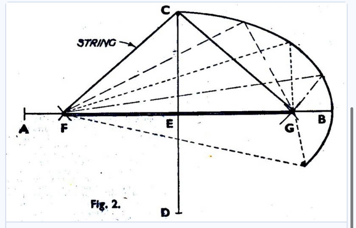

I’m planning on laying a block paving drive soon, and then a garden wall.
Both require curved walls / edging, but how do you mark out with sting line for the curves.
I’ve done a bit of reading and I’ve seen this example using lots of strings/measurements
Is that kind of thing the best way or am I missing a trick?
The garden wall will follow the curve of the pavement so I’m not so worried about that one, but the edging kerbs for the driveway are completely new, so I’d like to get the curves right at the same time as getting the fall right for the driveway.

Ideally you set the border to line and level and this acts as a guide for the paving plus it restrains the paving when it's whacked.
However there is nothing to stop you laying the paving and then either keeping it short of the edge, or taking it past the edge and then marking the edge.
The key thing is to allow for the depth the paving will whack down (depending on your bedding method) when laying the edge, and not to whack the paving until the edge is set.

Look like expensive fibreglass tent poles, Go outdoors sell sets 4.5m ish for about £6 a set, you could use these, iv'e used plastic trim in the past.
Good point!
I’ve got a load of spare 5m upvc window trims so I could use them and some duck tape to the same effect :)
