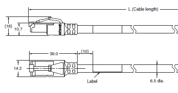

Depends what you call huge.
If these dimensions are correct:
Then:

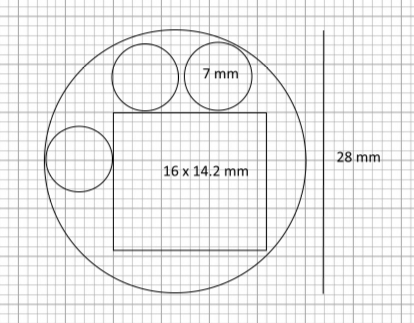

I have used 7mm. for 6.5 for a bit of leeway.
Looks like there would be enough room for a 20mm hole at the sides (where the very very badly drawn circles are!!!)

FWIW I've just run 3 cat 5s (Not cat 6) with plugs through a 20mm lightweight plactic conduit. These are the basic plugs without any fancy boots etc and it required very carefull positioning/controlling.
