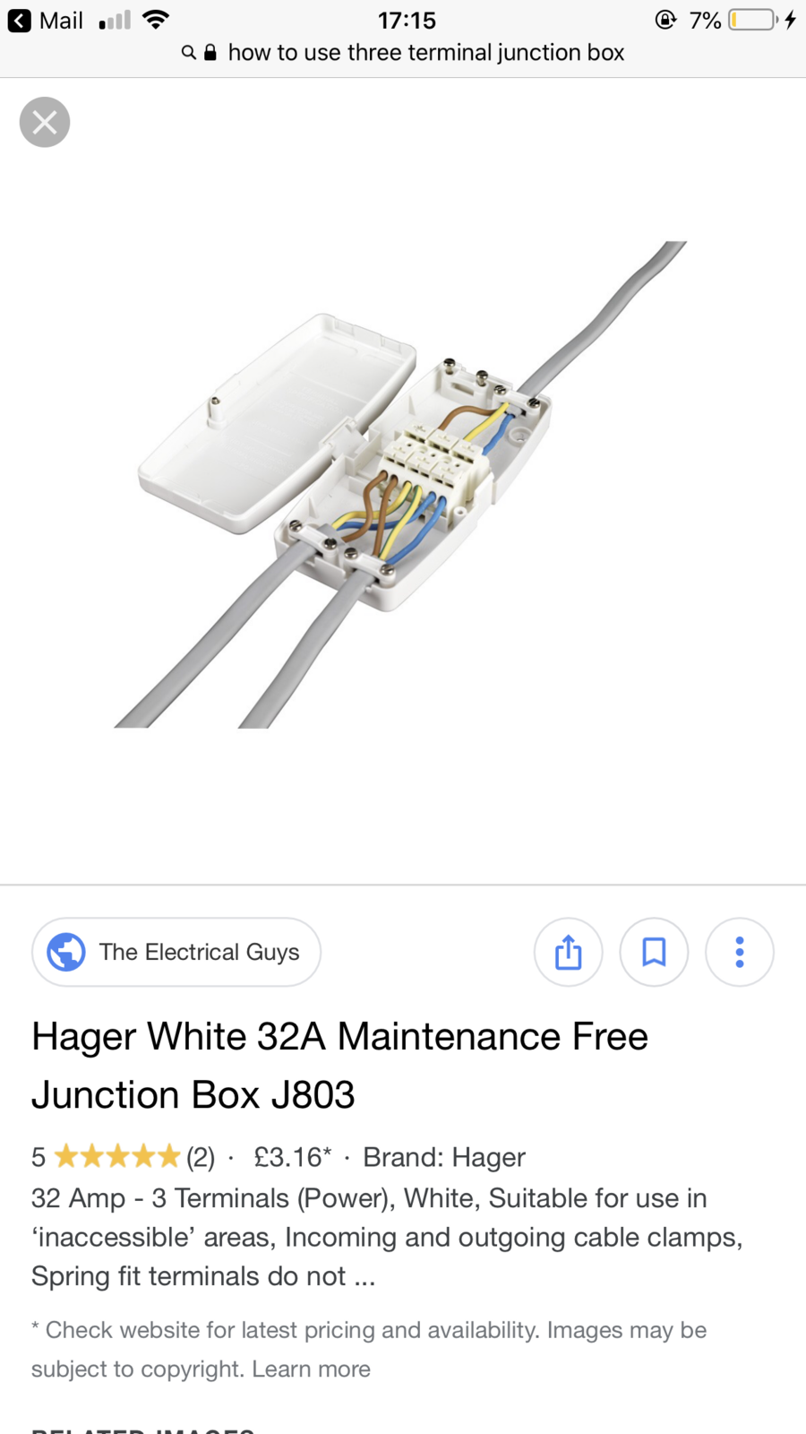

Helll I have a workshop out in the garden and spare electric sockets are in short supply..!
My lights run off a plug they are led 45w lights and I have two of them each wired to a 5amp plug.
This means sacrificing 2 out of 3 plug sockets just to have lighting. The lights cannot be daisy chained as the wiring is built in.
Is there anyway of joining the cables so that they run off one plug?

Most likely the "plug" is a low-voltage power supply unit, so you can't cut into it and add more wires.
The multiway adaptor is a much better idea.

As to the lights i'd probablly use something like https://www.amazon.co.uk/Ashley-J804-Maintenance-Terminal-Junction/dp/B00BATALN6 to join the flexes from the lights to each other and to an incoming flex that could be plugged in.

@plugwash the link you sent there was a similar item listed this is what I was thinking of so where the two cables come in that would be the two lights, and the one coming out would be the wire to the plug would that work? I’ve used these boxes to make single cables longer but never with two cables?
Either the J803 or the J804 will work fine. The J804 has an extra terminal group (which is useful if you ever want to add a cable going off to a switch), the J803 has a higher current rating (but both have a higher current rating than a normal domestic plug).
Doesn't matter which flex comes in where, just connect all the lives together, all the neutrals together and all the earths together.
