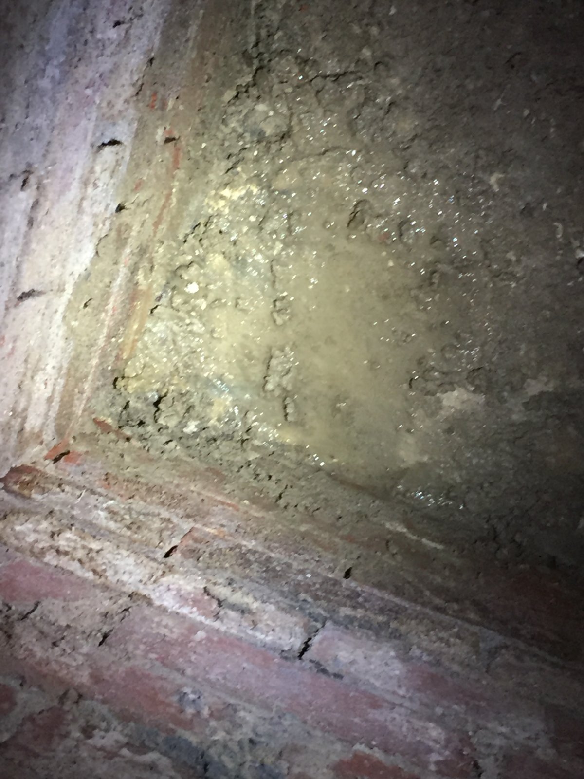

On fitting a new rad in the hall for my daughter I found that the floor joists had gone rotten so I started to replace but noticed that the floor of the void which was covered in mud was quite damp. The void is about 4' to 5' deep at that point which is considerably lower than the side driveway and the front of the house.
Today I've just been down there and cleared the 1" or so of rubble and mud which appears to be on a concreted oversite, back from the side wall for a foot or so to see what was going on and found that water was running in from the outside at the very bottom.
The area the house is located in is referred to as a 'Spa' so we've always been led to believe that there are underground springs somewhere. The ground is also solid clay from about 9" from the surface.
This water is causing a massive condensation problem in the house and the weather is not really cold yet.
I can see that there are not enough airbricks fitted but until the water can be stopped from getting into the void this appears futile at the moment.
Any ideas on how to cure running water getting into the underfloor void?
Some pics of the water puddle.

The water is not ideal but with sufficient ventilation and damp proof course that's intact it shouldn't cause a problem directly.
The fundamental solution is to ensure the ground level outside is lower, but that ship may have sailed already. But do make sure any drains are not leaking and all paving slopes away from the house and is drained if it ends up too close.
Have you checked with the neighbours to find out if it really is a high water table?
The final solution would be to remove the floor timbers,replace the sleeper wall doc with modern plastic put hardcore, DPM and concrete to weigh it down in the floor void, and improve the ventilation.
Even that could be risky in case it builds up underneath and starts making the house walls damp.

You may need a ground test to see if this is high water table or a spring. After having the supply and waste pipes checked for leaks.
A sump pump may be needed if the condensation can't be controlled via air bricks.
IF, you were to fit a dpc in the void, it would have to be done below any wood, or they would eventually rot. Better to do the checks first to find where the waters coming in, then decide on the course of action from there.

Any hardsurfaces outside that run back to the house walls without suitable drainage will aggrevate or maybe even cause your problem. Blocked drainage is a serious issue and needs to be resolved, that can include a CCTV of drains to make sure they are not broken and leaking elsewhere. Adding dyes to water in the drains can sometimes reveal if water elsewhere is coming from the drains, however unlikely to help if the leak is minor. Certainly check the void after heavy rainfall.
The lying water has almost gone today and the water when it was puddling was clear and not smelly which doesn't suggest a drainage blockage. There's no rain forecast for the next few days so will keep an eye on it to see what happens.
Thinking of digging a hole in the front garden by the bat window to see if we can get an idea on the water table. It might be that a french drain across the front wall and round and down the side might be the answer.
Just discovered that the house across the road had french drains put in across their back garden to divert water away from the foundations when they had a rear extension built. The ground level runs downhill from this property toward our property so am going to contact the Surveyor who worked on the project to find out what he discovered.
