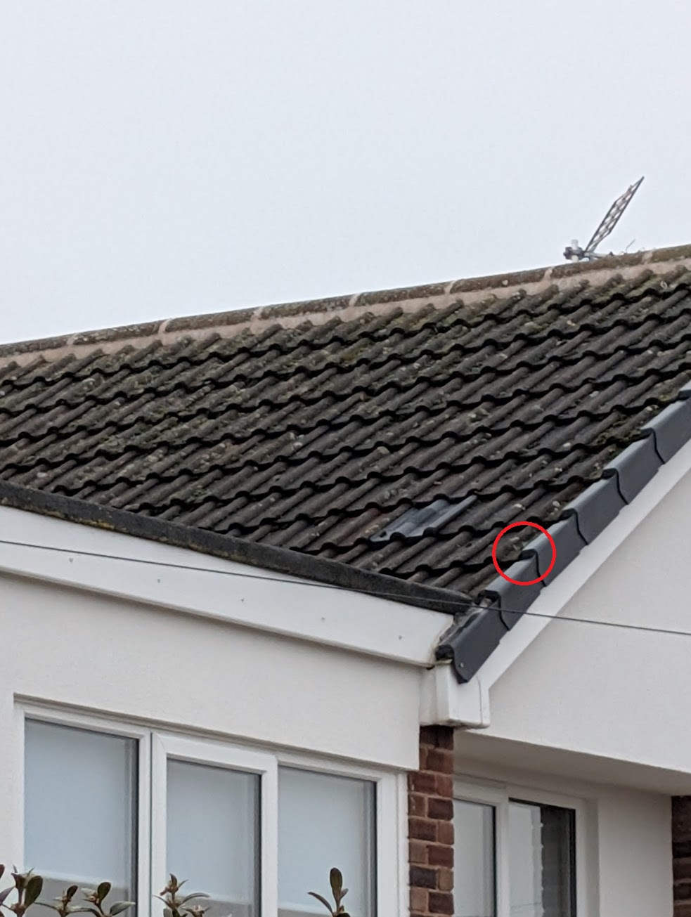

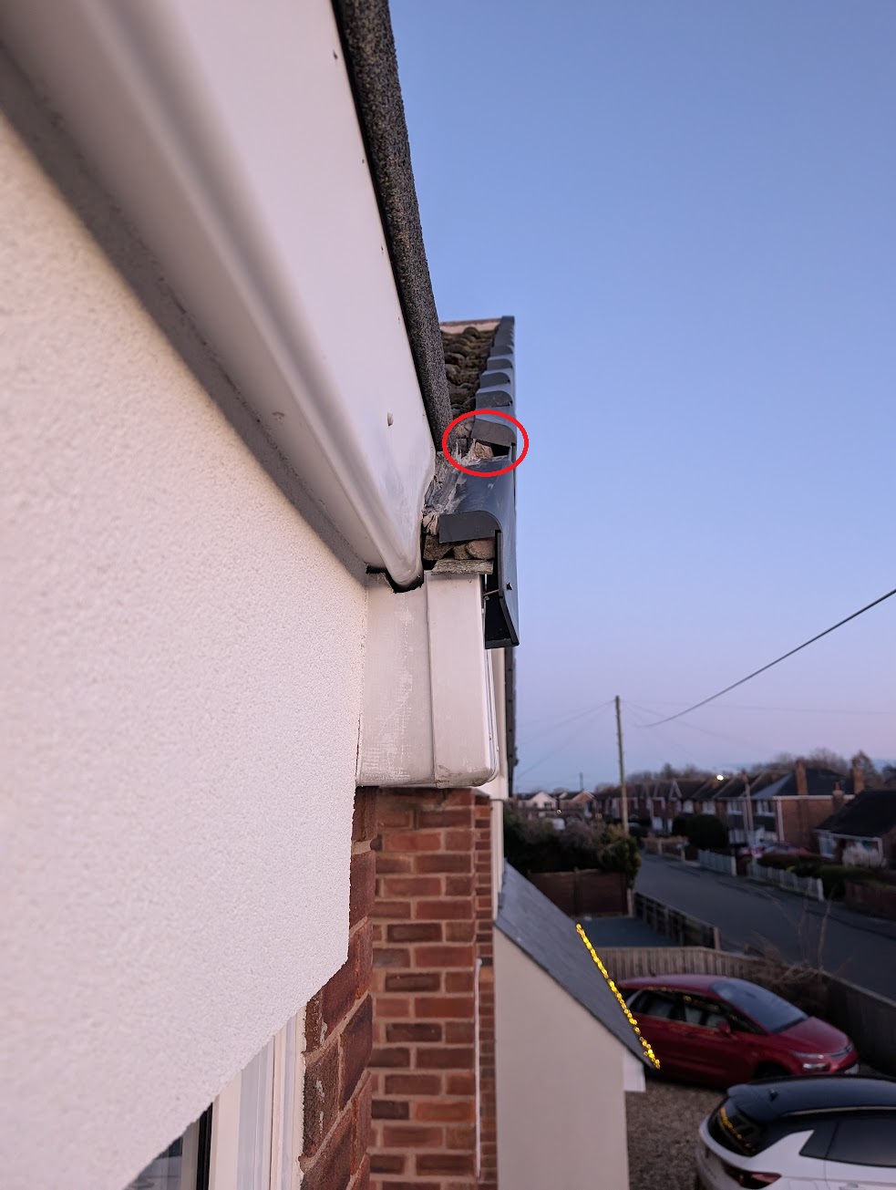

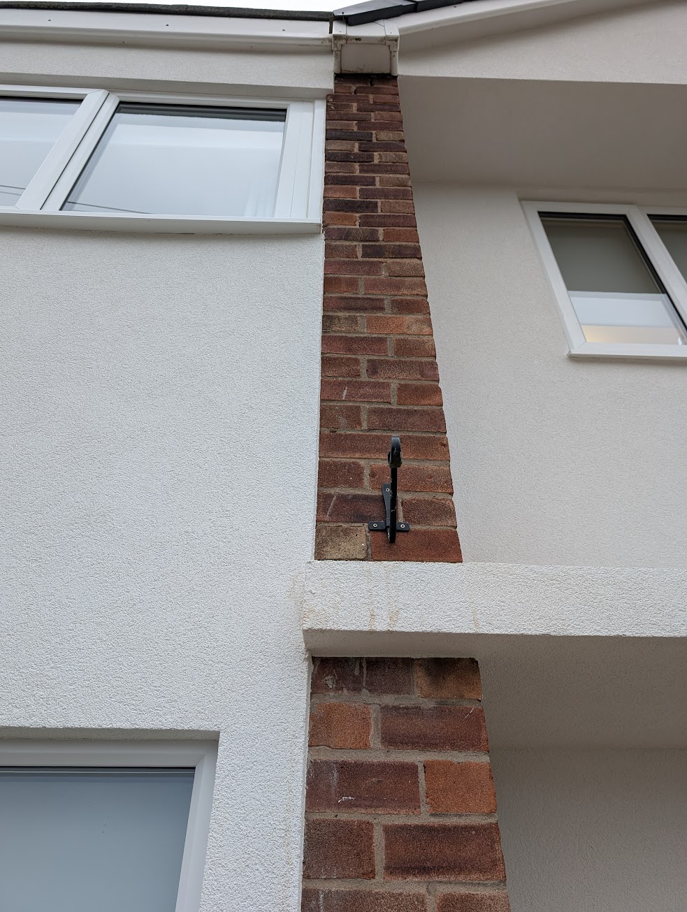

We had the front of our house fitted with dry verge about a month ago, after we had the front rendered in the autumn, to tie everything in a bit and neaten it up. Earlier this week I noticed that there is a rusty coloured water dripping from the fascia board end where the dry verge ends. It's dripping onto the porch overhang and staining the new render...

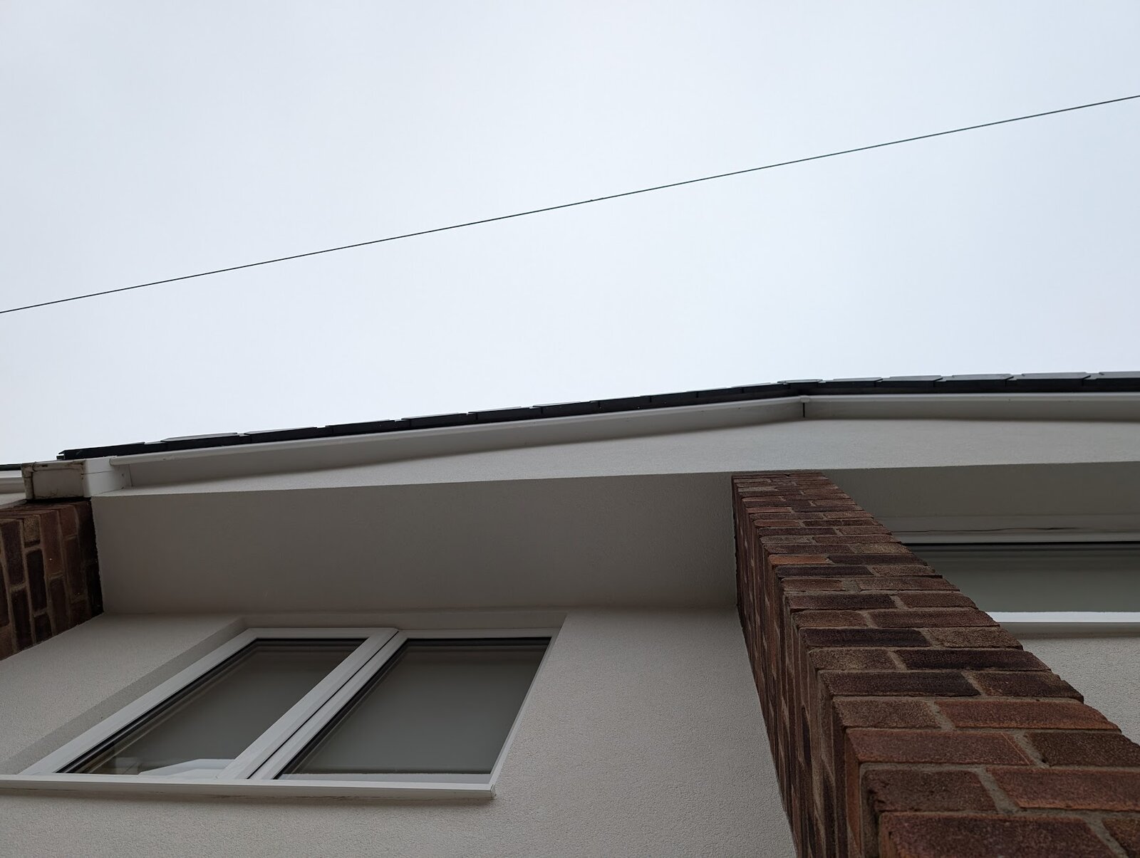

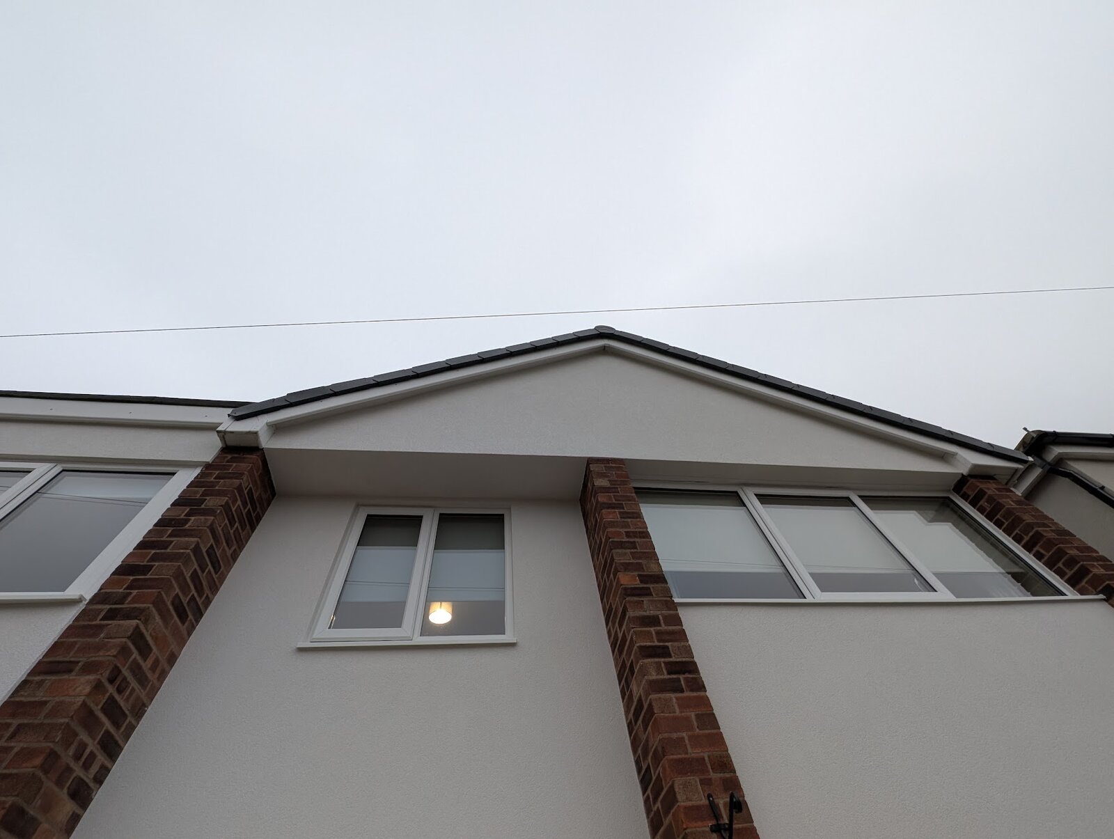

We didn't have any water dripping problems for the few months where the render was done before the verge caps so I am assuming that something in the installation is now causing water to collect and drip (whilst also collecting something rusty/orange along the way). I noticed today that the caps from the underside start contouring towards the fascia about midway down the left side before then fitting tight to it on the last 3 caps. This isn't the case on the right side where it's more uniform.
What could be the exact cause of this problem and how can it be fixed please? Even if the answer is that verge caps aren't recommended given the flat roof extension then I would rather that than this problem!
Pre-work:
The day after (when I noticed and questioned the exposed screw at the end):
Now:
Photos from underside:
