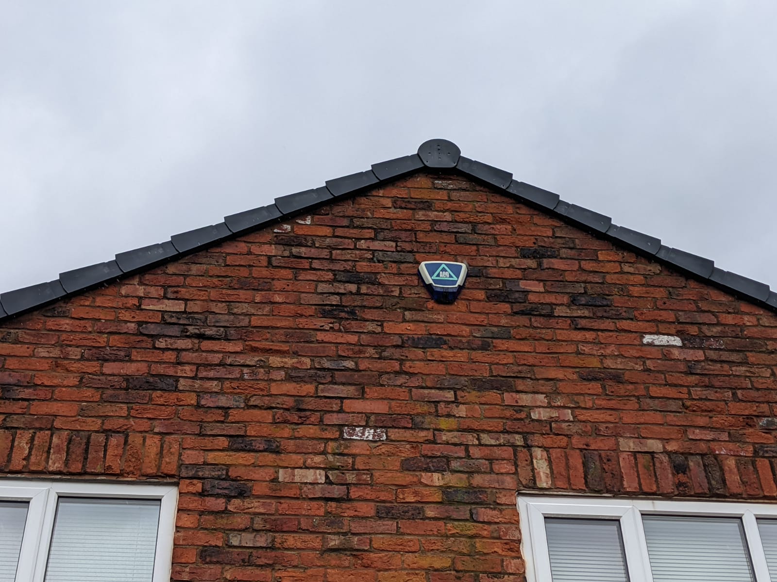

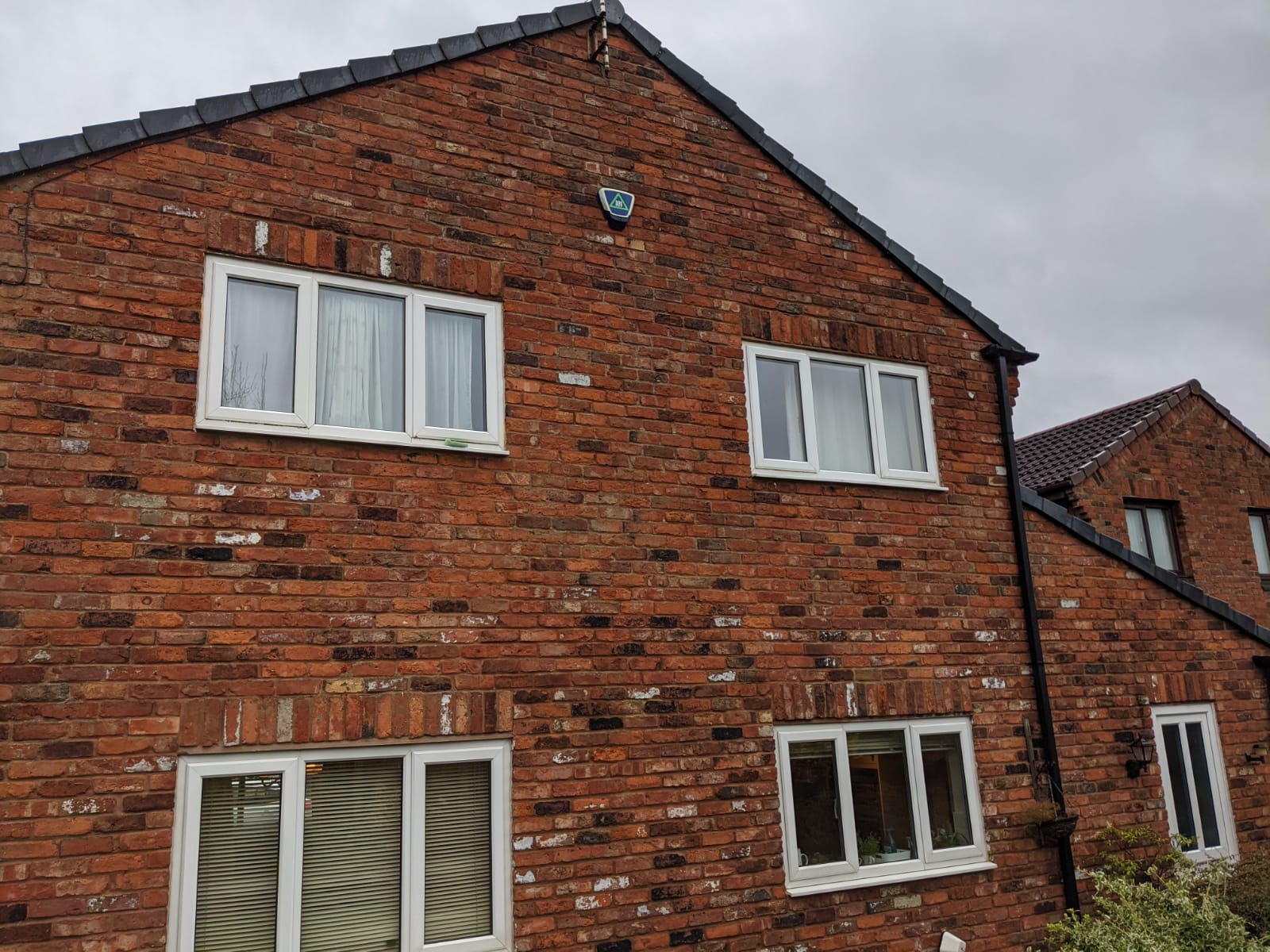

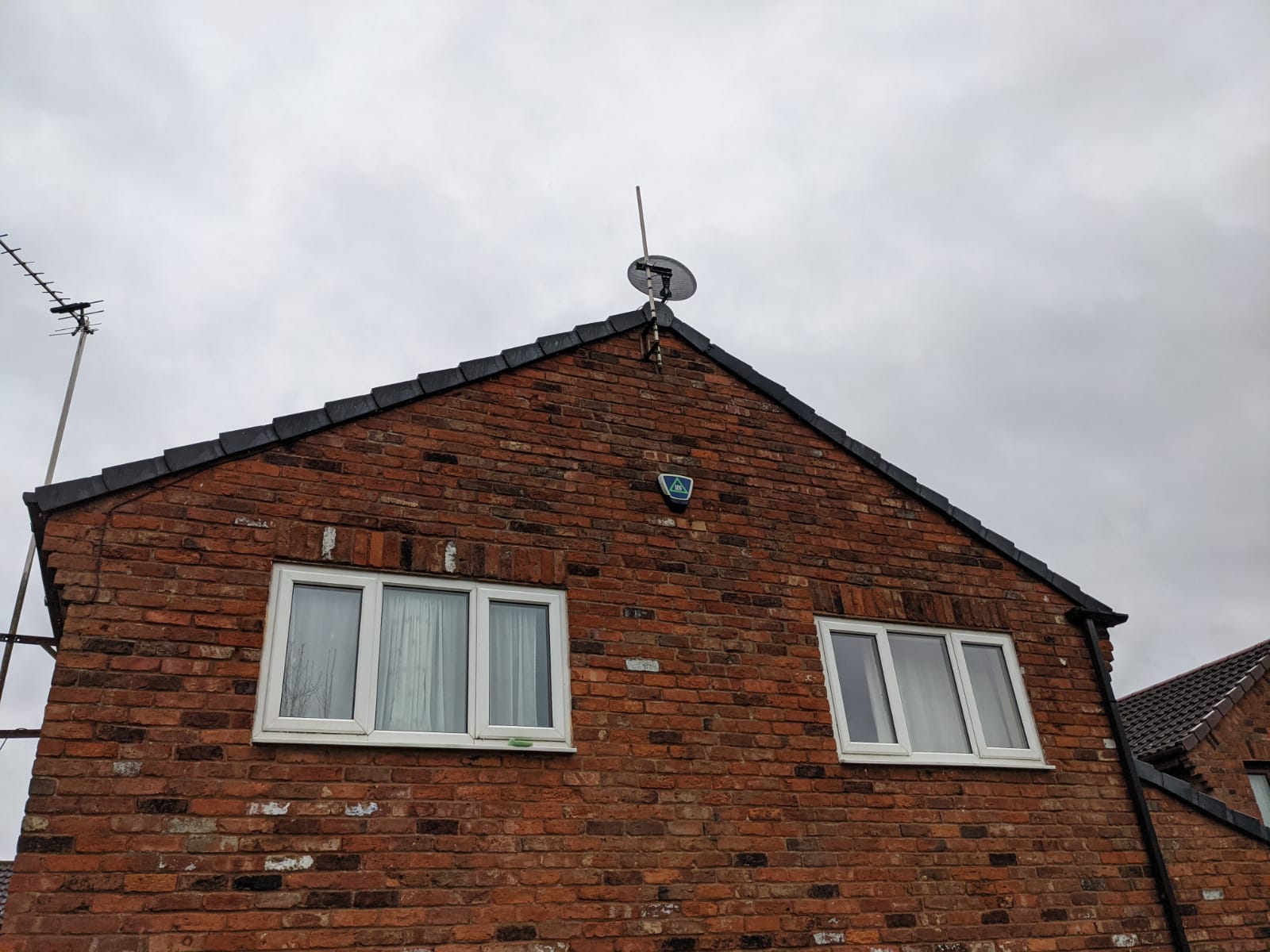

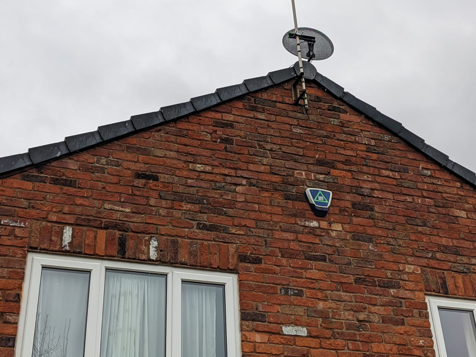

Thanks so much for your response. I've added some pictures below.
Do people often replace a dry verge with something else, are there any other options other than the segments of plastic?

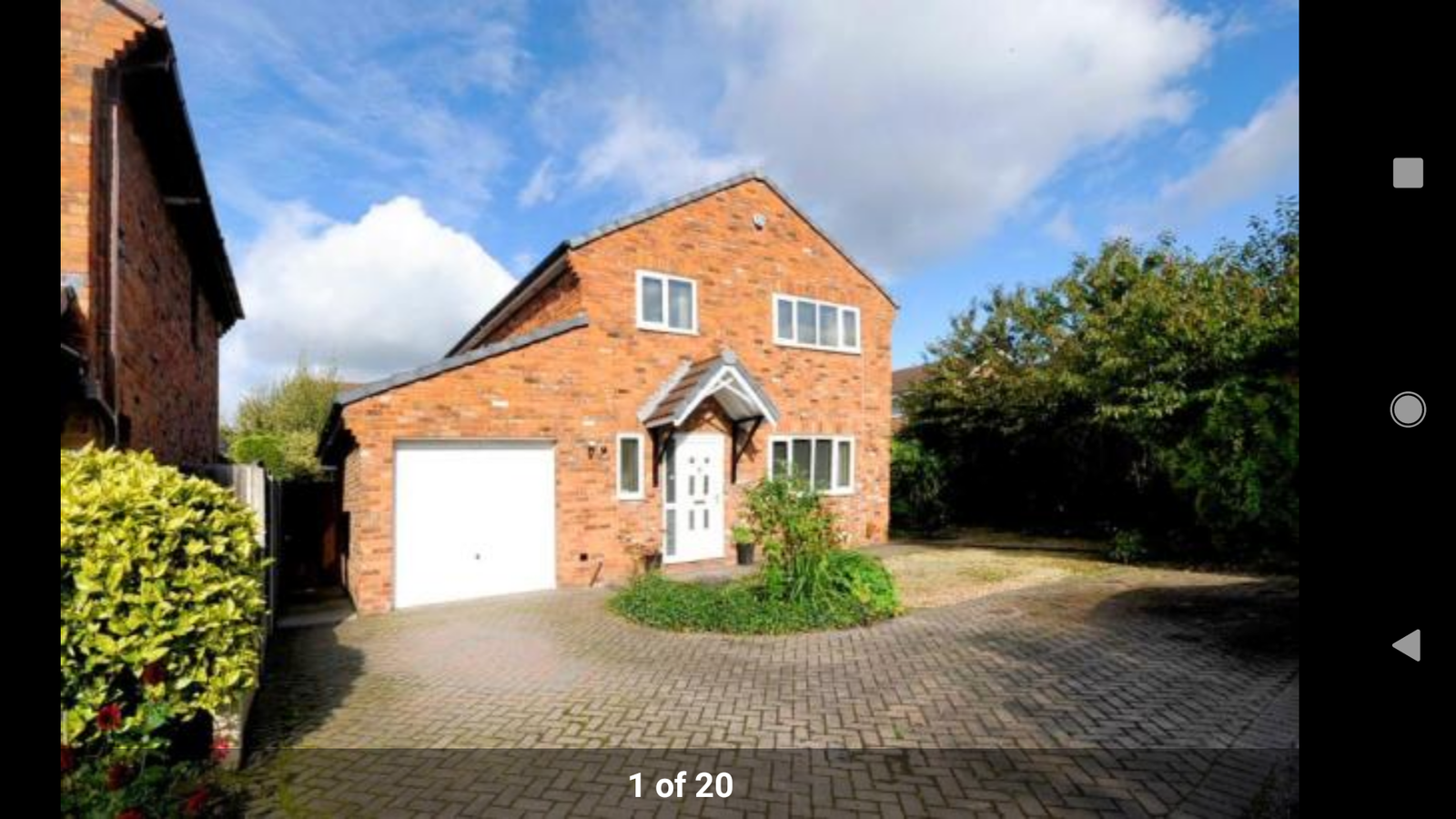

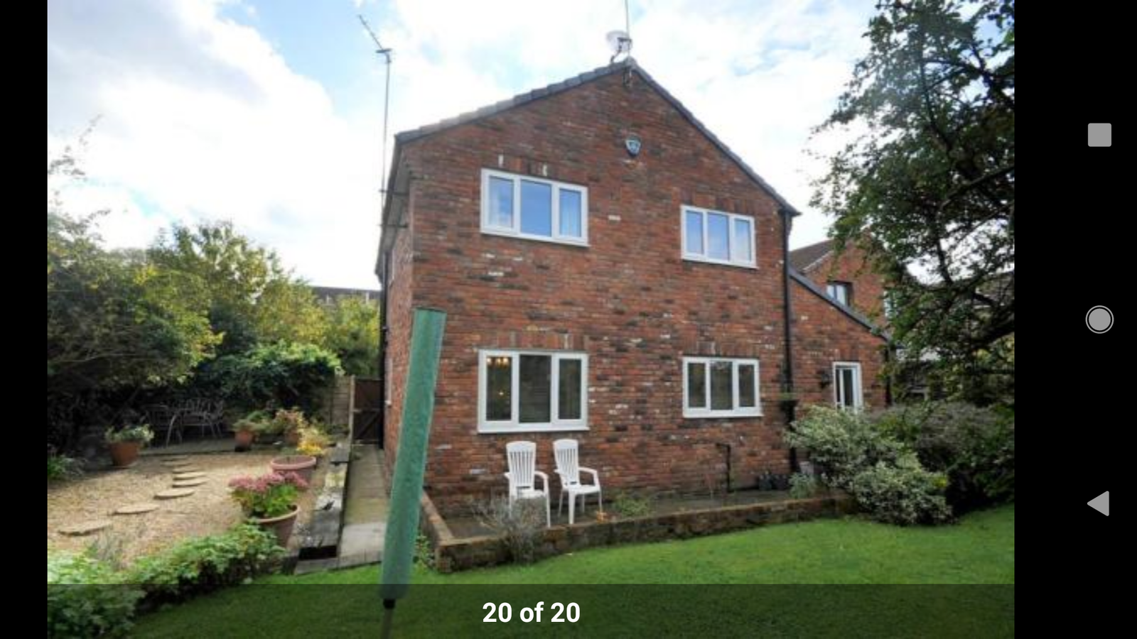

Here is the full front and back of the house too (taken from the Rightmove ad when we bought it). Thanks.
Research constructing ladder sections to extend the verges and create a soffit and barge.
This would clear any rainwater run off from the cills and face of the building. Would look better to imo.
Once extended you can fit the dry verge system again with no issues.
