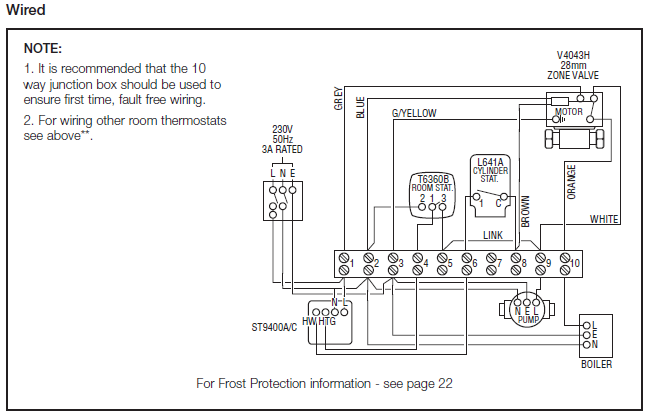

The old back boiler could be gravity HW, pumped CH, and as you say if given a live feed it would fire until the control-stat reached with no problem, because plenty of water and metal in the boiler. The early systems (sometimes called "traditional" in the literature) had no valves, boiler powered for HW, boiler + pump powered for CH + HW. CH only not possible. Inefficient because if HW left calling, the boiler goes On/Off on control-stat indefinitely, and in the ideal place to lose heat up the flue when off. There aren't many of those left.
Honeywell C-plan was an improvement, attached. If the zone valve is closed (cylinder stat satisfied) and CH called with all the rad valves closed, whether the boiler would have a problem I don't know, probably depends on the particular boiler. But I doubt there are many C-plans about now.
