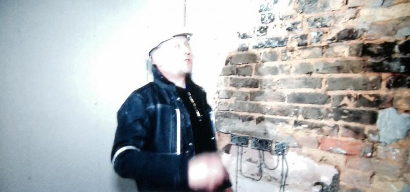

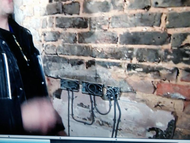

Safe zones on DIYSOS
Very odd way to run from one box to another.
Why didn't he just go 'as the crow flies' so to speak?

Attaching the boxes together with conduit couplers and bushes would have made it both compliant, and all in a straight line instead of on the ****!
