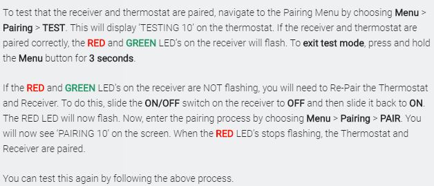

We have just moved into an oil powered property using the Salus device. The thermostat was absent on moving in so I ordered a new one.
The new thermostat is now paired and responds to the boiler no problem but is not transmitting anything to the radiators.
On opening up the reciever the link wire is connected between Com & L. Blue/Neutral is in N. Brown/Live is L and Black is connected to No.
Anyone have any ideas????
That is as I would expect at the Salus Receiver, in that there are wires in the right places, but it will of course depend on them being in the right places at the other end.
The new thermostat is now paired and responds to the boiler...but is not transmitting anything to the radiators
I don't understand that description. The thermostat is paired with the receiver and switches it 'on' and 'off' according to the room temperature. The receiver in return is wired to whatever it is controlling which may be a motorised valve or the boiler, depending upon the type of heating system you have. The thermostat does not respond to the boiler or transmit anything to the radiators. It communicates solely with the receiver.
What happens when you select the receiver to 'manual'? If it works then the wiring is correct. If it doesn't then there is a fault somewhere.
If it works when in manual, but not in auto, have you checked the pairing of the thermostat and receiver?
