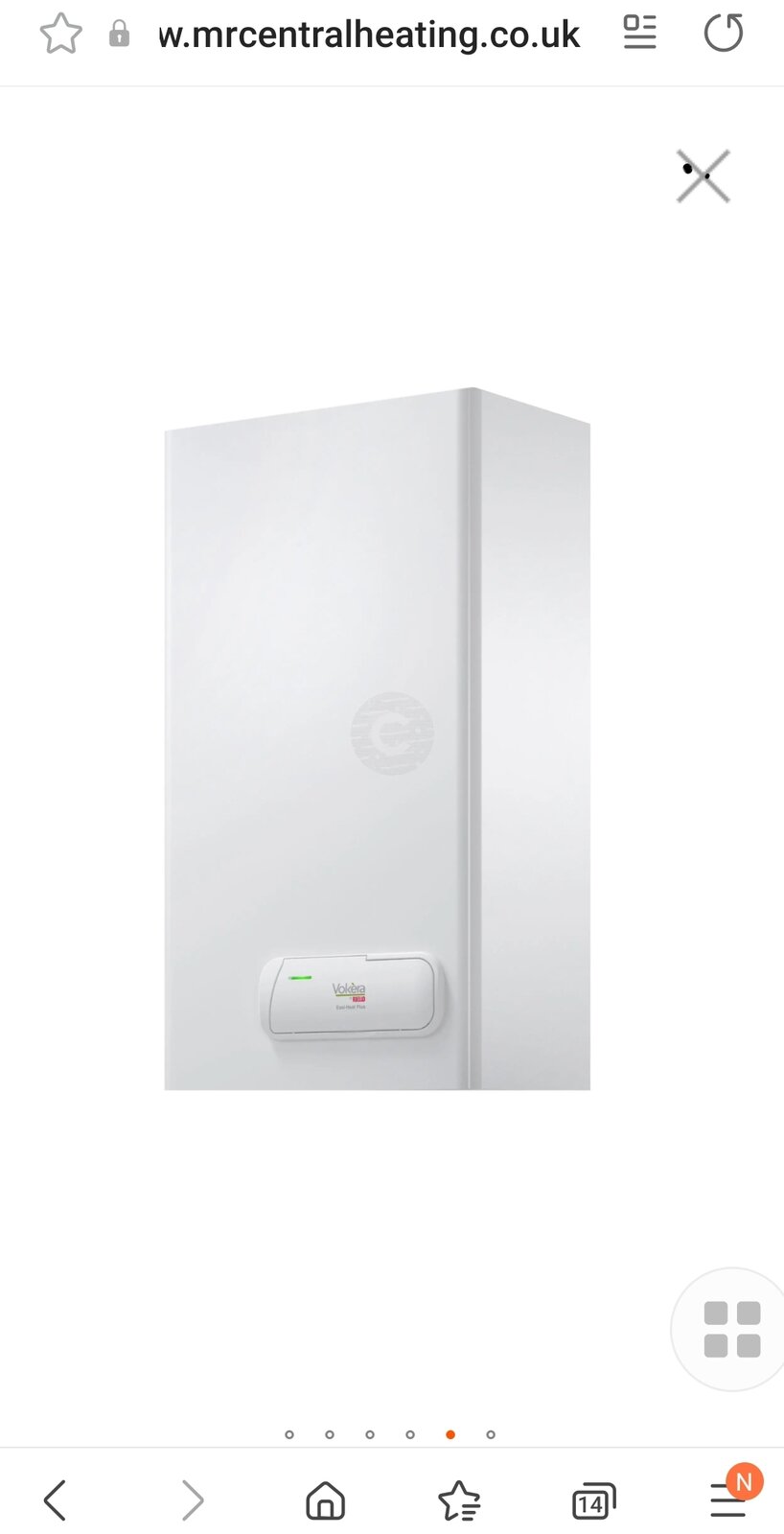

The boiler has a small mechanical timer at the bottom right hand corner, this MUST be set to constantly on or it will over ride the Salus
This model does not have any mechanical
timer on the bottom right hand corner
Thanks for your reply
If you intend using it a basically a timed on/off switch you will need to have back set temperatures low enough never to switch on when you want heating off.
