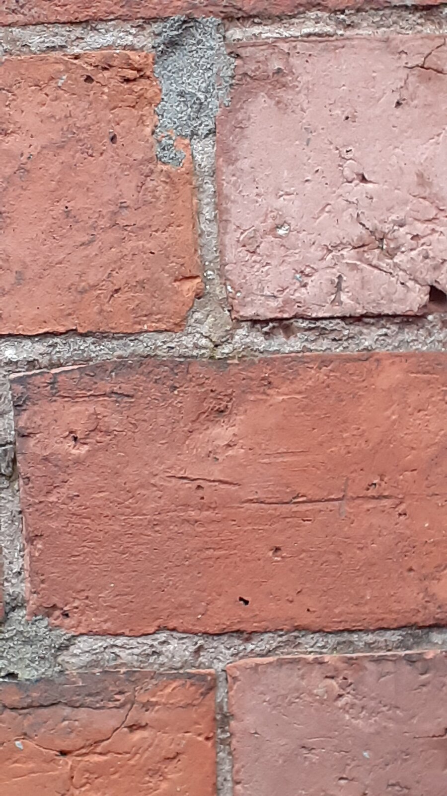

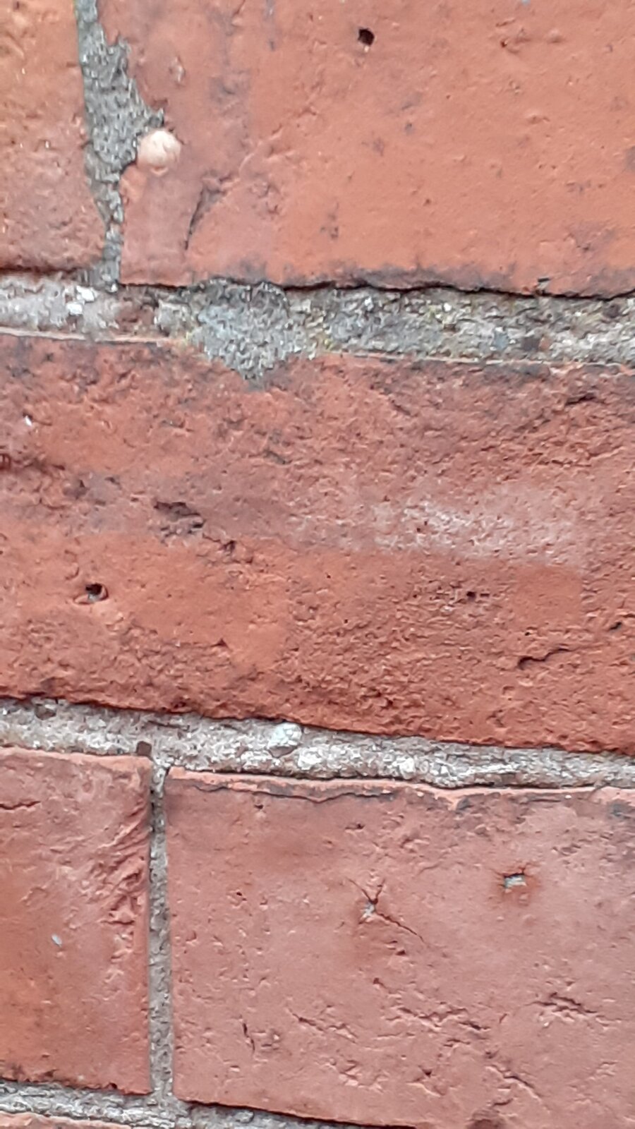

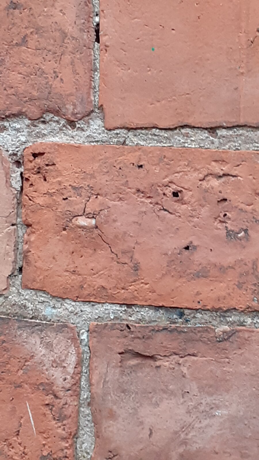

Hello,
I'm a complete novice about this but I'd like to do some bits of repointing on the wall of my terrace.
I can remember (many years ago) a builder mixed sand, cement & lime for pointing another wall but I can't emember the ratio or how to mix it.
I also have no idea what type of sand (I keep hearing builders sand, soft sand, sharp sand, play sand and I'm confused).
If anyone can give me any advice I'd me really grateful.
I'm in the UK and would like to know exactly the type of sand, type of lime and type of cement if possible and the ratios.
I've attached some pics of the wall. You'll see it looks like someone previously has used a sand/cement mix for bits of pointing.

NHL 3.5 hydraulic lime mixed 1:3 with sand.
The sand is the tricky bit as you want to try and match the existing as close as possible and you won't get that off the shelf. In the 1880s they didn't carry sand half way around the country - they would have used whatever was closest to the job and that would often have been fairly rough and gritty. Search out local sand suppliers and see what they've got? Depending on the area you are pointing, you could try mixing different sands and grits together? My advice is try small areas and let it set. When you get a mix you like, roll it out.

It does look rough & gritty - I was presuming that was lime.
I'm not even sure what sort of sand or lime or cement to look far. Is it sharp sand / builders sand?
Are there different types of lime or cement?
It's not a massive area to repoint - Just the odd patch up really.
