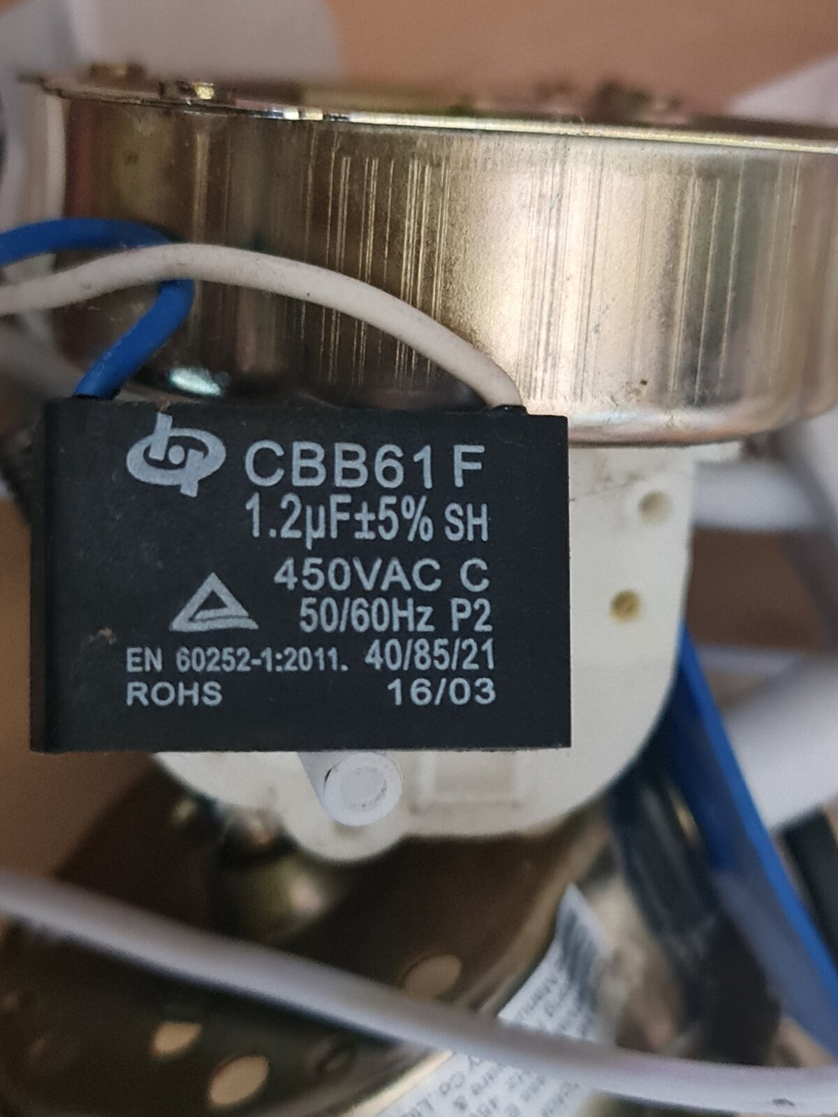

Additionally, I have a floor standing fan that recently stopped working. Unlike the sander it is an induction motor. The following is a photo of the capacitor.
I have seen a number of them that say CBB61, what does the F mean? The one in the photo has a right angle bracket to screw it down, but many of the of the CBB61 capacitors seem to have that bracket even they don't have a F at the end.
I can get a cheap one from China for £2.75 inc postage. Is there any reason why the one in my link would not be suitable?
It might be a variation of the manufacturers reference rather than a technically different product, maybe worth getting one in if you prepared to wait a few weeks or longer.

Motor capacitors are a common failure item.
Buy a new one for a few quid. Fairly likely the motor will work again. If not, you are down the cost of a cheap capacitor.
New one needs to be the same type, same capacitance, and have a voltage equal or higher than the original.
Minor variations in the code on it are generally irrelevant.
