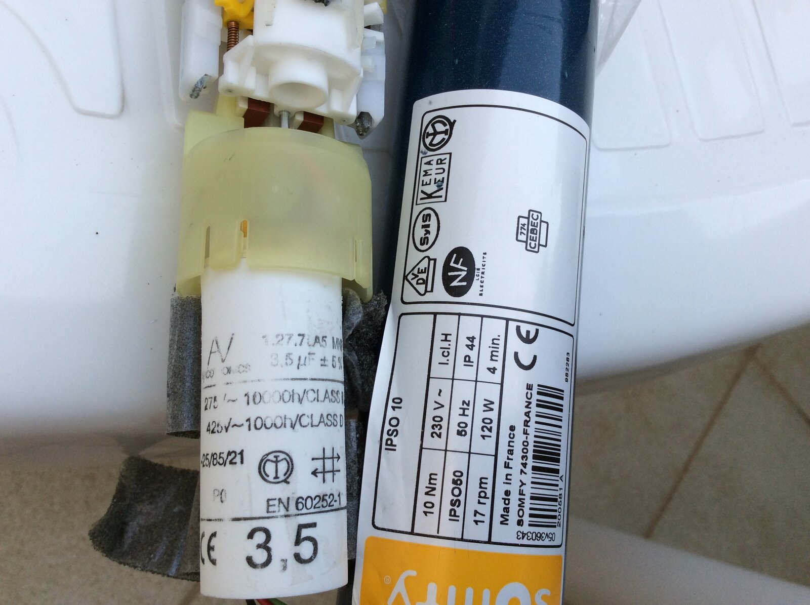

Can you open the old motor and photo the Capacitor.
Would be good if you can photograph any markings and numbers - so can recommend a new cap.
And how it is attached to motor so can suggest how to replace.

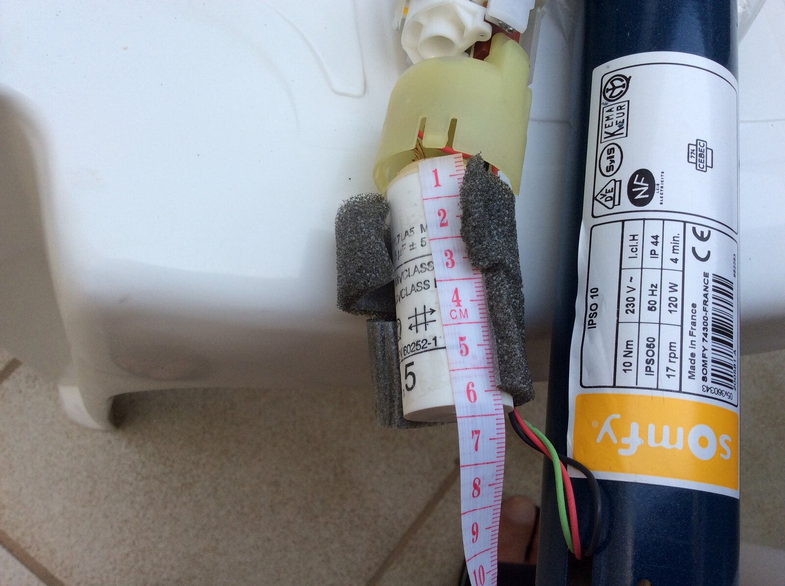

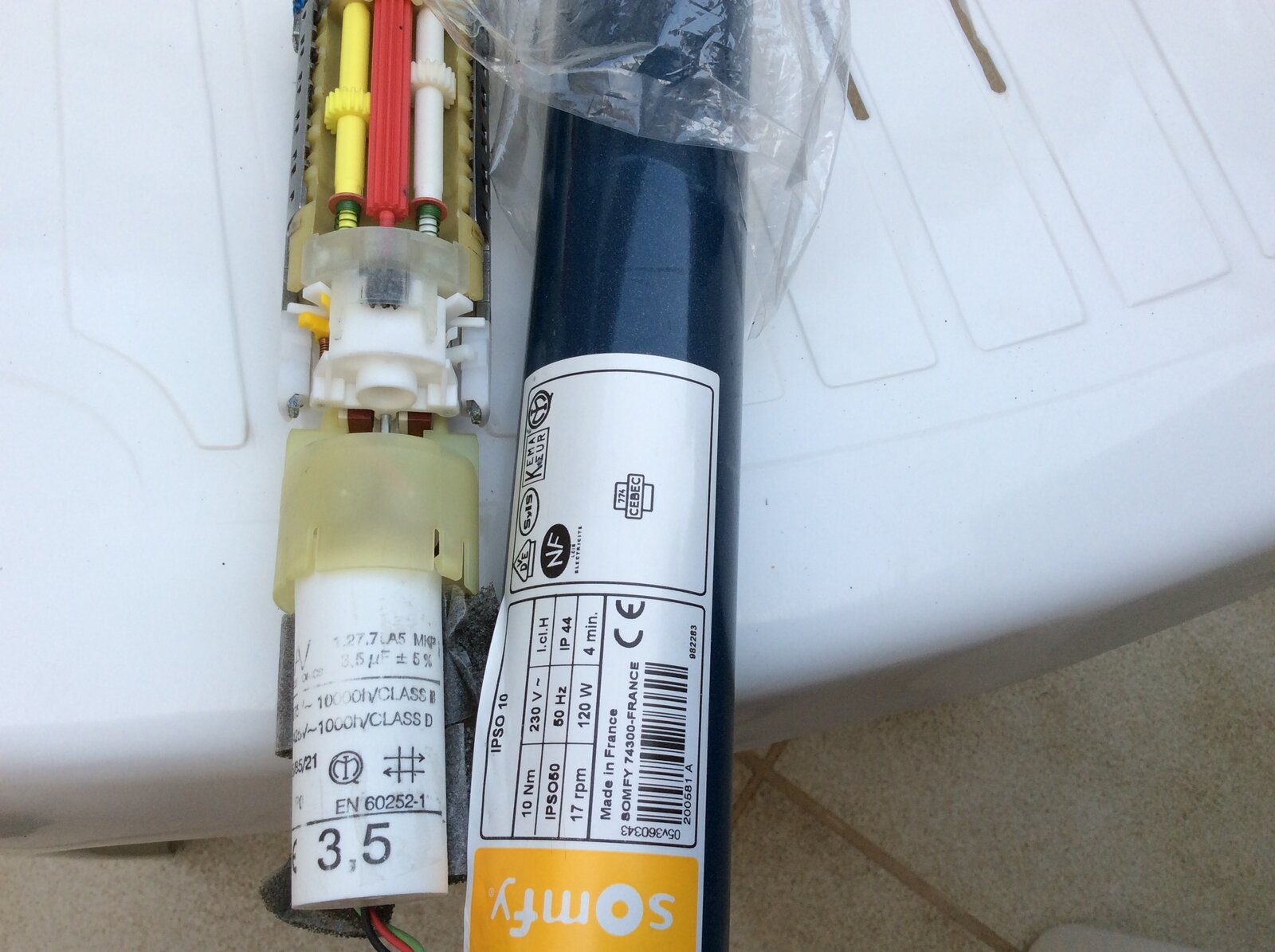

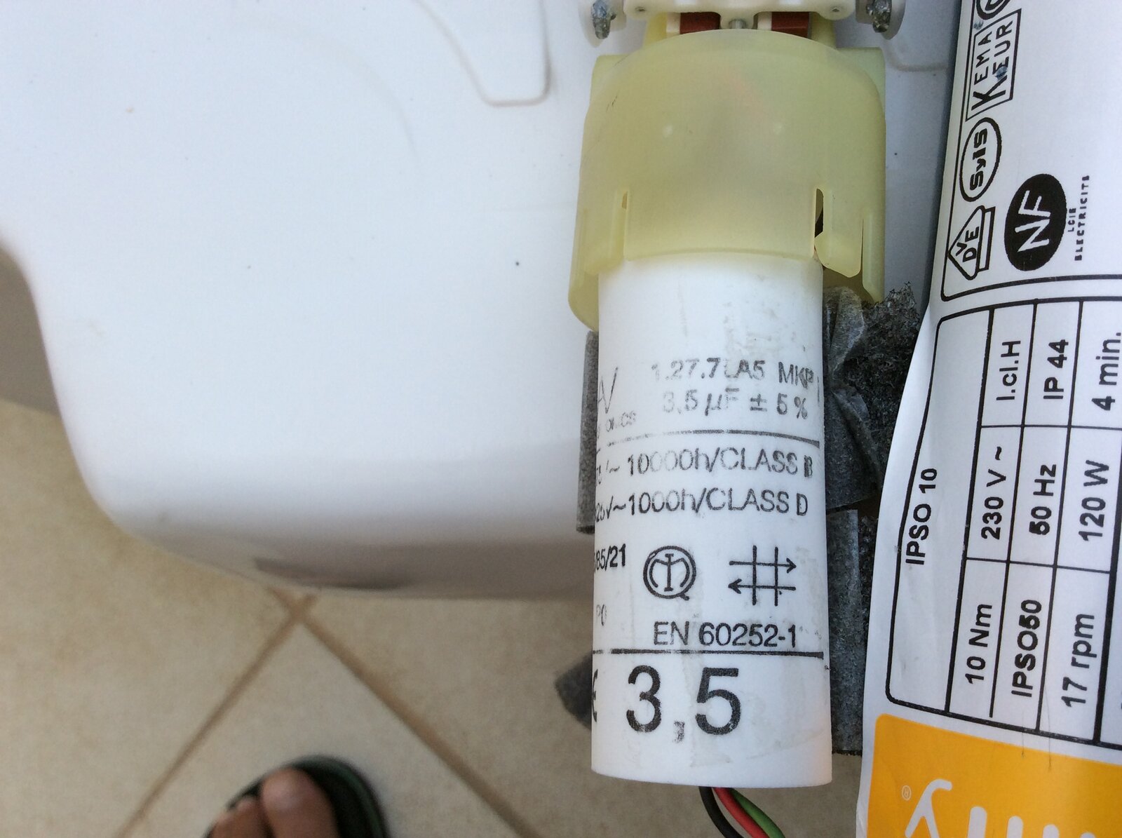

C5E04D3A-D245-4787-9EBC-B012F0A2110F.jpeg 60ED49B9-029A-483F-B141-BE45CDC44A24.jpeg 3399B7FC-AFC7-49CC-985B-8E1512DEA0BF.jpeg E5F02B01-5D50-4F35-B6E7-D15C0DA90AD4.jpeg
This is the capacitor, I hope the pictures are clear enough to identify it.

Looks good. To confirm I see that as a 3.5uF Capacitor rated at 450V (actually says 425V).
And as you say about £5
https://www.ebay.co.uk/sch/i.html?_...H_TitleDesc=0&_osacat=0&_odkw=3.5uF+capacitor
With these capacitors it does not matter which terminal you put the live and neutral.
If there is a lack of space you may have to buy a flat ended version of cut off the bolt with a hack saw.
Can you see how it is connected - spade terminals or flying wires?

It's got spades so it should be a piece of cake.
I'll order three of them so that I can repair two motors and keep one for a spare. It's not as if they cost a bomb.
