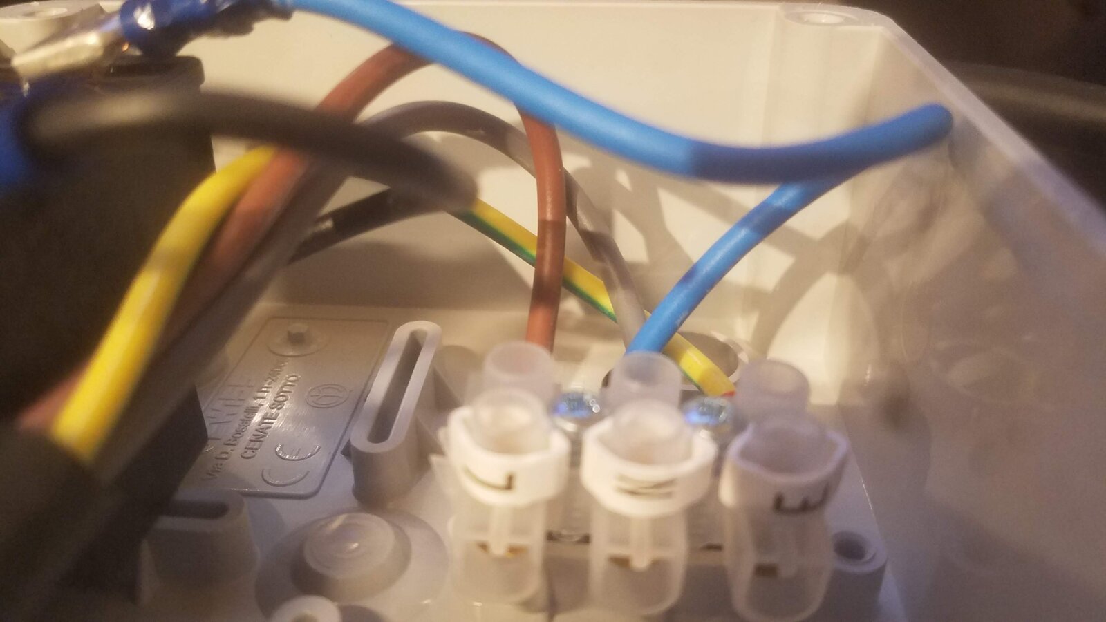

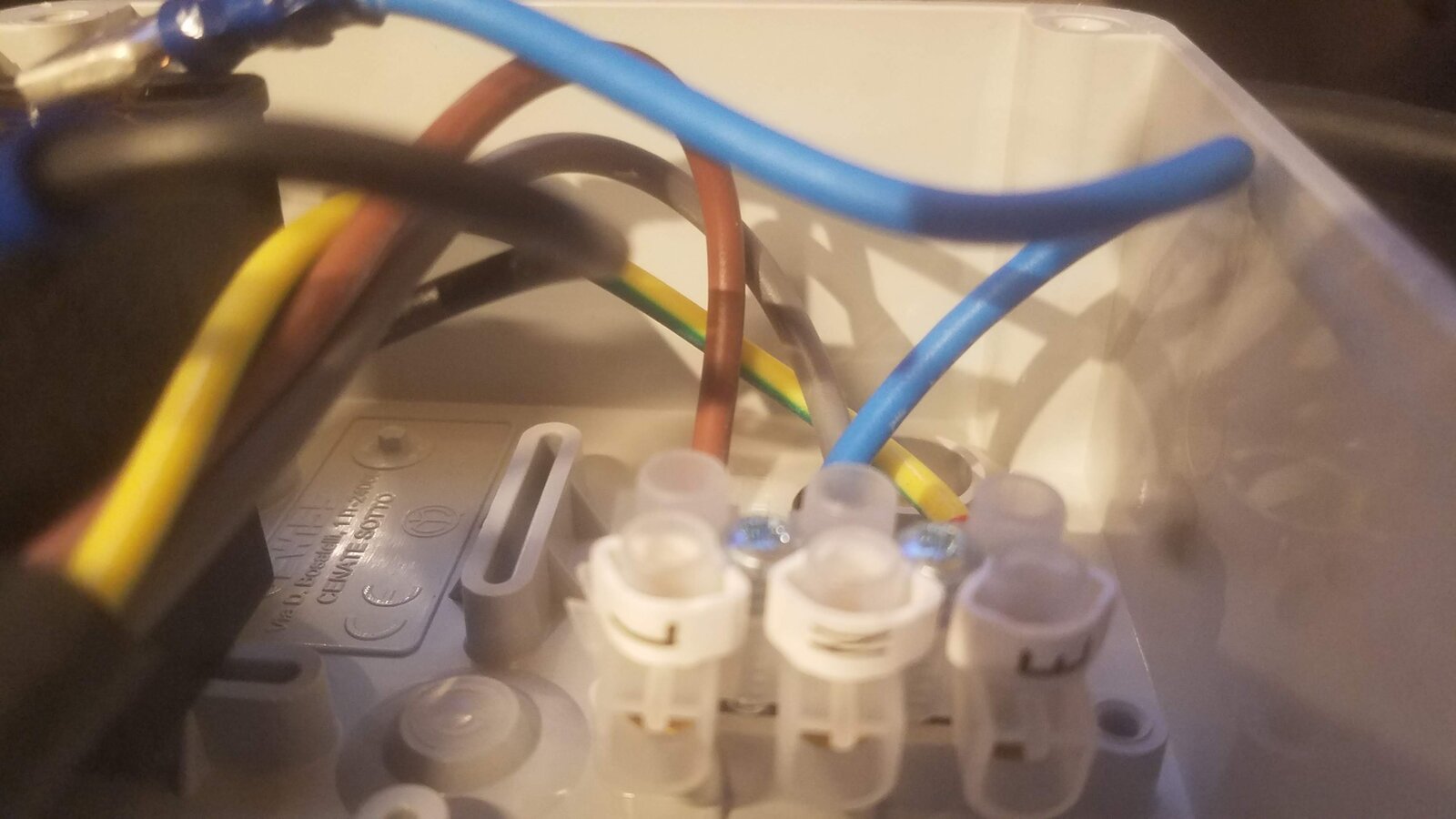

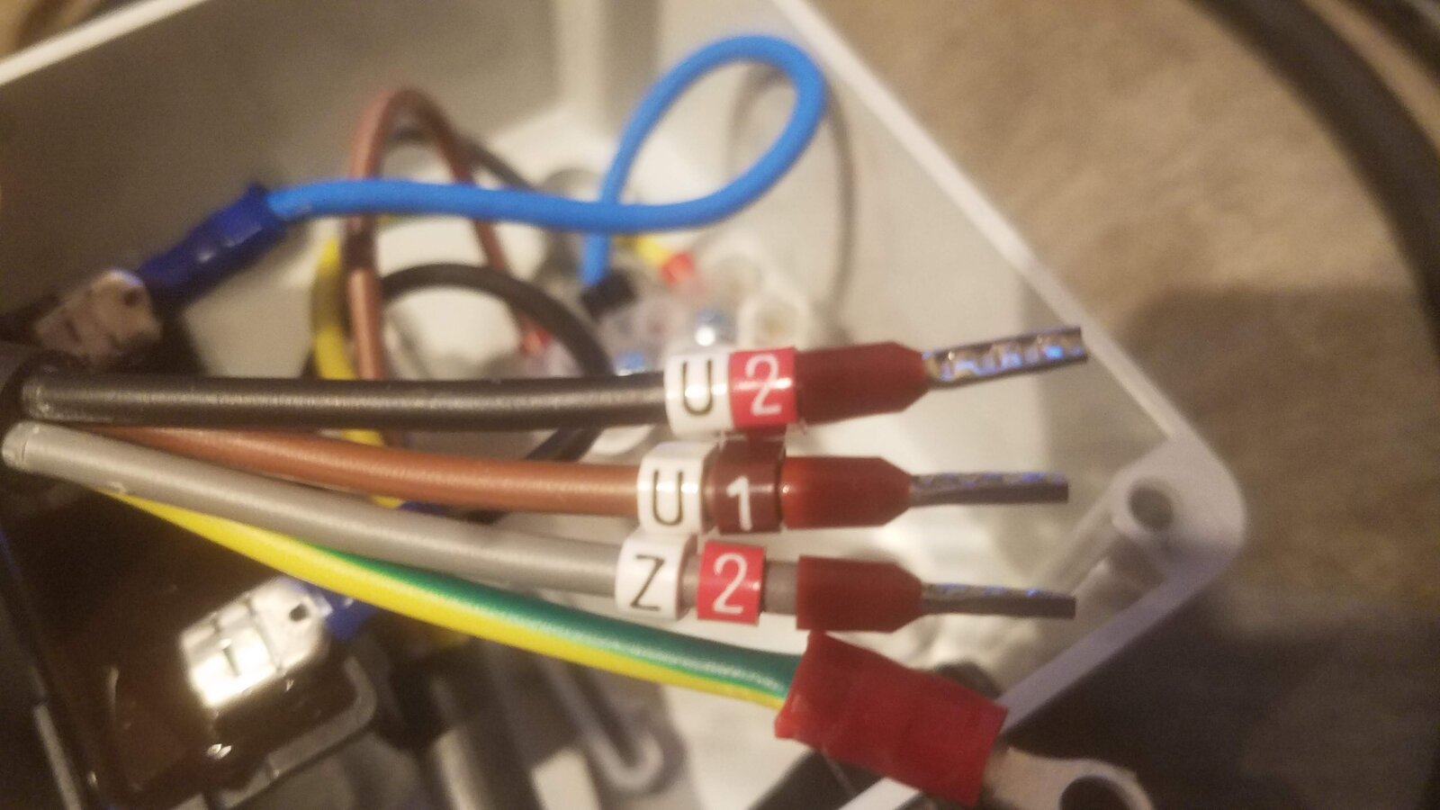

Just an update on this. I managed to get it working although it will need new bearings. the capacitor box I bought from direct drainage had all the wires labelled for connection into the panasonic motor. So luckily I just wired them up and it started working. I didnt wire anything into the 2 'P' connectors. hopefully this is ok. Here are a couple of pics. Has anyone installed new bearings on these things? The half bearing looks changeable but the full bearing on motor side looks tricky.

It just protects the motor from overheat, wouldn't worry about it too much. Take it you mean the bearings on the actual biodisc? Pics would be helpful.
I wouldn't run it too long with knackered bearings or youll shag your new motor
Yes the nylon bearings each end of the biodisc shaft. It seems pretty loose and I had to jack the bearing up a bit or the motor belt was literally taking all the weight of the biodisc. it seems to turn ok but dont want it like that for long. I might need a new belt too I dont remember the old motor set up taking all the weight of the disc. somethings defo not right.
