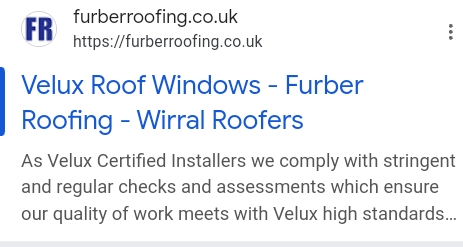

Sandtoft 20/20 tiles around Velux Windows 15 Degrees
That would be a definite fail on the Velux installation training course.
I sourced that example from a 'Velux Approved Installer' website. I'll find the image for you.

Not strictly correct ..
Care to elaborate? The example given was approved by Velux. We can only guess regarding the elements we can't see, but it looks like a decent install to me.
The only thing I can see is the header tiles are a wee bit close to the unit.
When installed correctly, there should be approximately 250-280mm of tile showing under the bottom apron.
Definitely not 50-60mm
But if tiles are 330mm and if min head lap is 75mm them max length of tile showing without one above it showing through is 255 or at max head lap of 120mm max length is 210mm or have I misunderstood what you are stating
